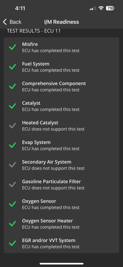

You guys got me curious so hooked up the OBD reader. Looks like my ‘22 5.3 is like @ninjaplumber, readiness monitors are set. Was assuming I’d have to pull it for NY inspection based on other posts, but looks like I’ll be ok.IMG_7785.pngIMG_7787.png
