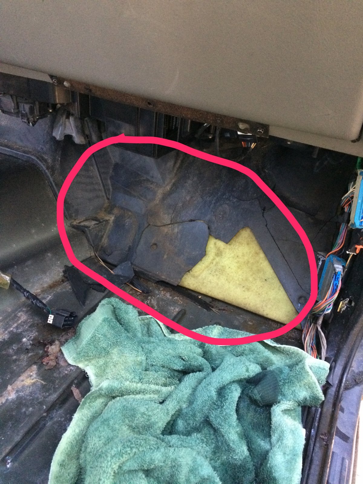

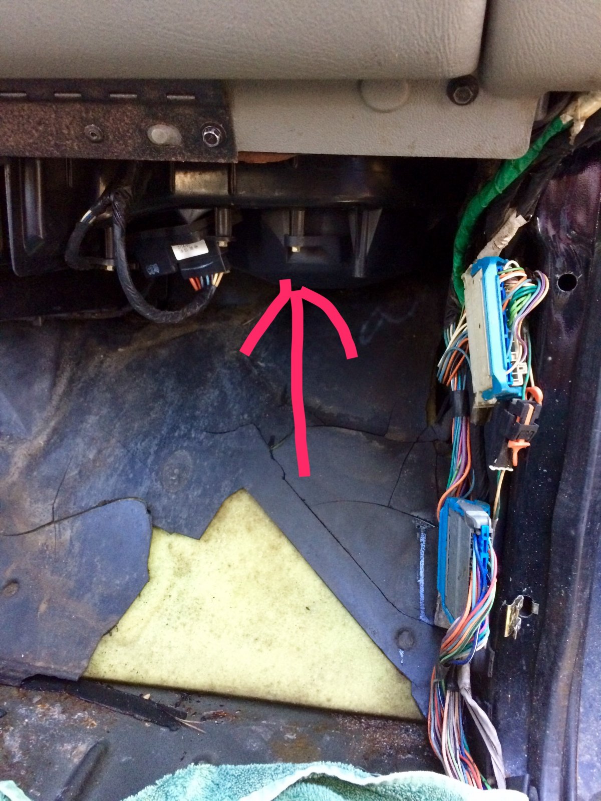

I've unclogged my sunroof drains. I've greased the seal. Now I've taped up the sunroof with flex seal. I've stripped out the carpet and carpet pad to treat for mold. Now we just had a strong rain and I've got a puddle on the passenger side.
The tape on the sunroof is good. The leak appears to be coming from under the dash, right behind the circular part that has the red arrow going to it. Where could this leak be coming from? Is it likely the windshield? I can't think of anywhere else to check.
Also does anyone know of any danger to removing the rubber and foam that is circled in red? The black plastic basically breaks apart with any contact due to age. Can I just remove it all? What purpose does the foam and black plastic serve? What is it called if I wanted to order new?
If I don't figure this out soon I think my wife will be ready to get rid of it.

Have you checked/cleaned the condensate drain line for your A/C? That can plug up and cause water to come into the passenger compartment.
10,348
15,003
Like wjburken suggested, make sure that a clogged or disconnected A/C condensate drain hose is not the source of the leak. You did not mention if you ran the truck and the A/C somewhere, prior to the rain storm.

The rubber and foam is noise deadening and heat insulation and can be replaced. Lots of parts stores have it or you can order at Rock Auto or Amazon.
Maybe this is it: https://www.rockauto.com/en/moreinfo.php?pk=5996769&cc=1380372&jsn=2259
Actually that padding is likely more like this: https://www.amazon.com/Car-Insulati...icle+floor+heat+padding&qid=1582314663&sr=8-2

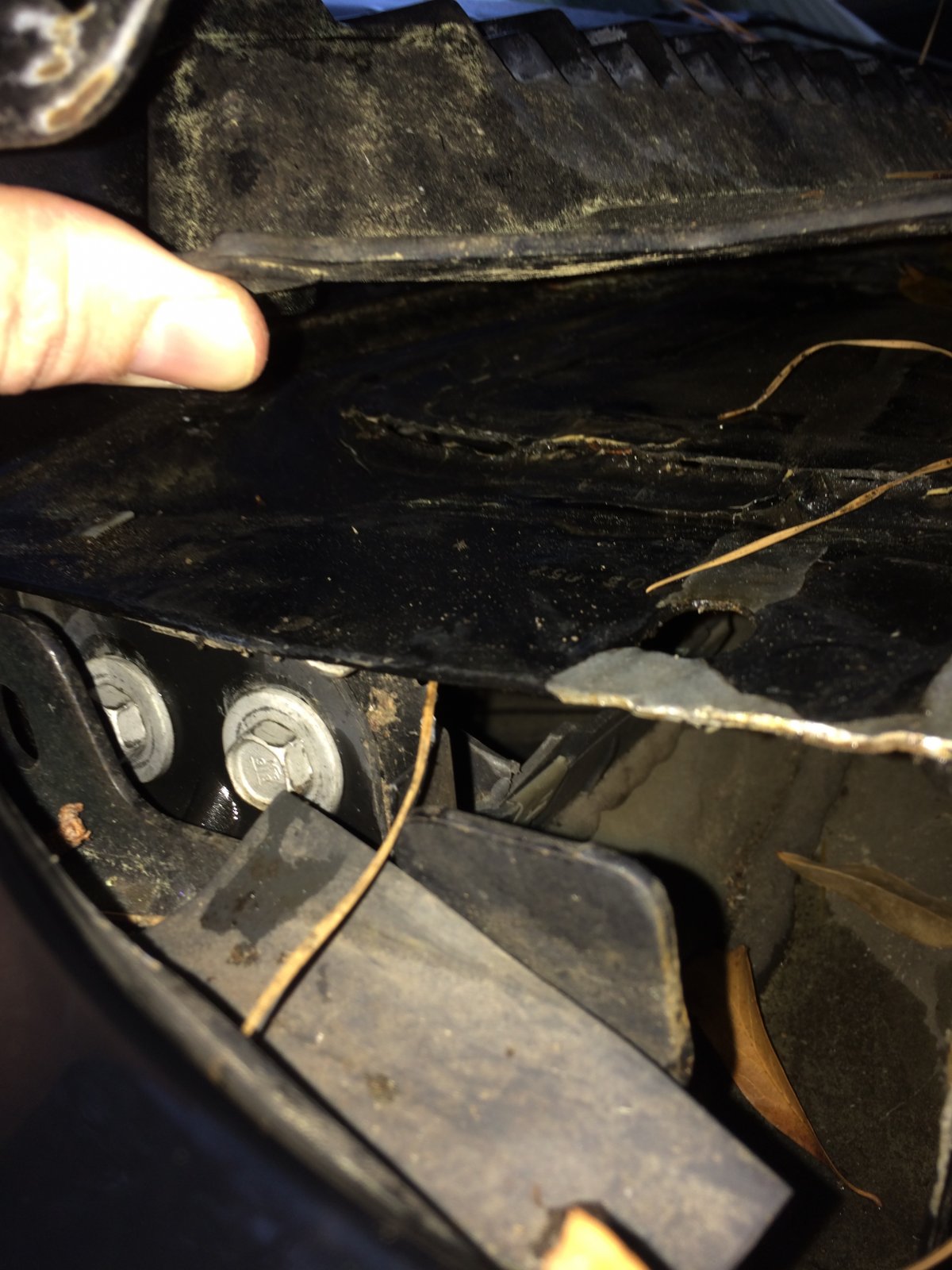

Found the problem (see pic).
Fairly obvious right under the cowl. Tested with a hose on the windshield and the water catches the back part of the crack. Sealed up with some flex seal tape for now. Will probably have my brother weld it back if possible, though he doesn't work with autos. Should be straightforward to weld?
I would have had no idea to look under that cowling unless other members had not suggested it here. Even being old as I am, I learn all the time here.
If it's too tricky to weld, and you can't see it anyways, I'd bet a good cleaning and a nice bead of silicone would do the trick.

The repairs I have seen in the you tube videos involved the sealant, no welding that I saw.
