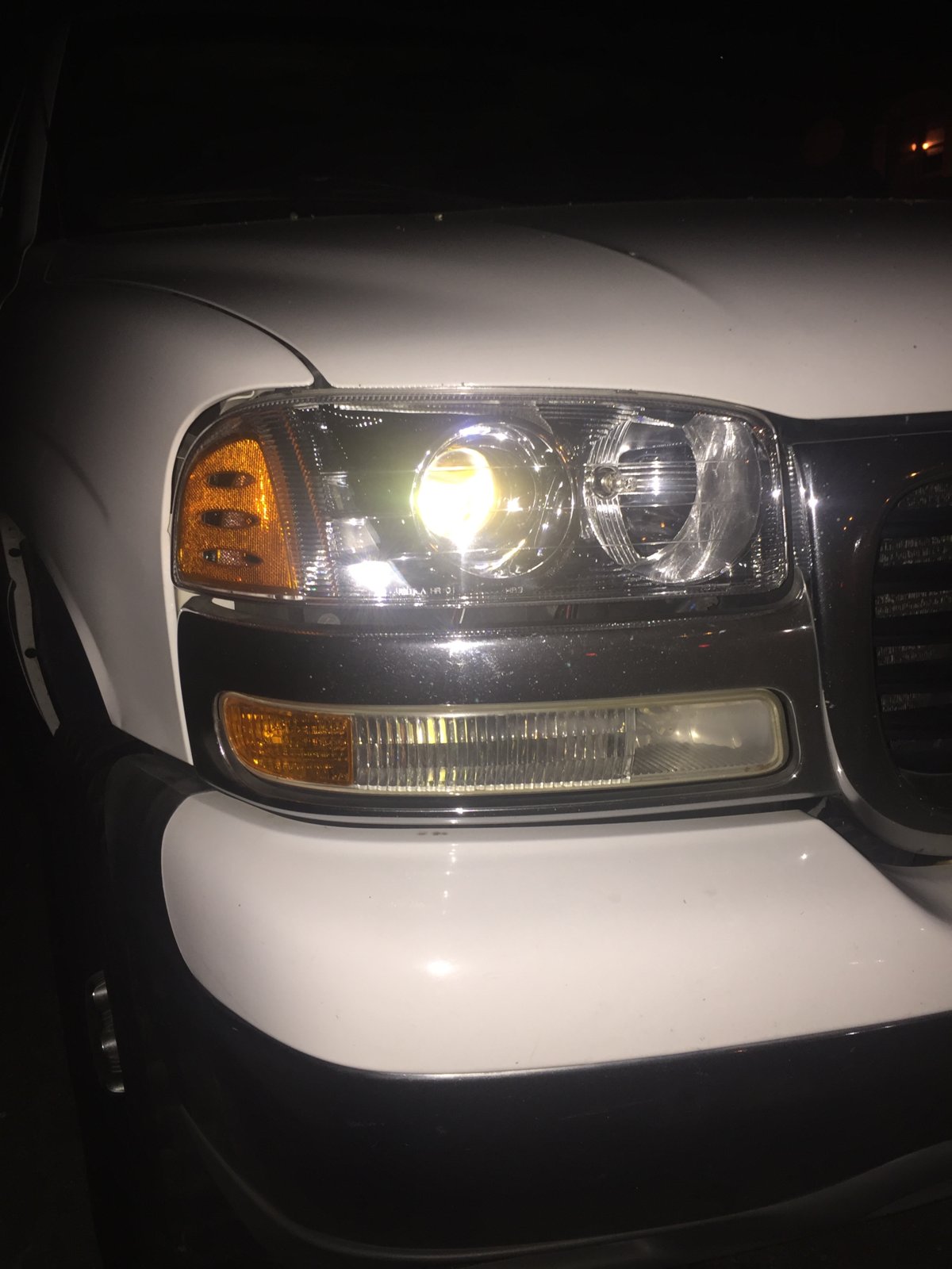

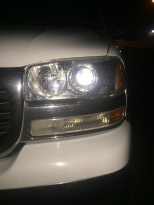

Sup guys i have the denali headlights on my yukon and am getting tired of looking at the huge gap it has underneath. Is this normal when swapping to this headlights? Is there a way to fix this as is causing my high beam to shoot into the air and i cant adjust them or the side to side. Can anyone chime in on this

Sorry about that here they are

I can fit a finger under there is like there hanging up

You can't adjust these headlights side to side. There is only up and down adjustments available.
Mind fit something like yours, and I'm able to adjust them up and down so they are aimed properly.
You aim the low beams first, and then the high beams will be aimed correctly. If the high beams are aimed wrong, you might have a bad fit for the bulbs to the retainer ring.
Some of the aftermarket bulb retainer rings are made to allow other bulbs than what the OEM were ment to take, and this can cause problems with some bulbs alignment in the assembly.

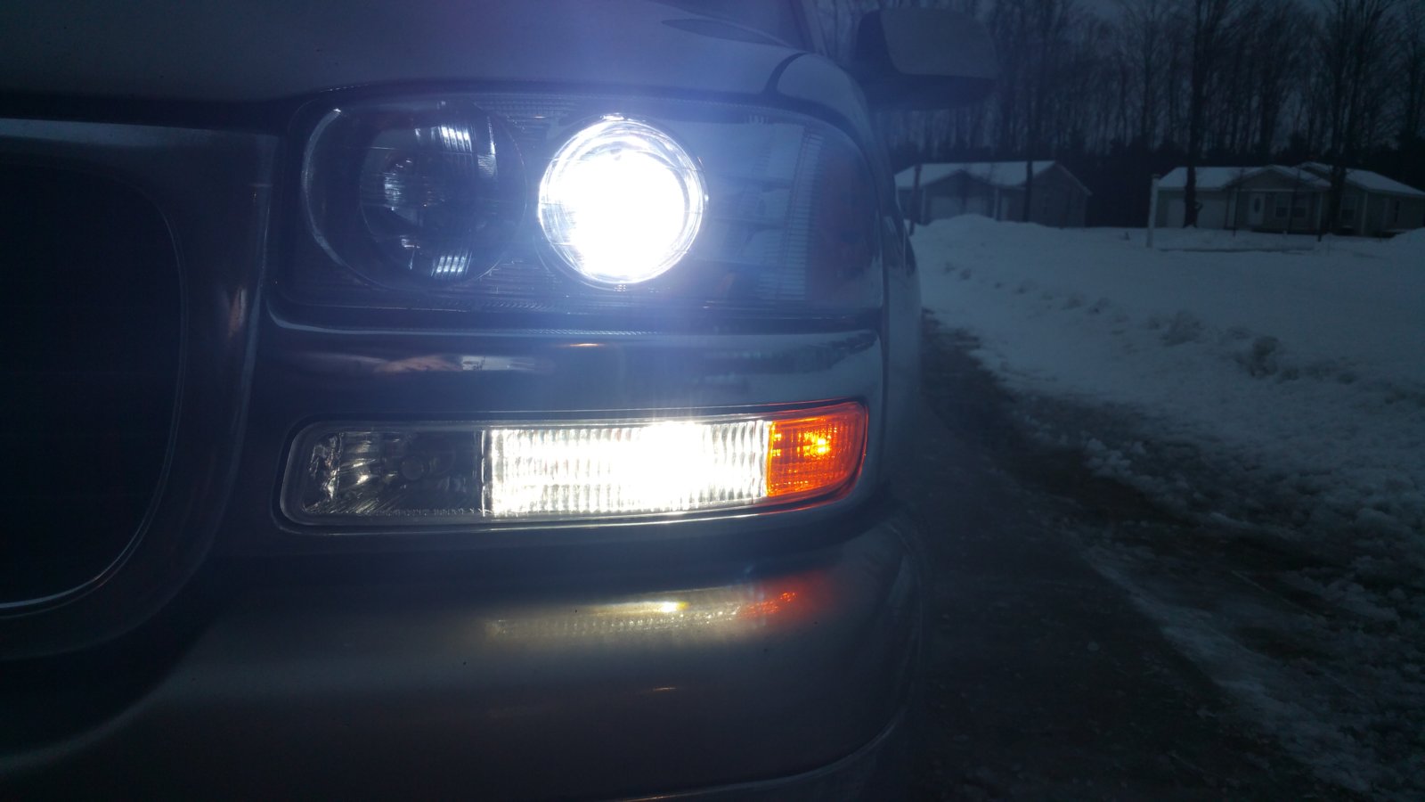

Here is a better daylight picture. My low beam are aimed good and the high beam hit the tree line on top is crazy and then this gap has me going nuts i feel its a bit to much like the hole headlight is aiming up

That's how mine are, no biggie, just aim them correctly and you're done. I have a Morimoto 7.0 retrofit in mine as well and have a perfect cutoff

Mine have that big of a gap too. There are adjusters on them but sometimes the ball-and-socket pops out. Double check that they're solid.

check that the pins are in correctly i have had that problem too and the pins were not in properly at the bottom

Thanks guys i will double check the pins and the ball socket to see if changes things i want to put led on mu high but being that the aim is off to the sky wont do any justice

Oh yeah, you're talking the mounting pins right? I forgot sometimes you just get them in the top holes and the bottom holes aren't lined up.

yes you have to line them up in both holes do the inner ones first then the outer ones

I made sure the pins were on correctly and set everything up. High beams still shooting to the sky. I don't change back to the regular headlight cause i don't want to blind anyone with the hid anymore. Also brtween the headlight and retrofit i wont get what i spent on them
