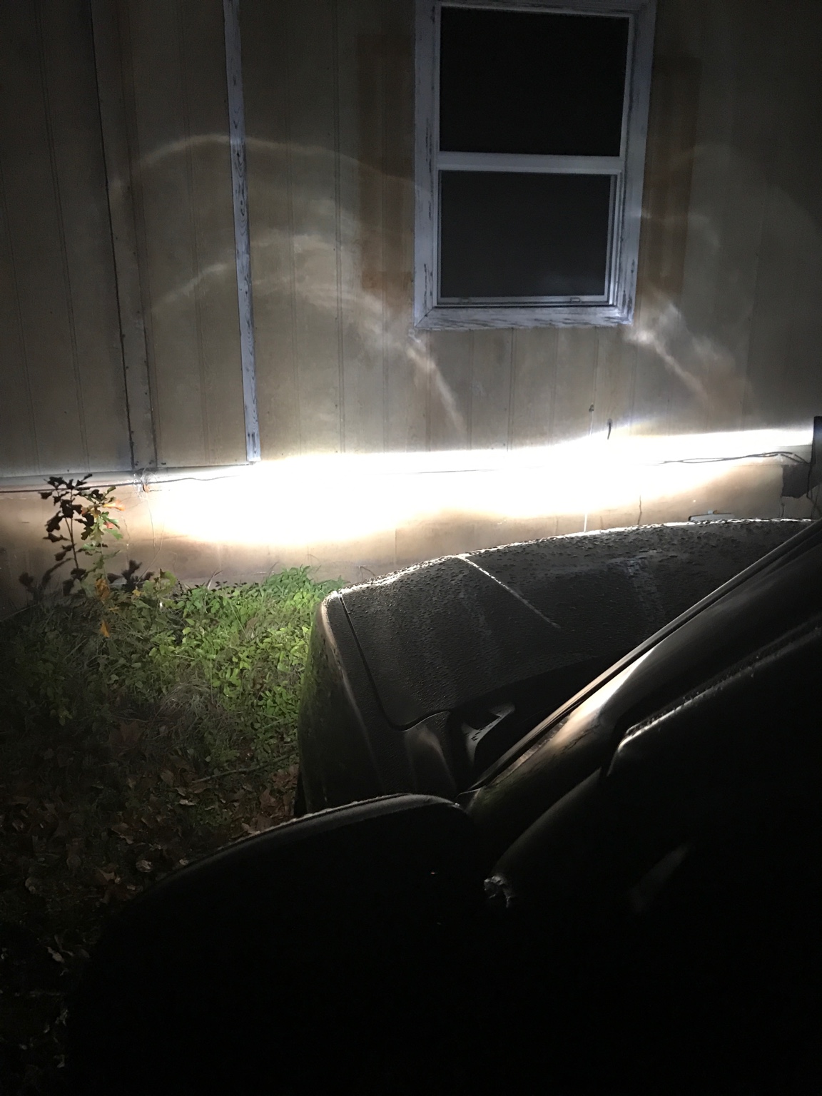

They are OEM housings and i have tried swapping highs and low lamps...both sets are bright in high beam configuration and both sets are dismal in the low beam configuration...thats why i am baffled on this. When i had them out the looked clean.

Did you disassemble the actual projectors? The backs are like tiny mirrors and if they're dirty they won't work well. The reflectors ( high beams) aren't as critical.

well i took them back out and disassembled...i found the "chrome" reflector material in the cylinder is bubbled and flaking off and laying inside the chamber. So i am assuming that it cant reflect off the black plastic and it cant reflect thru the flakes laying in there. So next move is to order new light assembles like Debo's or???? Does anyone make new OEM parts for the projector part?

Mine set of depo replicate the oem headlights pretty good I got mines from a co worker that bought them from eBay his wife got tboned and totaled the truck. Check eBay or amazon. Just curious do you have any pictures of the reflector

No pictures...figured that was the problem so just put back together and reinstalled....so i guess the next thing it to order a set of black ones and replace Thanks

There aren't any with black chrome reflectors that I've seen, the reflectors themselves are always chrome but the area around any reflective area can be black. It still makes them look mainly black. But yes, the smoked lenses will cause decreased output. I have them in mine and needed 55w HID to get good output! Also, as you may have found out, to answer your question, there are no replacement parts available for the housings only new housings. You can still get OEM ones also if desired- $110 each at Rock Auto.
