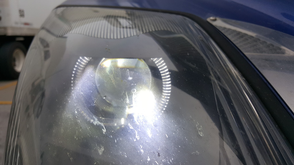

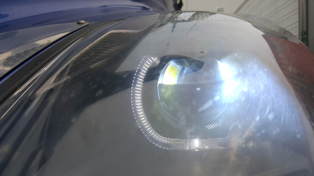

Update on TRS Morimoto 2stroke Led kit. And this was on my semi truck on low beams and they are H11s. After 6 months and about 90k miles and around 1200 hrs, Leds started to fail, one side on both. But this was on semi and using them 8 hrs a day and all damn patholes around USA and wires started to break right behind Led housing. So in car they will last lifetime since I or anyone use lights as much j used on my semi. And on my Hi beam set up it will last 10 lifetimes. TRS have nice warranty, you can send them pics of destroyed Led and they will send you replacement same day or you can setup and pay for new led anf once you destroy yours, they will refund you money same day. Make sure you use good hammer because housing on these 2strome Leds are tough and cut wires so they see its not usable no more
Here is some pics how looks like when one of two led doesnt work in projector housing and pics of destroyed Leds and driver ready replacenent

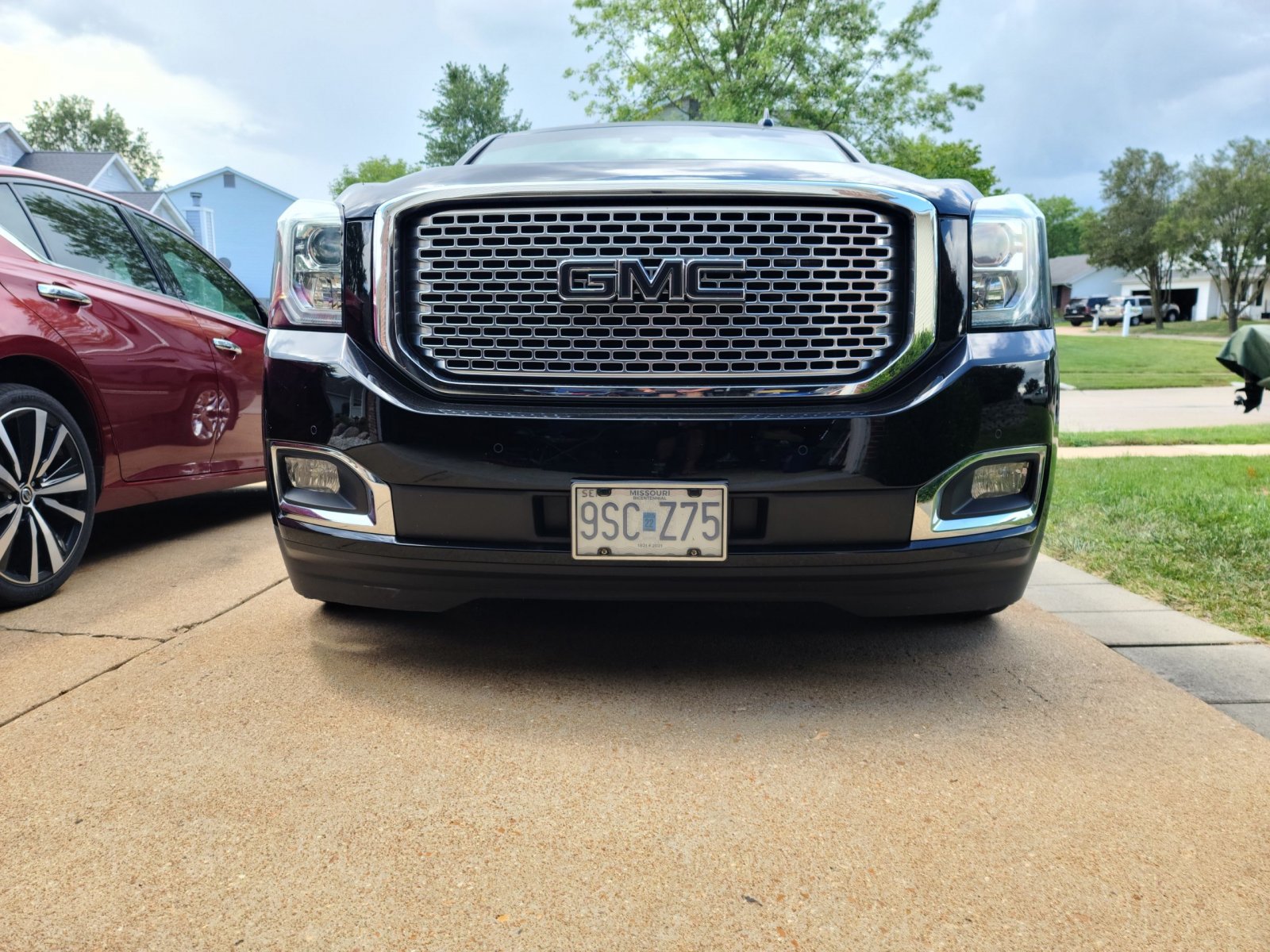

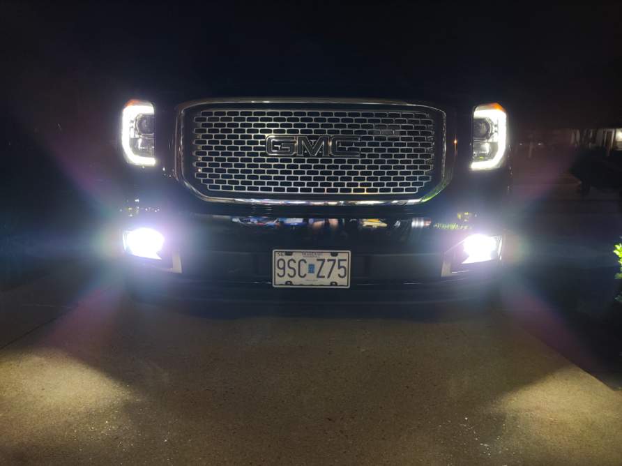

Swapped Xenon Depot PSW26W 6000k for Morimoto XB sealed LED foglights and 5202 to PSW26W adapter harness. Yes Xenon Depot were brighter but Morimoto looks nice with black housing and its just foglight , not low beam
Before and after
Xenon Depot
Morimoto XB
