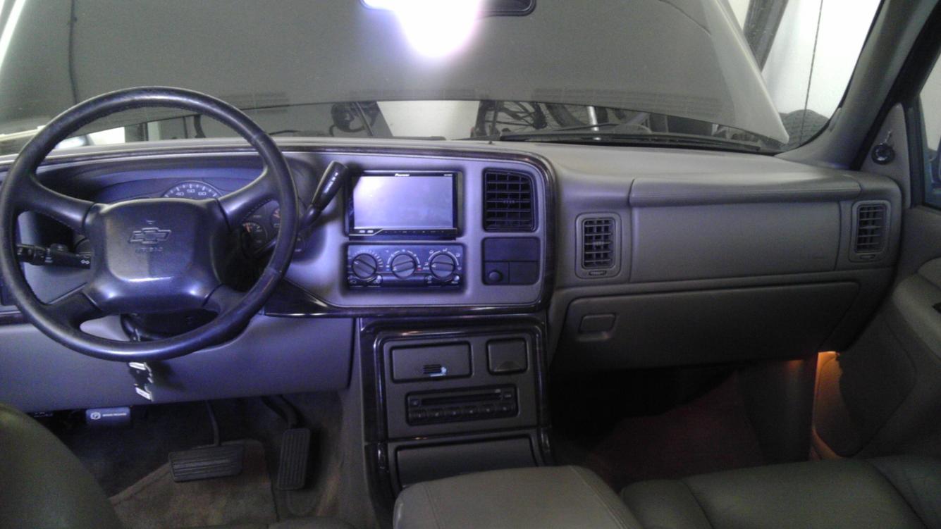

did you do your console yet? i was reading the post u can also put the 03 to 06 one in there too i have a 01 tahoe i converted my console to 03 denali pretty easy let me know if you need help
