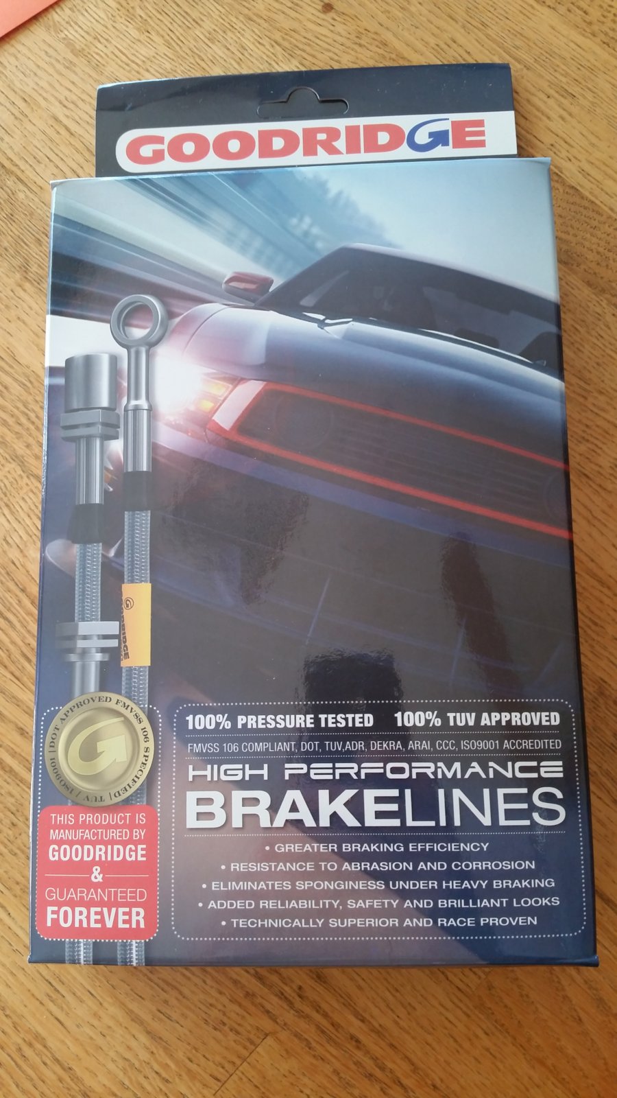

Is the goodridge kit DOT approved?
Looks like.
