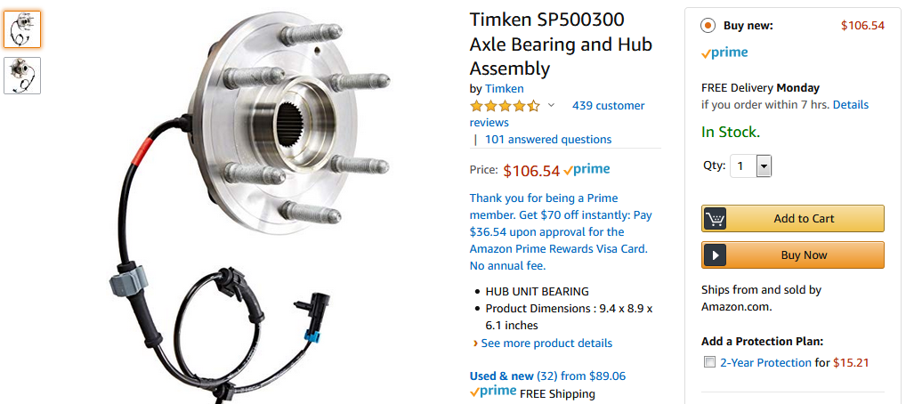

If that is USD and you haven't bought it yet, Amazon has it for $106.54 and free shipping for Prime members. That is where I bought mine.

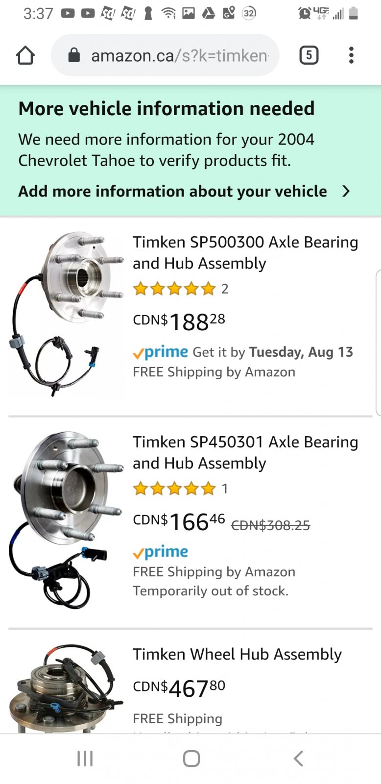

Different for Canada I'd imagine
Edit yup

It's mostly the $ exchange rate. The US dollar is valued at about 1.3 times the Canadian dollar, so our friends up north are going to pay 30% more of their dollars. There is also probably an increase in shipping costs.
