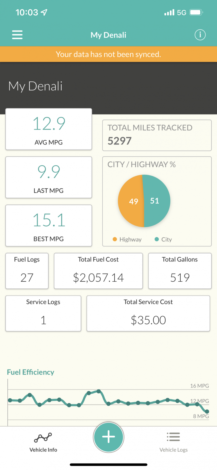

No tune. Stock everything except rims and tires. Brakes are good. I’ll plug it into a scan and get that data.
