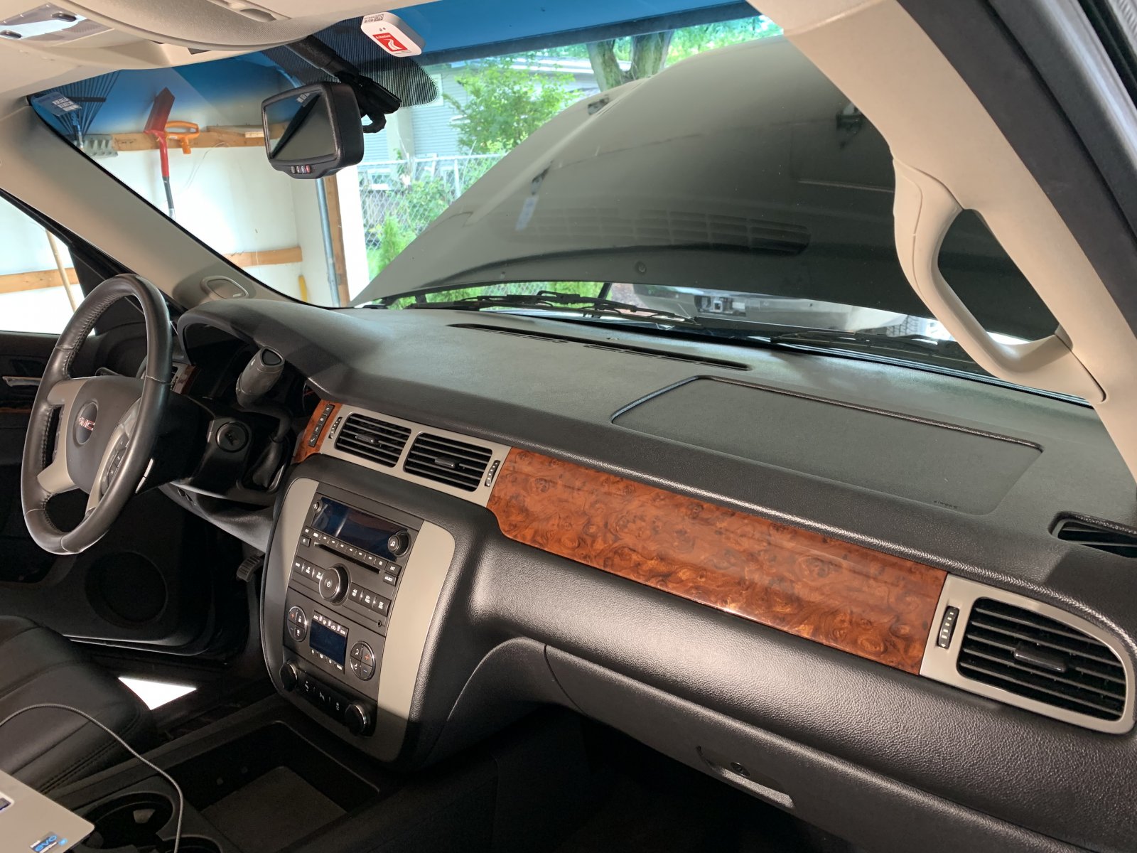

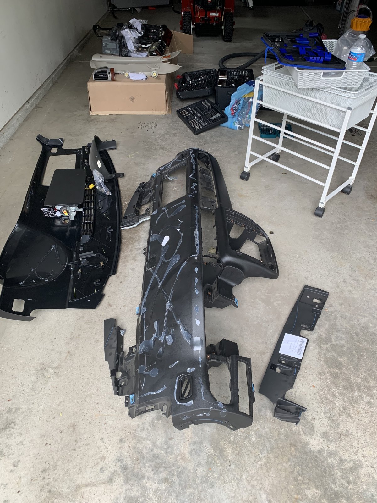

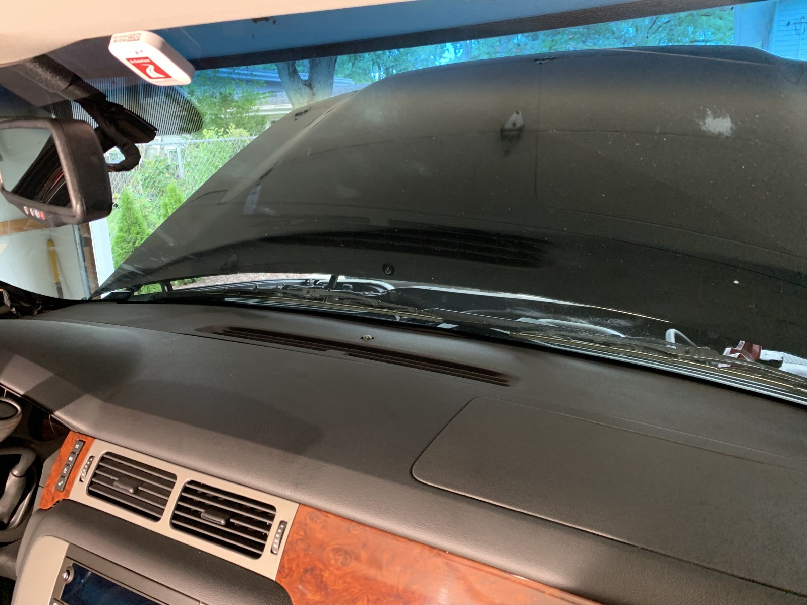

Three teaser shots as to what I was up to today, I have 106 total pictures and will be doing a full write up on how I got the dash out and then back into place.
From start to finish plan on a full 9 hour day with a break at lunch, also ensure you have visited your favorite adult beverage store prior to starting so that you can enjoy a drink after you're all done.
