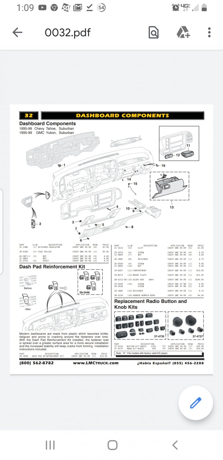

Looks like you've got a 99?
https://www.gmt400.com/threads/lmc-dash-reinforcement-kit-95-99.16208/
Reinforce it and get a cheap cover and call it a day imho.
