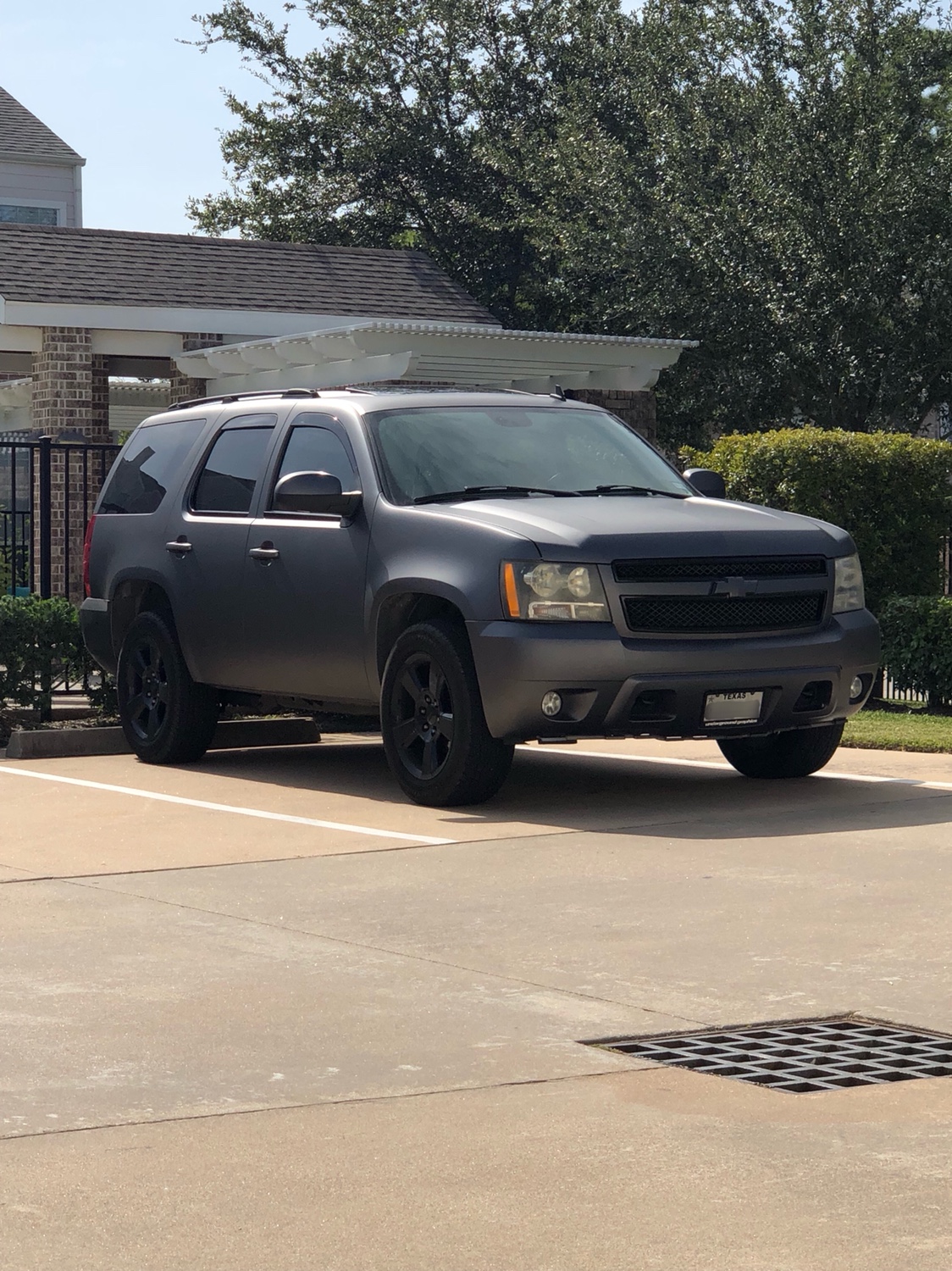

Dark Grey Matte wrapped 2007 LTZ Tahoe

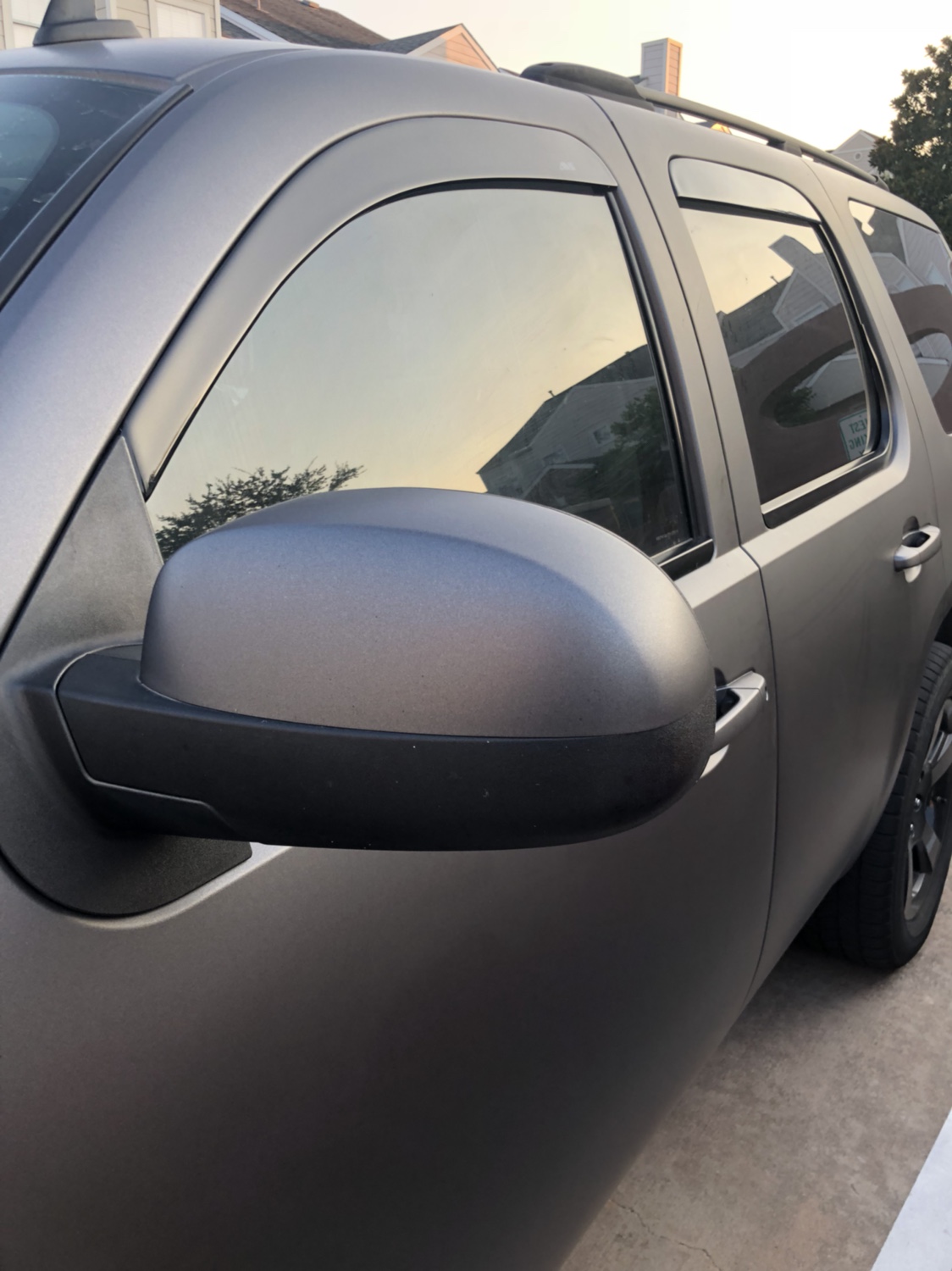

Also just added the Low-Pro AVS window vent shades.

Nice job. I worked up the stones to wrap my boat and love it. Was tedious but not overly difficult. Anyone thinking of it have at least one helper preferably 2.

How well do they fit? Been keeping my eyes peeled to see some on in person.
Very well. I was torn between the three styles, but the low-pros you barely notice, which I like a lot. I’m not a smoker, but I got them more for the fact that my Hoe sits at the airport 12+ hrs a day in the Texas heat. Now at least my vehicle is not thermal-nuclear when I leave work, and I don’t have to worry about rolling up my windows if a storm passes. Get them off amazon if you do, only $60 shipped. Here’s a few more photos.
Yes, the rear windows you can only crack about a 1/2” to vent without leaks if it does rain, which isn’t a big deal to me, but to each their own.

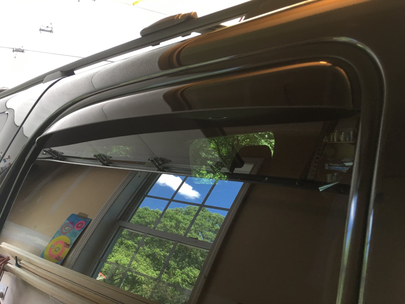

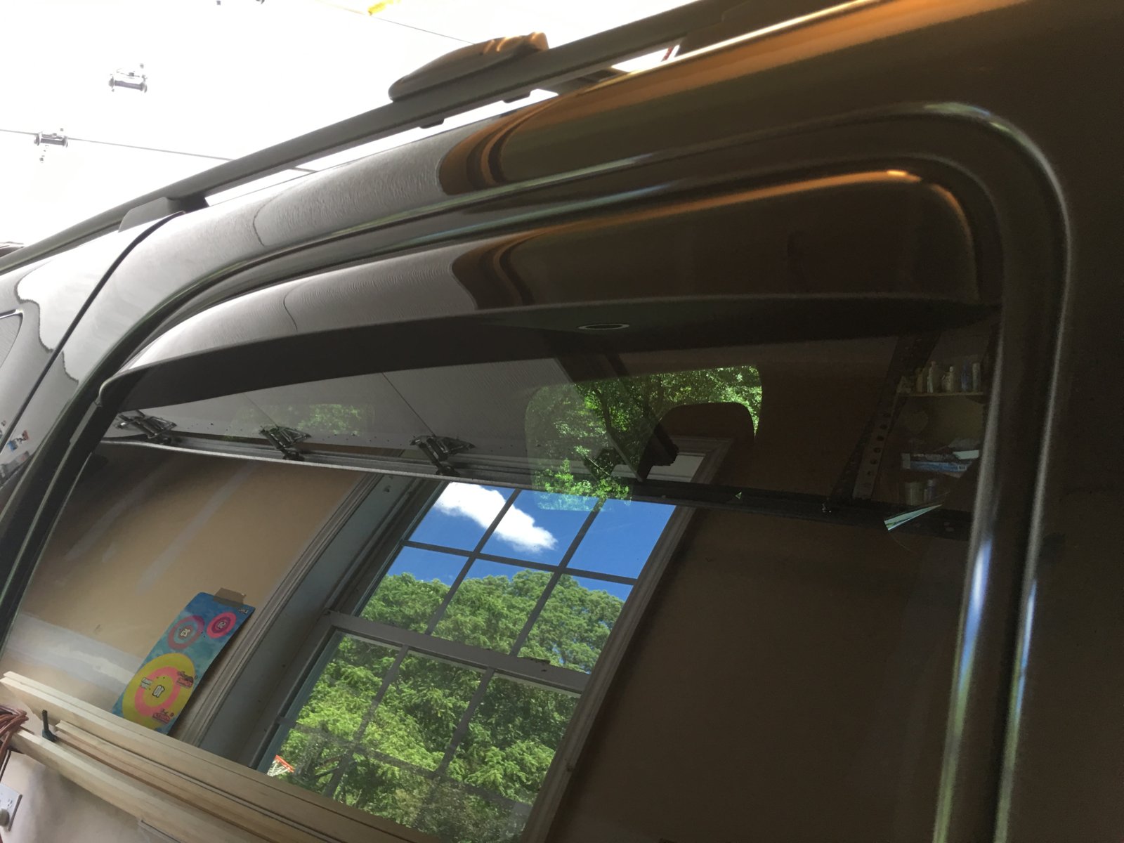

Ive had 2 of three and im still torn...just put the in channel ones on... had the paint stick ones originally... next is your way..

Nice job, looks awesome! I have been debating over vinyl wrapping or dipping for some time, but after seeing your work I'm really leaning towards wrapping!
For the front bumper, did you do inlays for the fog light and tow hook recesses? Could you take a few close up pics of those areas?

Yup, you’re exactly right. Inlays first then the whole bumper (that’s how I was taught). All together there is 7 pieces of vinyl just for the front bumper alone. The trick is to hide the seams, and ensure they agree to fluid dynamics/ airflow (you don’t want the vinyl lifting because it “scoops” the air or rain). I’ll post pics shortly.
FYI- front bumpers are the hardest objects to wrap on cars, so mine is by no means perfect. Actually might order more material and redo it in a few months.
As for plastidip- don’t waste your time. You’ll be redoing it in less than a year, and it’s hard to get an even coat. Been there done that on my old Subaru BRZ stock wheels.
Please keep in mind, my daily commute is 120miles, so yeah, my front bumper goes through hell.
