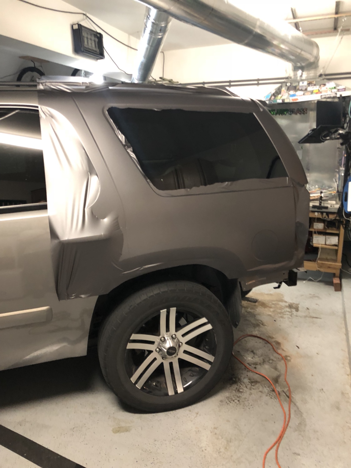

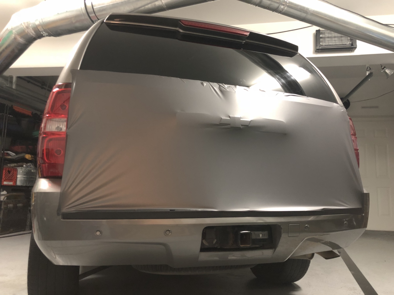

So, I wrapped my 2007 LTZ Tahoe in the course of two weeks. The first week I wrapped a panel a day (Johnny Cash style) until there was just a bumper remaining. Then I took a few days off before tackling the dreaded front bumper. I managed to get it all done in a little under 40 hours (cleaning/prep/wrapping).

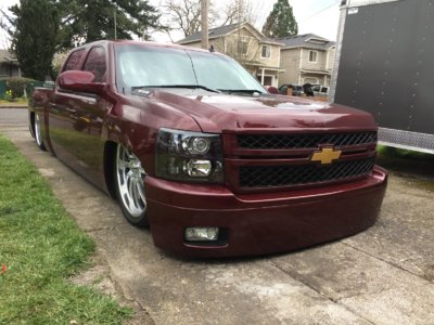

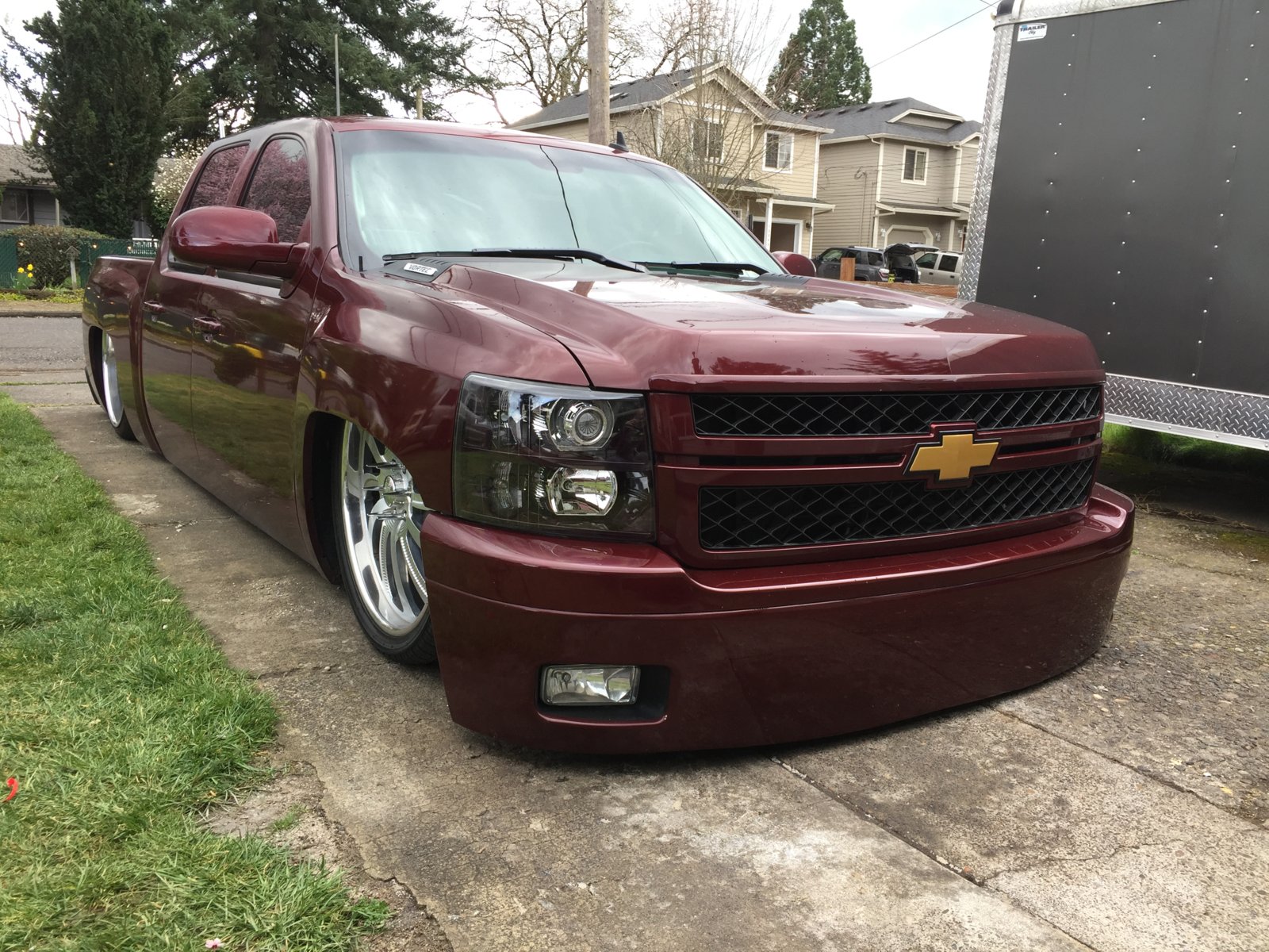

I would check out Ebay for headlights and taillights. You could do OEM or aftermarket, better pricing, no tax and free shipping.
