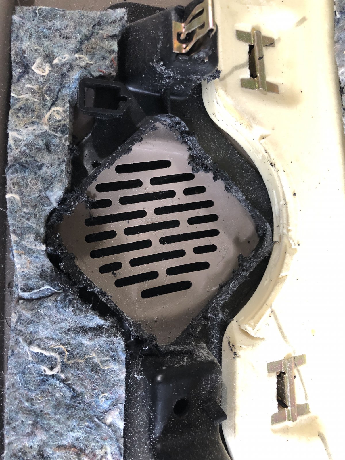

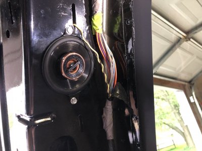

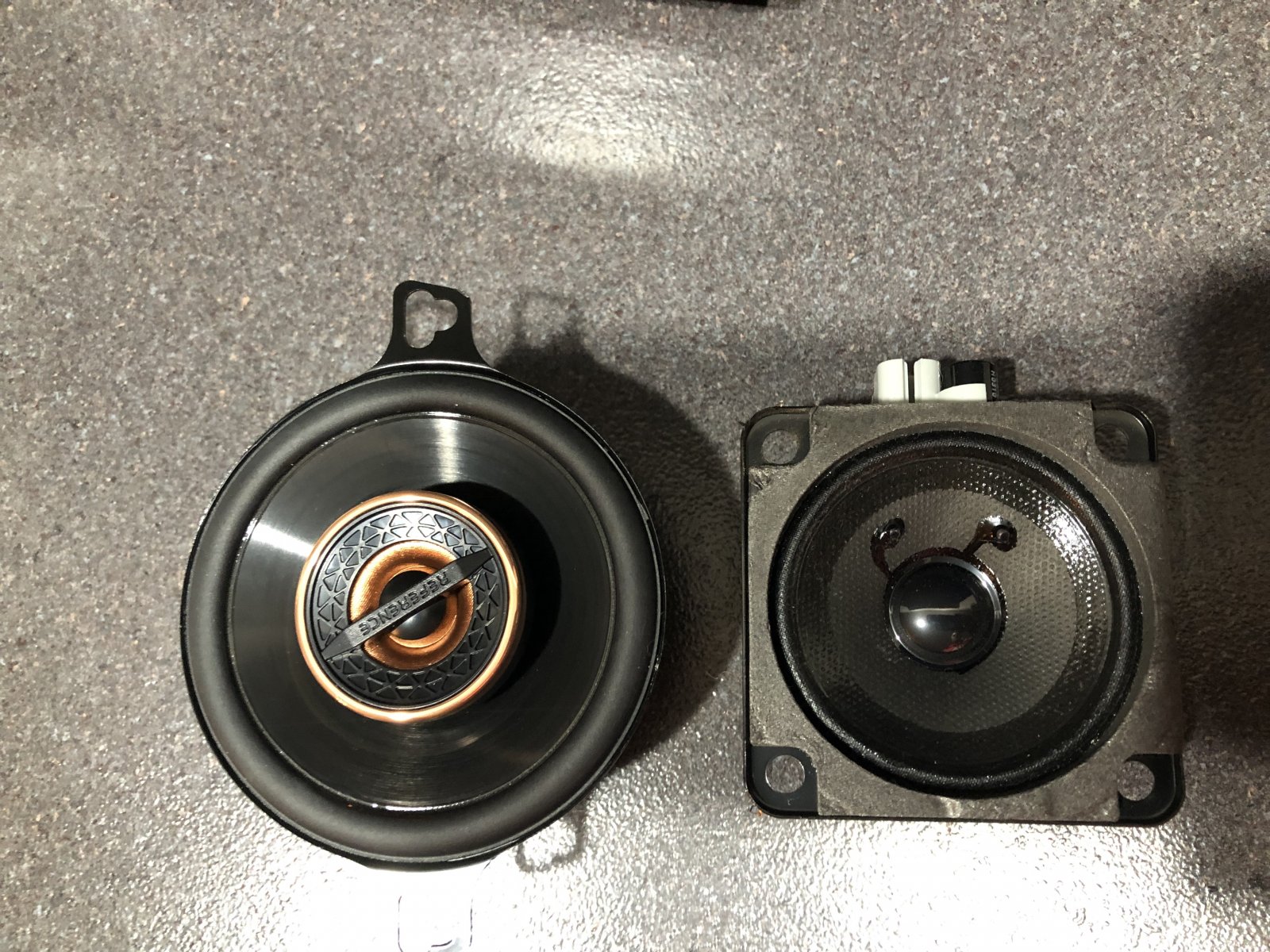

So i found these speakers that sound alot better than the stock bose system.My buddy put them in his and i was amazed at the difference.Just alot cleaner and you can actually hear something back their thats clean.$40 bucks online worth every penny-for what i wanted. I cut the d pillar panels to accept a bigger speaker with the dremel-and they fit right in the holes for the old speakers.https://www.amazon.com/Infinity-REF3022CFX-Reference-Speakers-Edge-driven/dp/B01E4JWG6I

I did the same back there but with the kicker ones that are 50 rms. Not a hard mod but worth it. Everything i have is after market and full 50 rms going to them

I did the same to my 00 many moons ago, just provides a little extra filler sound is all 3.5" is about as big as you can go without making cuts in the metal and more cuts to the trim panels
