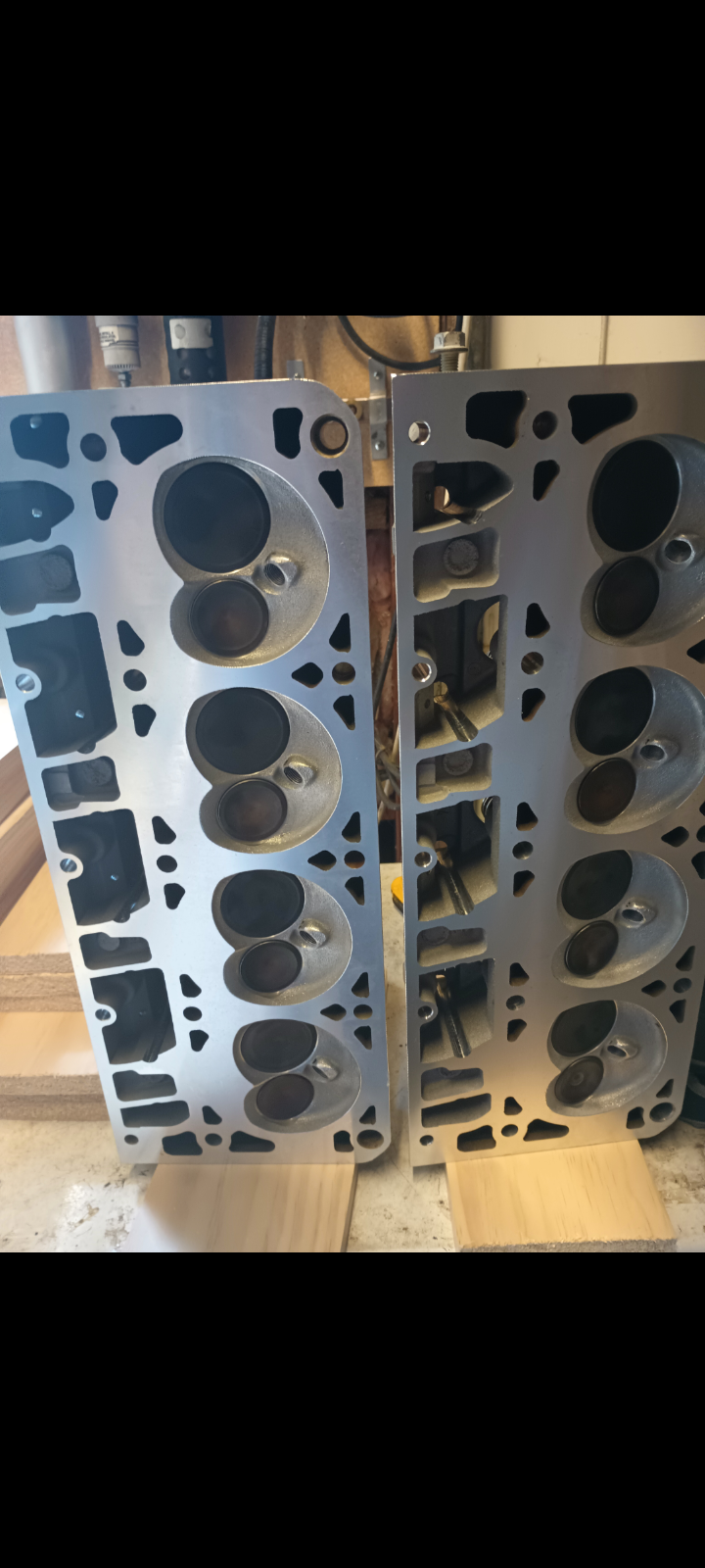

I had some stock 317 heads checked, cleaned and remachined by my local machine shop a few months ago. These were going into a 6.0 that bought flat top pistons so I didn't really need them milled to bump compression any more, just cleaned up. But that would have been an option for sure. I believe it was $400 for everything. I'll double check on the price later.
