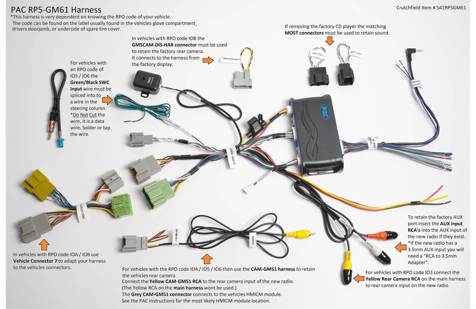

This harness from crutchfield looks like it has something to retain the rear aux ports.

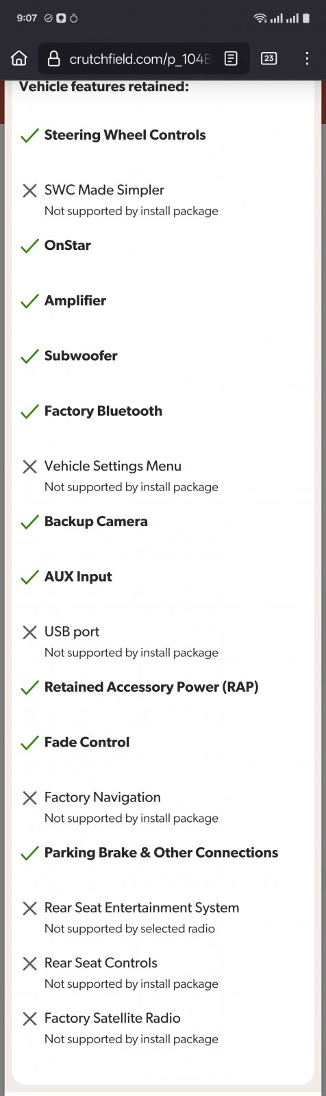

No, none of there kits mention anything about RSE, your going to have to call and get more details about that, then let us know lol
I'm just going off what the picture for the harness says. I did talk to crutchfield and they seem to not know.
your going to need to reach out to pac or idatalink, I think idatalink would be the most knowledgeable they sell a lot more adapters than anyone and they do custom programming
they have basically everything interfaced if it can be done, I can use the maestro and do all kinds of things if I wanted to
