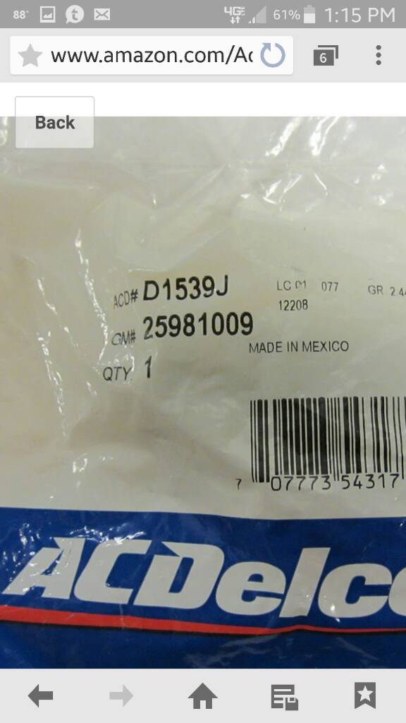

Just ordered this one today.
There are two part numbers floating around out there.
This is the new one.
It also fixes the condition of light pressed pedal and the lights turning off
