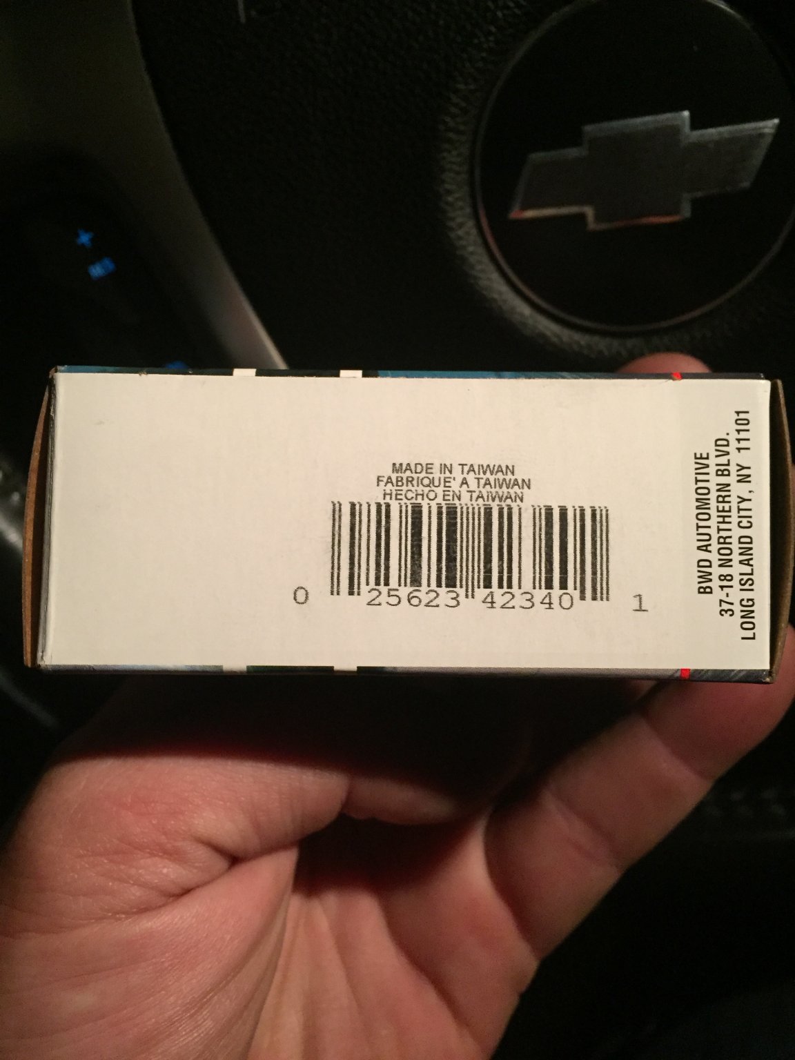

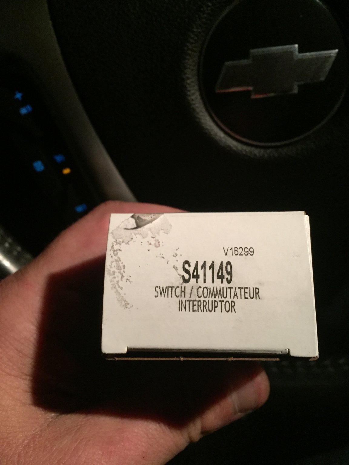

I have been without cruise for a year. STUPID ME for not thinking to search "cruise control" on the TYF until today.
I tried cleaning the contacts in the switch but that didn't work... bummer. In the process I broke all 4 of the stinking tabs on the thing so I thought I ought to go ahead and replace it. To my surprise, Advance AP had one in stock.
Voila, fixed, I'm cruisin again :)
Here's som pics of the box:

Tearing that switch apart and cleaning it etc. Will NOT work.
You must replace the unit. Been there done that.
Also the new ones are redesigned to stay on properly. The old ones will make the brake light turn off if you lift off the pedal .5 and inch.
Try and see and you will know if you have the old or new style
