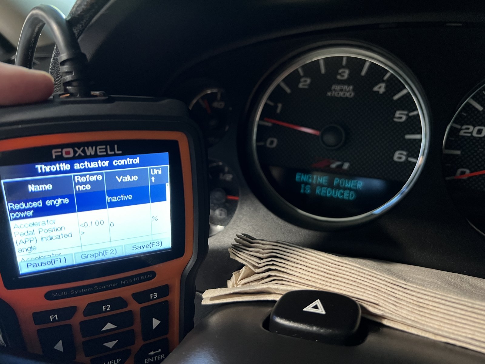

Here is a link to all of the data for the throttle actuator. I think this is what you’re looking for? Everything looks good
We found the ISSUE!
it should be at 15-19% idle (may vary per the idle rpm set at the factory)
a value of 0% means it's not working..
idle it shows a percentage on mine
[idle] APP_D 19.2% & APP_E 9.4% (May vary because of factory set idle speed)
[Full Throttle] APP_D 85.1% APP_E 42.4
even in autostop the gas peddle will still read something

Can anyone else confirm?
I did a relearn and a throttle sweep relearn and I’m still getting the same results.
I noticed yours is a hybrid
Checked the wiring/plugs. Everything looks ok.

you did a resistance check
look for an open wire
the gas peddle is identical
