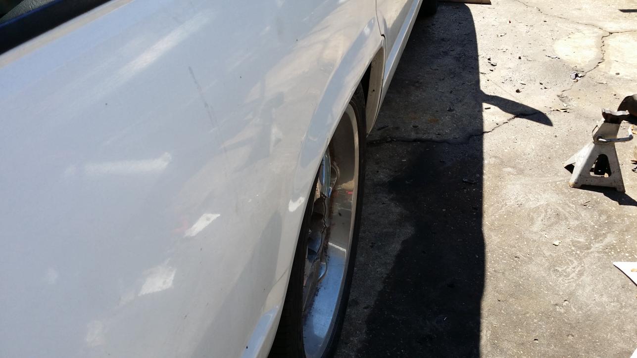

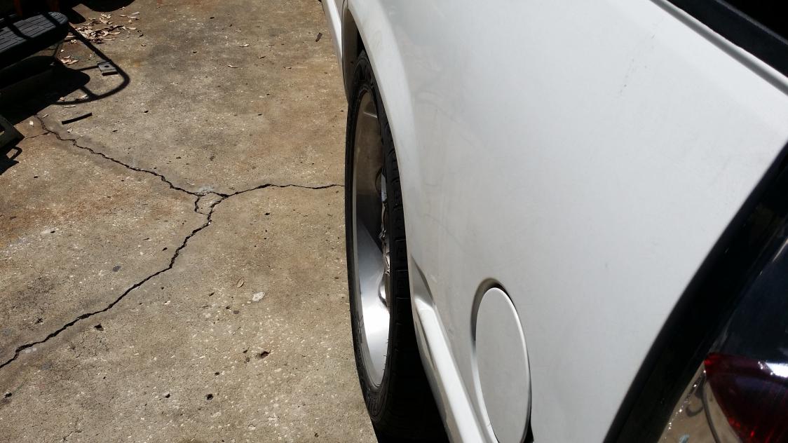

This past weekend I installed the DJM suspension, it's a 5/4 drop. When I was done and went to measure how low it sat I realized that the rear end is sitting more to the drivers side than the passengers.
The spacing between the tire and the fender is : Driver side .5" Passenger side 1.75"
Has anyone come across this issue before or heard of this happening. Any help with this issue would be appreciated. Thanks

how is it crooked? shifted forward or back on one side or another? mine sits about 1.5 inches to the passenger side and it's setting in the pins in the springs which have new bushings pins ubolts etc

I have the same problem except for mine its towards the driver side. I have all new hardware, bushings, and even hangers. I think I didn't notice it before because its at so high. Now I just want to correct the problem but have no idea how to.

I had planned to have a wheel spacer made to even it out, and have my alignment redone, i know it's not ideal but i honestly don't know another way to get mine in alignment, what condition are your shocks in? i was doing some googling and found a few threads about the body shifting a bit on the mounts

I saw a similar post on the Impala SS forum that had the same solution. He posted to loosen body mounts and shift body over till even on both sides and then re-tighten body mounts. I want to get a few more confirmations before I do that to my hoe.

Before I go and do the body mount adjustment. I will probably do more research but the last time I did a frame off chassis build on my SS I took the frame off while the whole body was still together. When I put it back together it was still in alignment.

If the kit involved axle u-bolts then that is likely the issue. The axle likely got shifted slightly and or the u-bolts shifted somehow.

The only way to be sure is to measure wheels to frame on both sides, it that is on then measure wheels to body and if that is off then the body has shifted
Edit: if the wheel to frame measurements match then checking frame to body may be more accurate unless than wheel to body. Not sure what I was thinking there

The kit comes with alignment pins to keep it in the proper location. Looking back at pics... It might have been like that since I've owned it. Measurements I took makes it square to the frame.

The sway bar isn't going to line up if the axle and frame aren't aligned. This is a good way to determine that.
Ubolts aren't going to do what you are describing, there are a few things that could have happened, ubolts aren't one of them.
