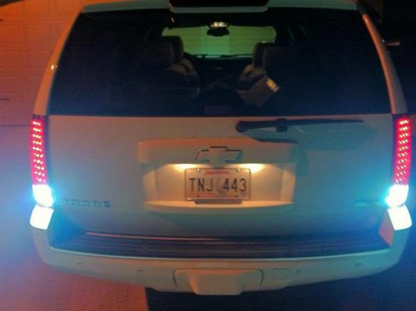

I did HID reverse lights on my 08 tahoe and my current 07 avy. They're bright even during the day!
6K HID's in avy:
8k HID's in old tahoe:
What bulb size are you using?

I just used some H11 bulbs (normally used for low beam headlights) and trimmed the area around the tail light so they'd fit in there. Then I sealed it with high temp silicone to make sure there is no air/water/moisture getting in there.

So 35 watts?
How did you do this? New base connection?

Yea 35. Sorry I thought you had asked what size bulb not the ballast wattage.
---------- Post added at 11:16 PM ---------- Previous post was at 11:15 PM ----------
Yep. Spliced em in.
No i did ask for the bulb size but then i thought i would ask wattage
