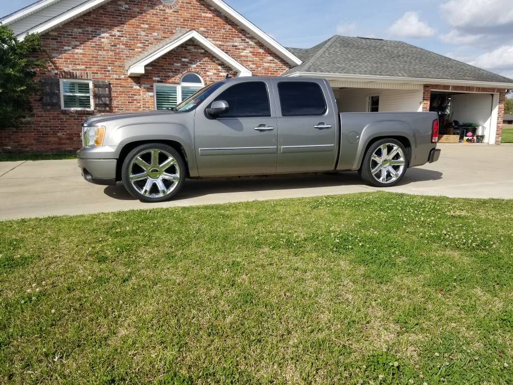

Soooooo, I just finished swapping out the BT struts back to oem struts with the coil relocators! Had bt struts set at 1.5“, went the full 2“ on the relocators. It dropped it about the other 1/2" I needed in the front.
Gonna get the alignment here soon!

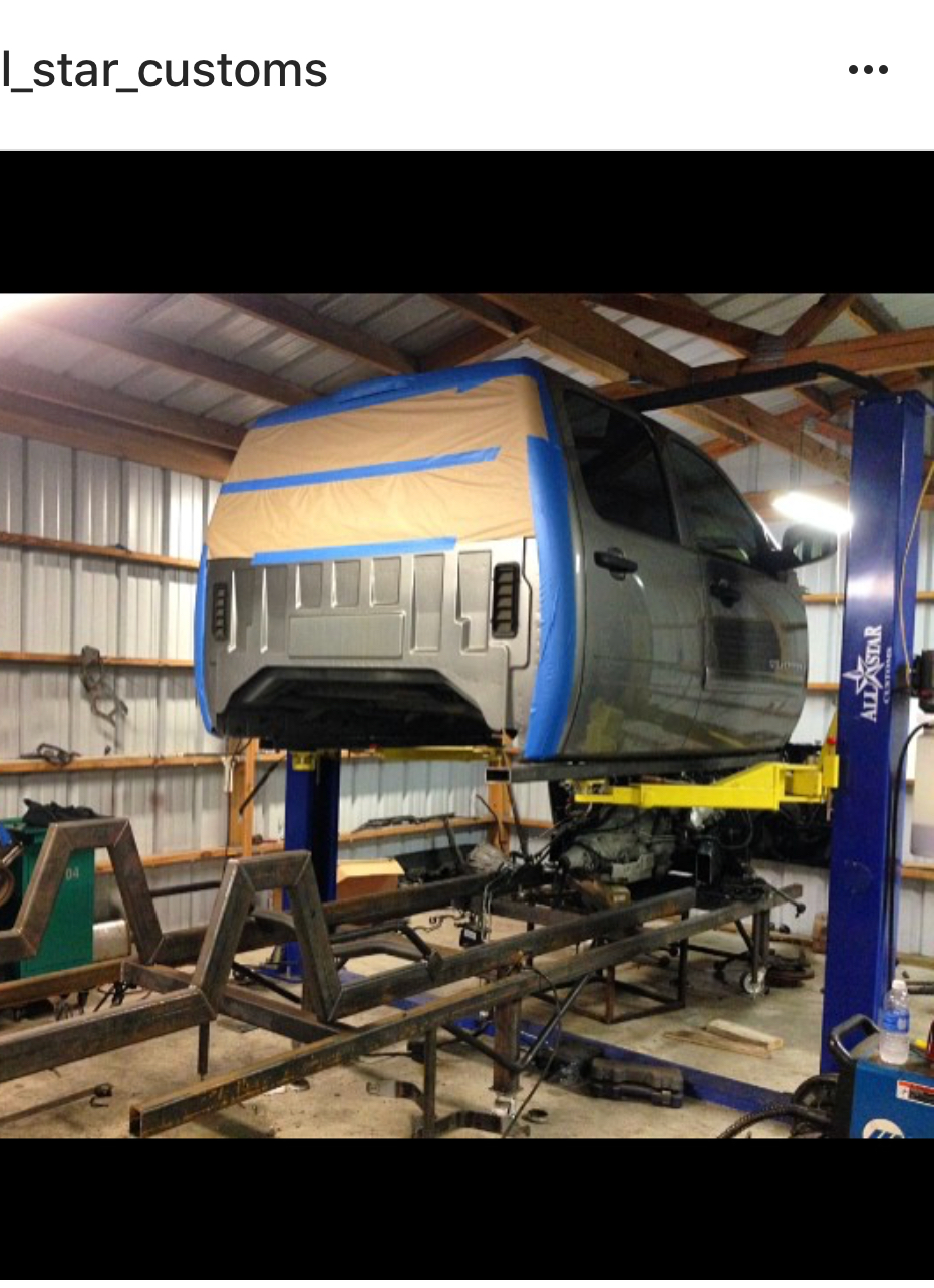

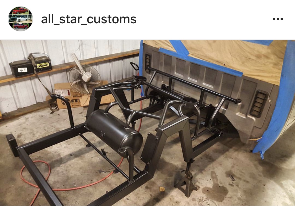

What's your set up?
The shop that built mine did a new frame from the engine back so they could do a body drop with a stock floor. The frame is not as tall. Plus its bagged.
52,949
Yeah I bought it from a guy that spent a lot on it but I got a good deal. I have a build thread link in my sig if you want to see it. I don't wanna clog up your build. Actually I guess I already did, sorry!
