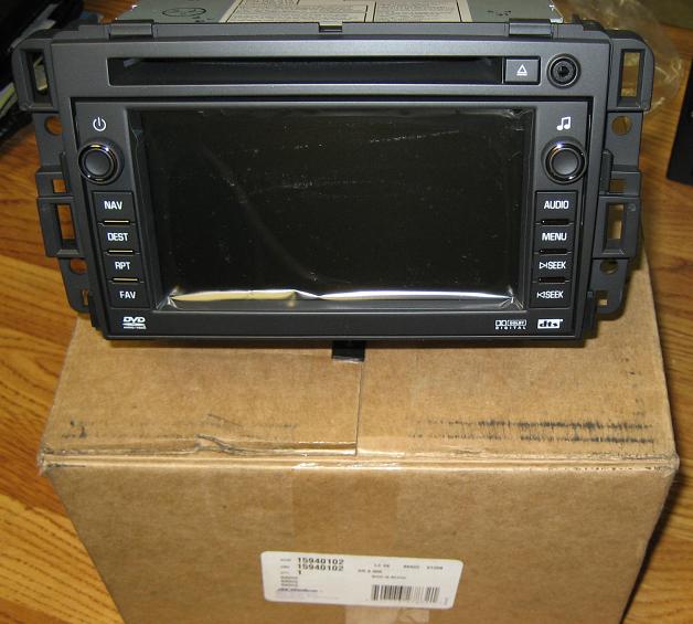

Firstly, that first picture you have posted is NOT of a factory navigation unit. It is one that appears to posses a similar look, but it is most definitely not a factory unit. Most likely an aftermarket look-alike. See picture below for the correct one.
Secondly, if you go with a factory navigation unit then yes the wires are the same, well mostly. Because you don't have the factory navigation, there are a couple of wires that you will need to run. The wires are fairly inexpensive (around $45.00-$60.00 for everything). It is not hard to do, and I can provide you with directions if you need them.
A special note: You must buy a Bose navigation system if you go this route, and you can buy one with DVD playback capabilities even if you don't have a rear entertainment system.
If you go aftermarket then yes you will most likely need a harness if you want to keep your steering wheels controls, vehicle chimes, and Onstar functionality. There is also a similar wire (VSS wire) just like for the factory unit that will need to be run. This is a speed sensing wire that must be installed for the navigation to work.
Either way, there are a few wires that will need to be run. It is not all that hard, it just takes a little of your time and of course, some patience. I hope that somewhat answers your questions. Feel free to ask if there is anything else you need to know, or want more information, or clarification about anything at all. :Handshake:
