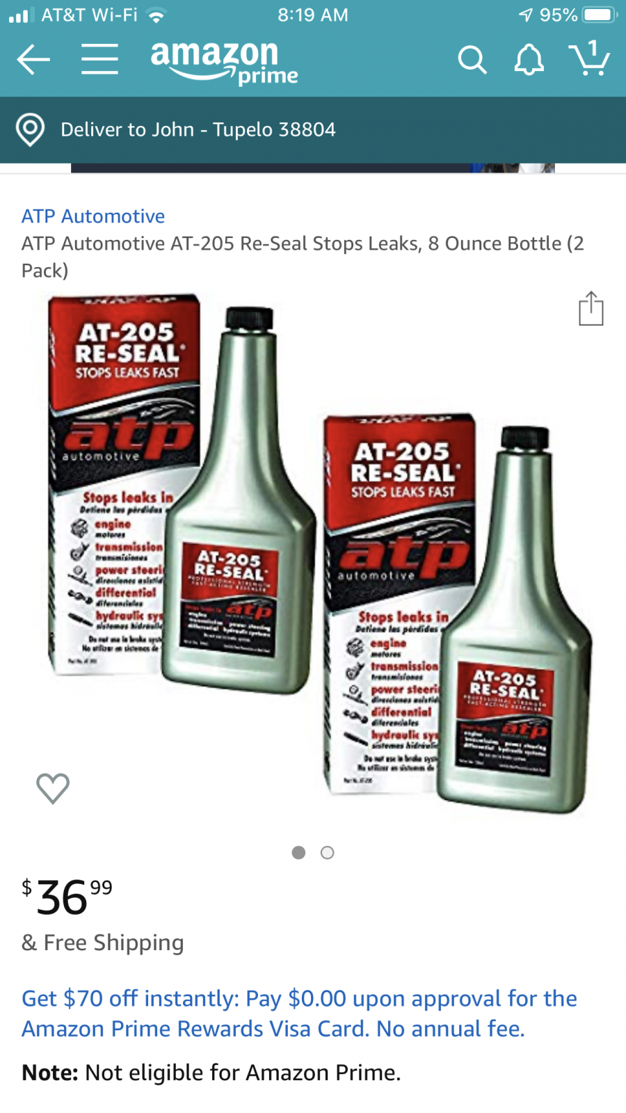

I always change at 3,000 mi which some may say is too often. Does stop leak really work? Should I try the brand shown in another reply? I’m not familiar with that one but am willing to give it a go. I hope the tranny doesn’t go but given the mileage I wouldn’t be too surprised. What’s a trans replace or overhaul cost and would you consider an overhaul?
2591tdj
Jan 26, 2010
261
175
Miss

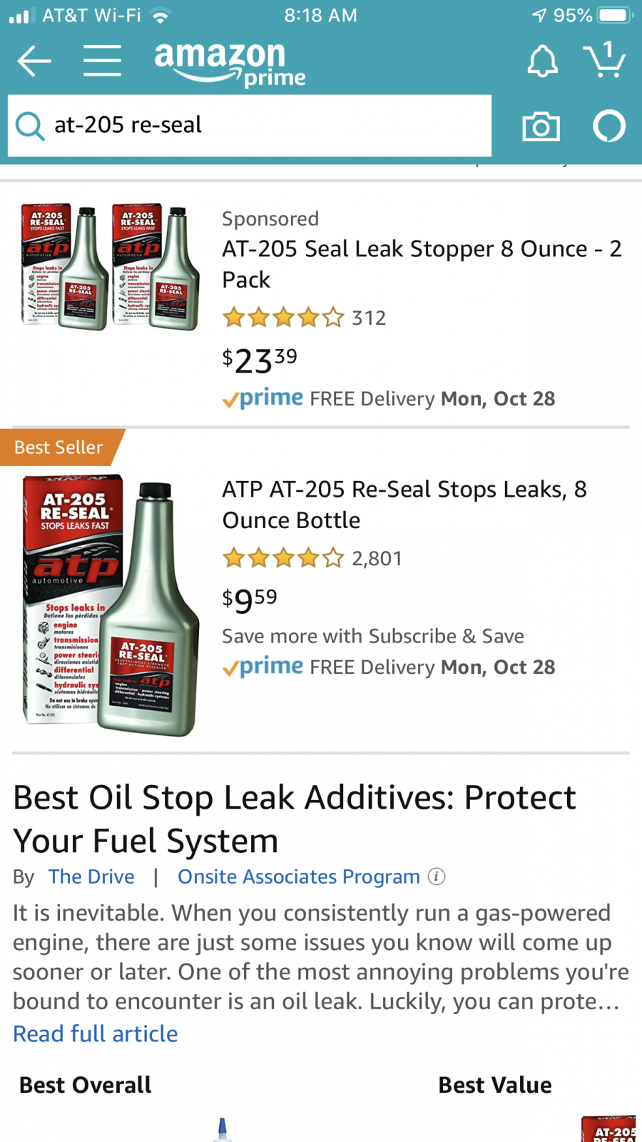

Amazing price differences on Amazon.
Two singles are cheaper than a 2 pack.

If it’s a fairly large main leak, this probably won’t stop it. Ive only been able to slow mine, and it’s not a huge leak to start with.

I’ll order some and try it. It’s just small drips at this point plus whatever the quick change place spills onto the skid plates that then drips onto my driveway.

I'm of the personal opinion that a worn part should be replaced as to band-aided. It could very well be ignorance on my part, but my concern is what stop leak would do to other intact seals in the engine both with long term use, and what happens if you stop using the product. And $36 buys a lot of top-up oil
