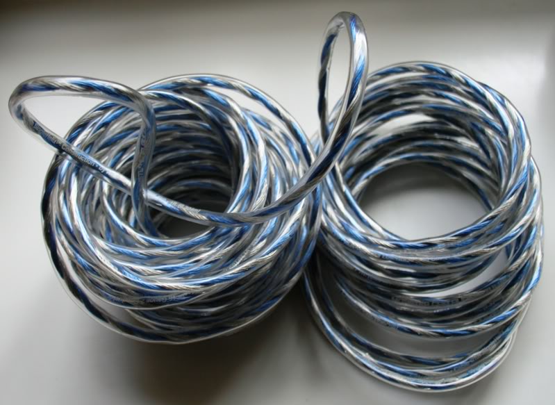

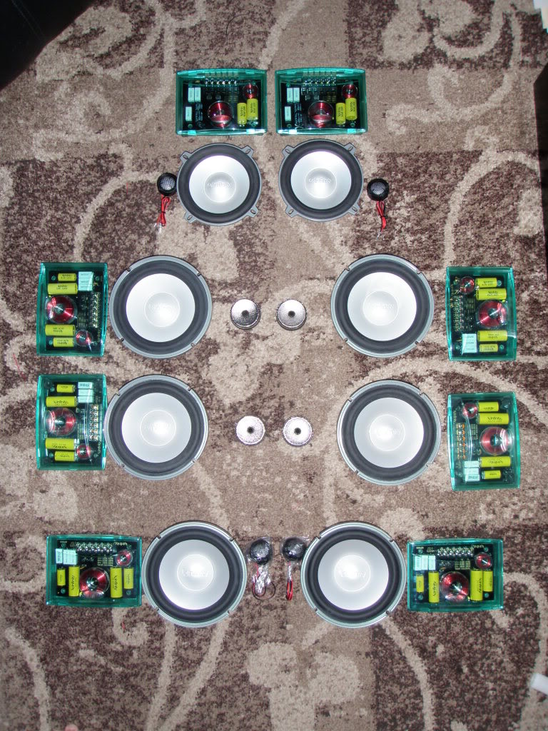

Little tease on what I'm wiring up right now, and it will give you a good outline of the speaker system. The front speakers are going to be in kick panels, then front and back doors sets, and then the last two in the back hatch. Wired with 16 gauge monster speaker cable, and run seperated from any power cables.

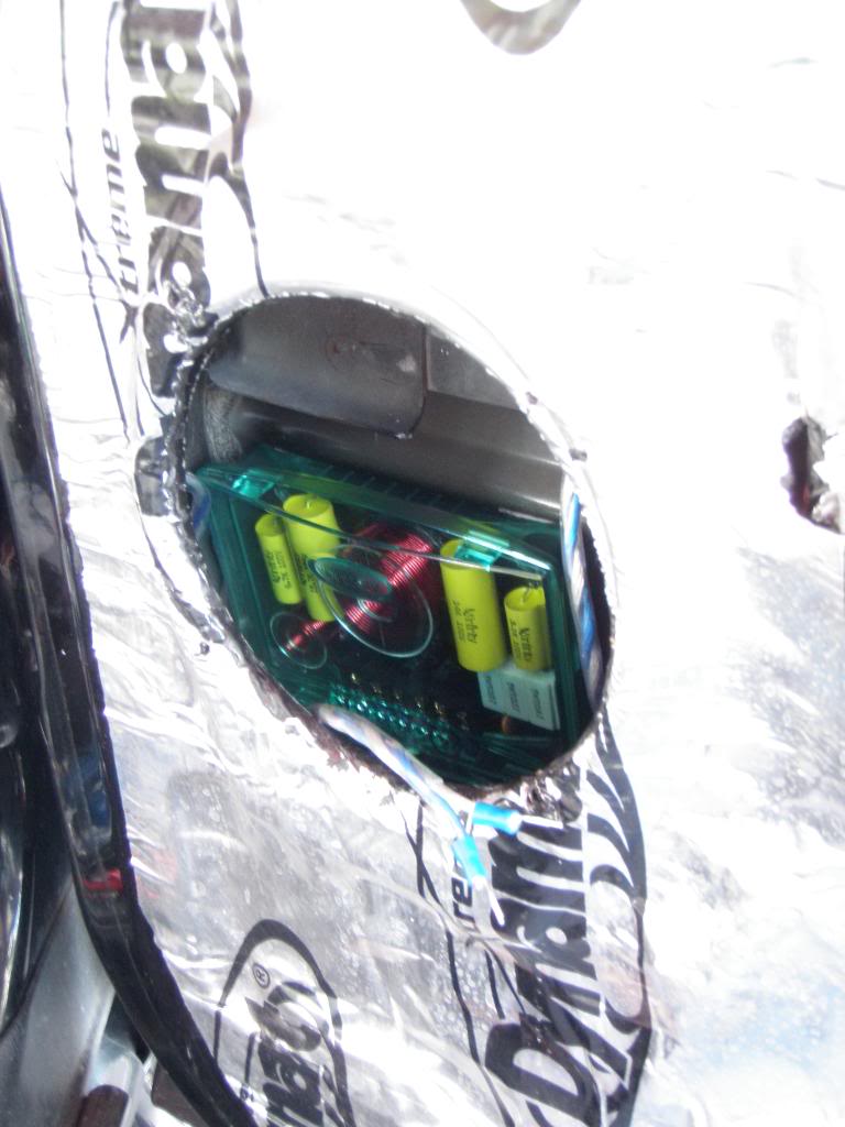

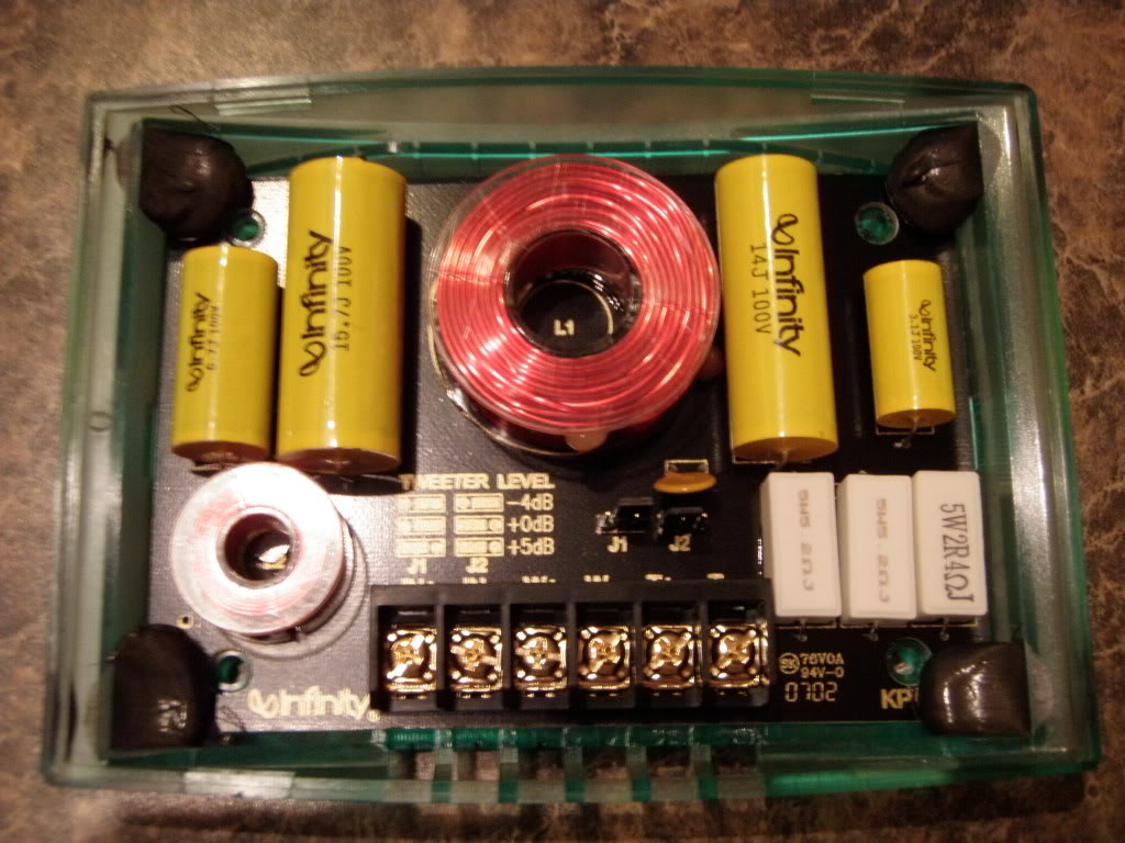

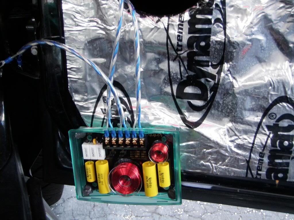

Yup yup crossovers, they seperate the high and lows to the tweeters and woofers. Actually just came on to post a pic of what I did to all the crossovers. I put some silicone in the corners of the crossover housing. You don't want that board falling out of it's clips on a hard bump and rattling around in it's housing behind your door panel.

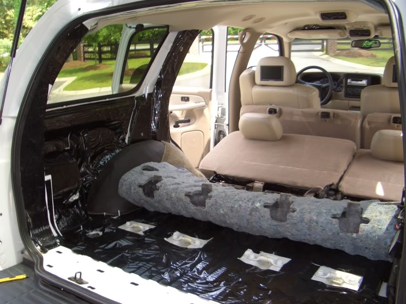

How much Dynamat is used for the rear floor section? I got 1 bulk pack of extreme (36 sq ft)...will that be enough to atleast get the cargo floor area for now?
Copper&Black
Copper&Black
May 4, 2009
641
For just the cargo area floor that will be enough, with a a piece or two left.

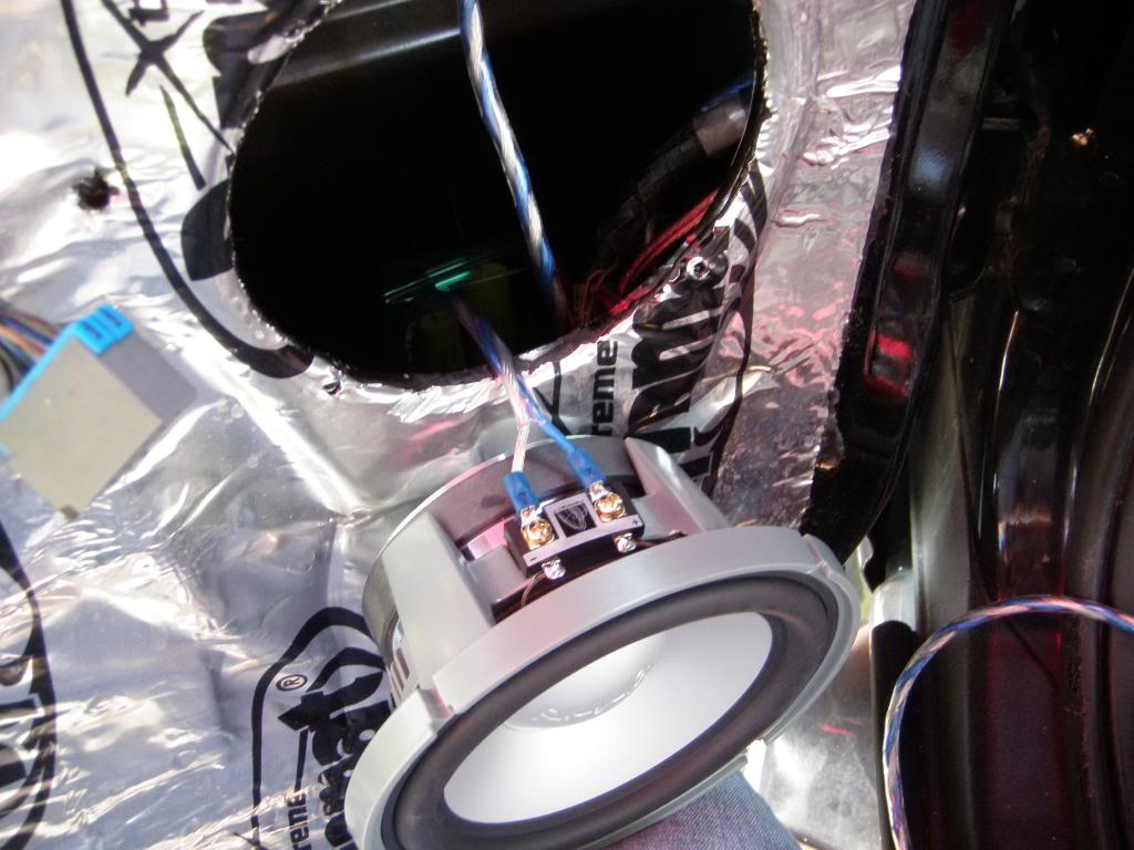

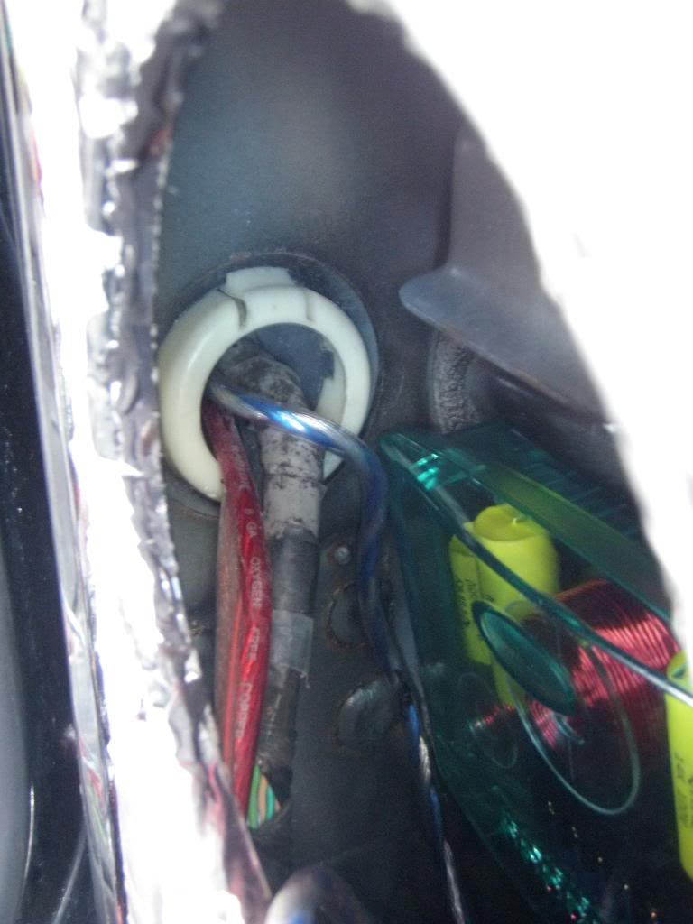

Here are a couple pics of today's work, finished off wiring from the front two door and placement of the wiring harness, power cables and speaker cables in the channels of the front doors. All connections have been coated with electric greese/oil. Not much but keep in mind it's football day...Go Cowboys!
