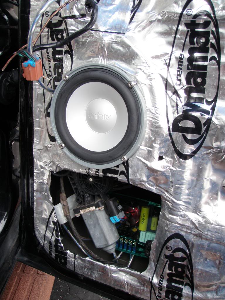

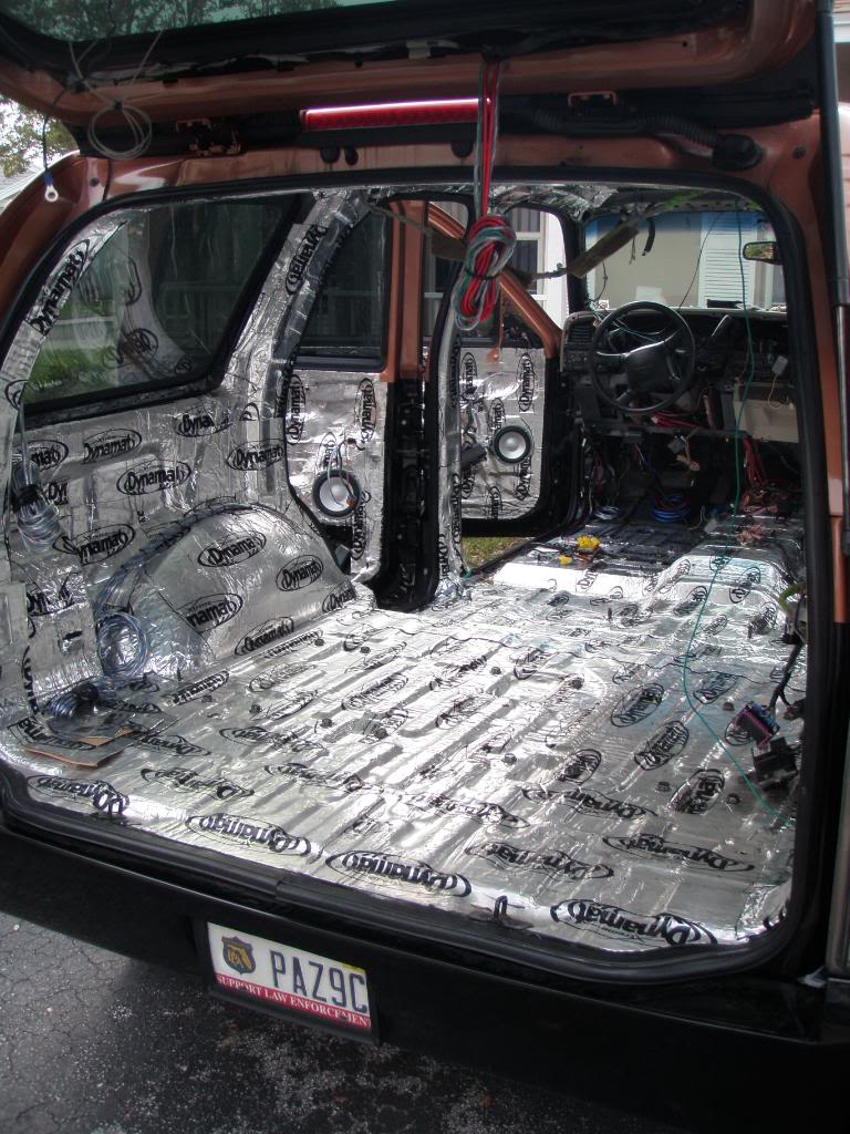

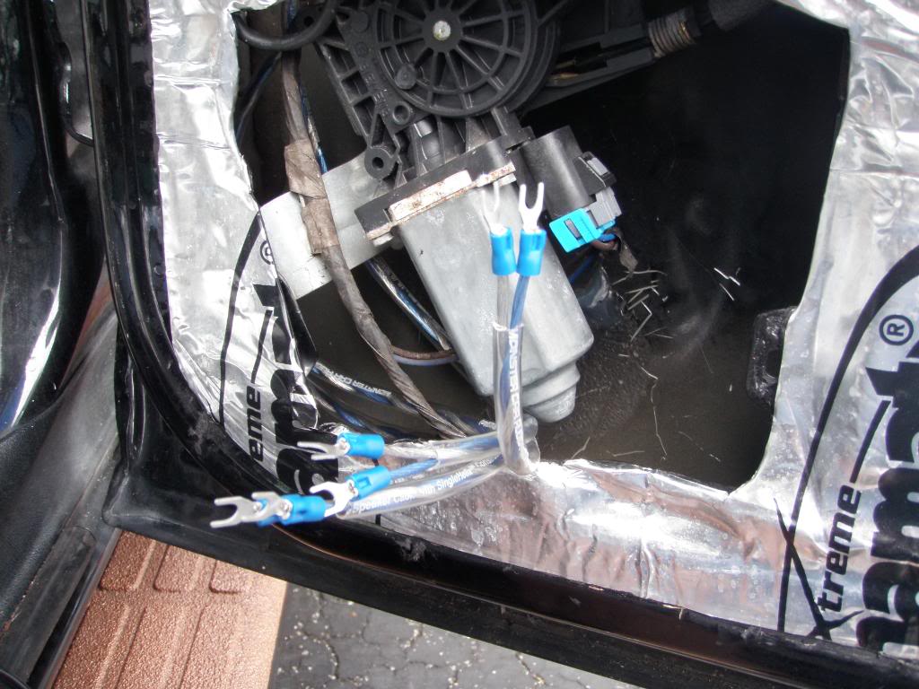

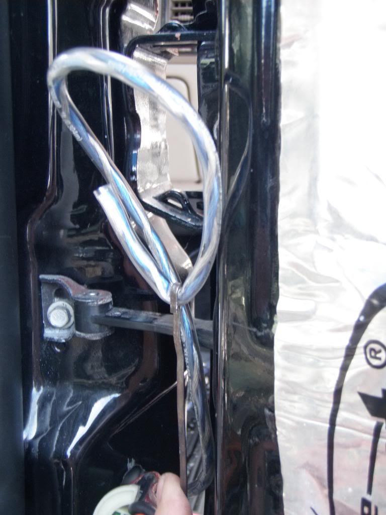

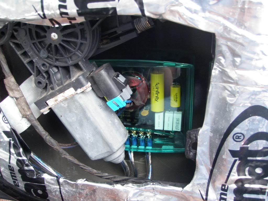

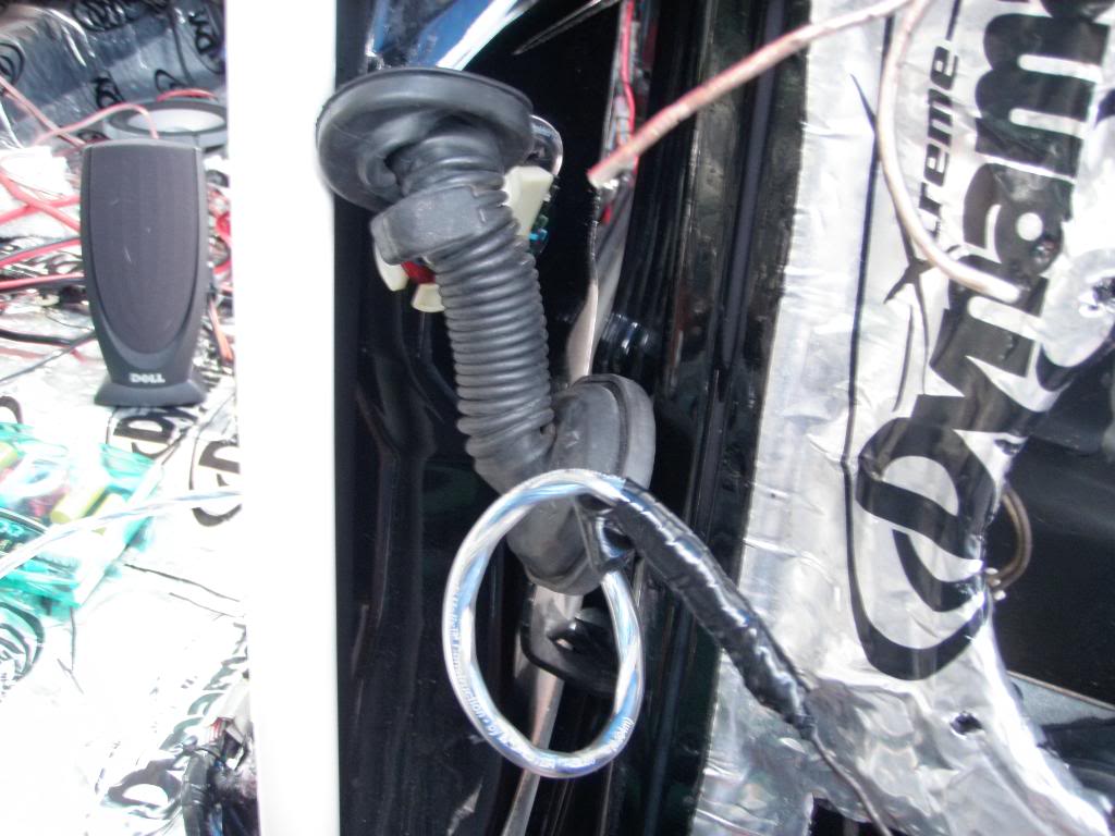

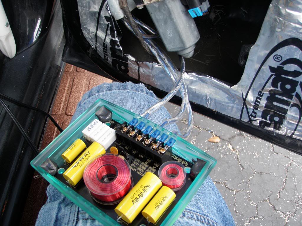

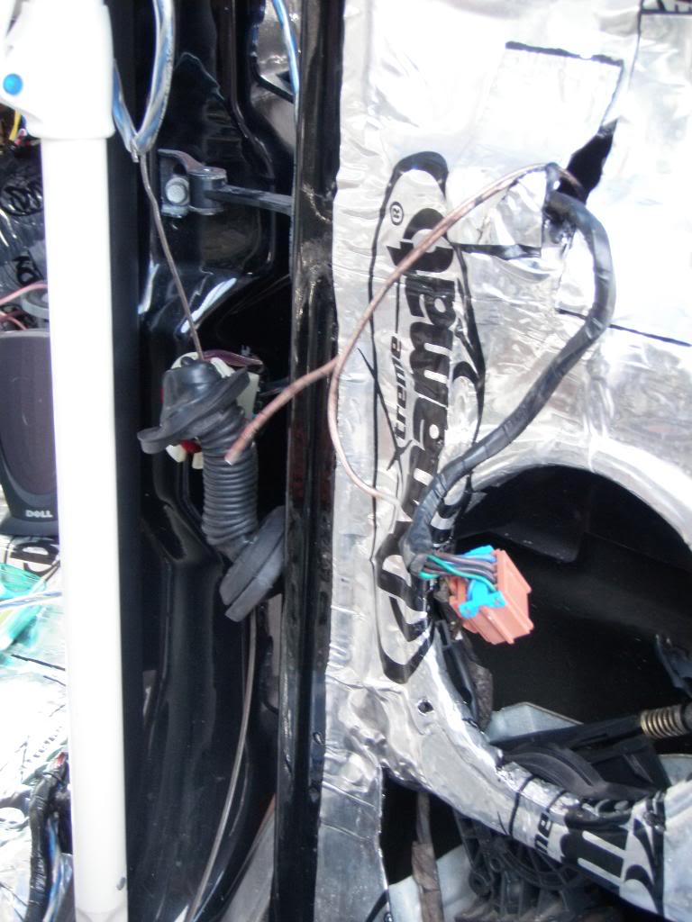

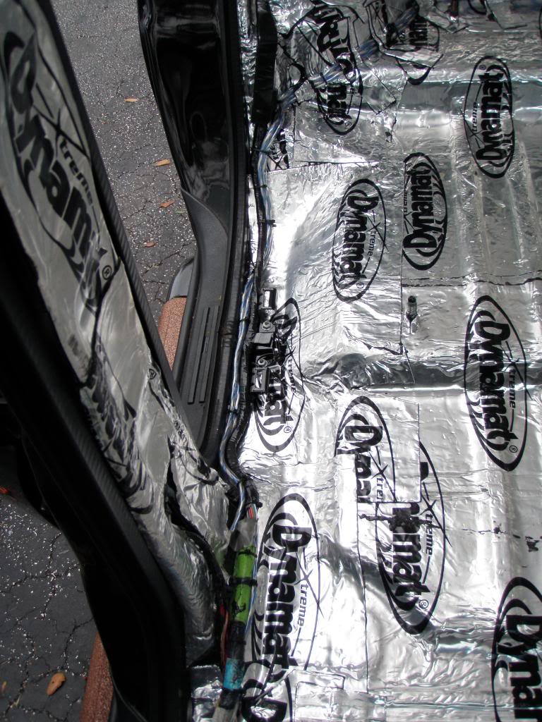

Well I finally got the last pack of Dynamat delivered, as well as 100ft of speaker wire. So today I finished wiring up both rear doors, and ran the wires from the pass. side to the driver’s side behind the 2nd row. I will follow up with a lot more pics tomorrow.
Here is how I pulled new wires into my rear doors...
After removing the boot from the door and the pillar,
Carefully pushed the snake wire through the boot from the door side in,
Placed the speaker wire in the snake wire about 1"-2" and fold it back on itself
Tape the whole thing together with electrical tape
I gave it a quick shot of electrical lube, and it slid with one soft pull
The rest of the shots are self explanatory...

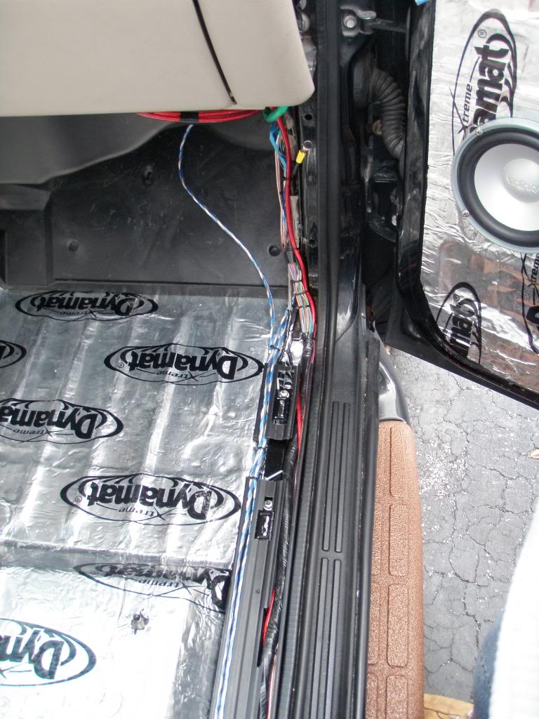

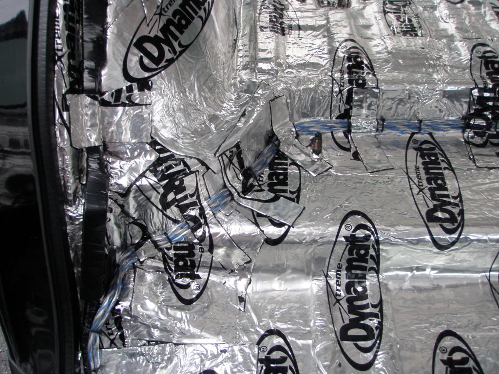

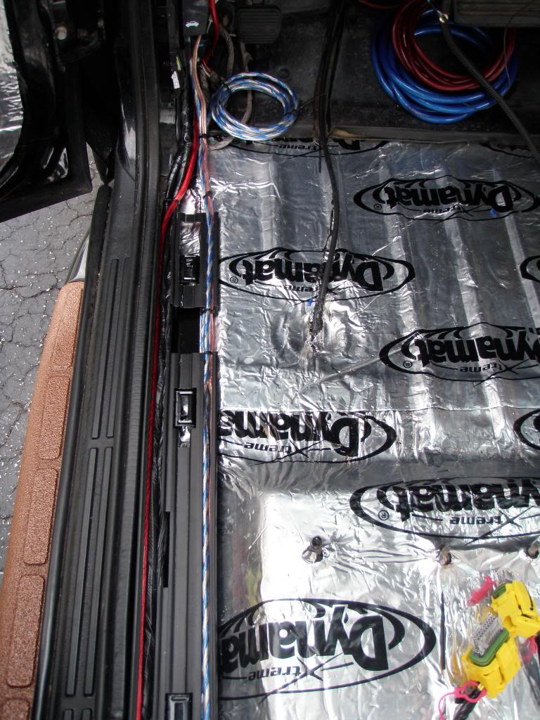

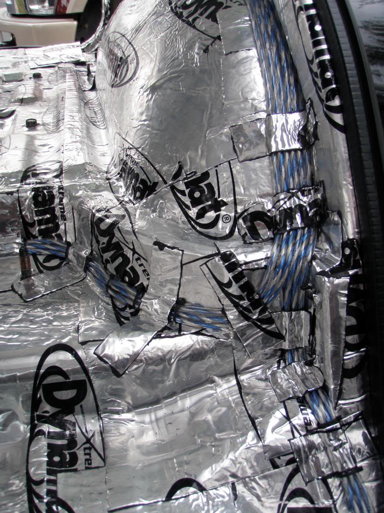

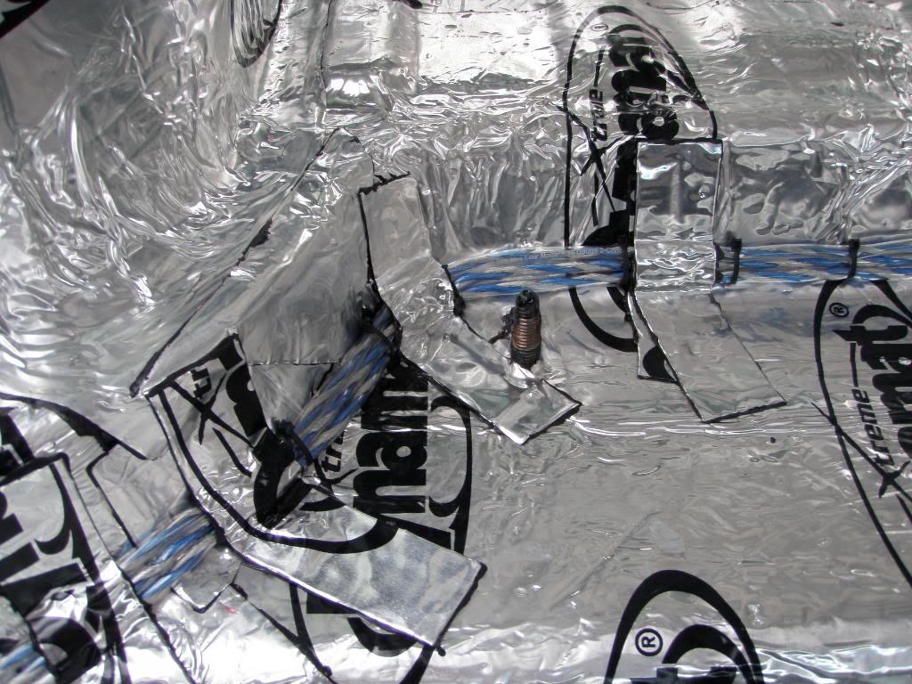

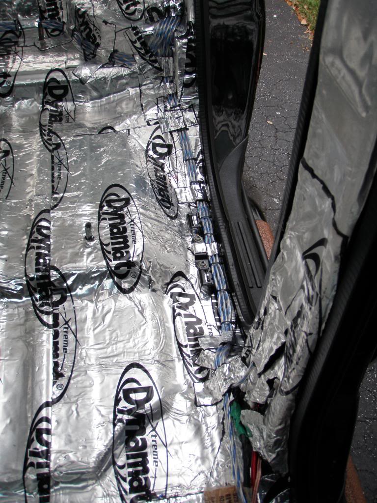

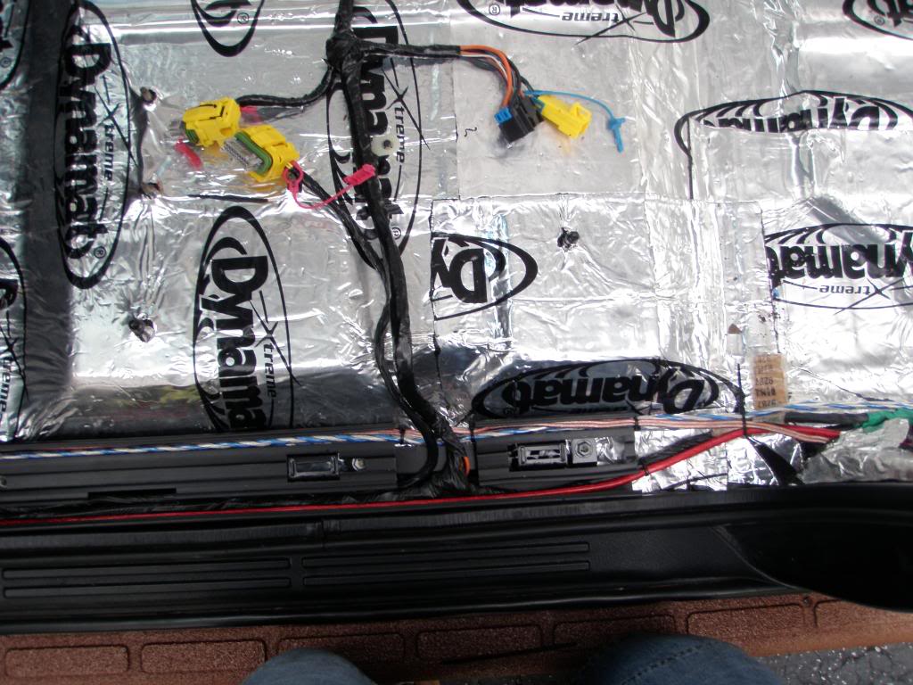

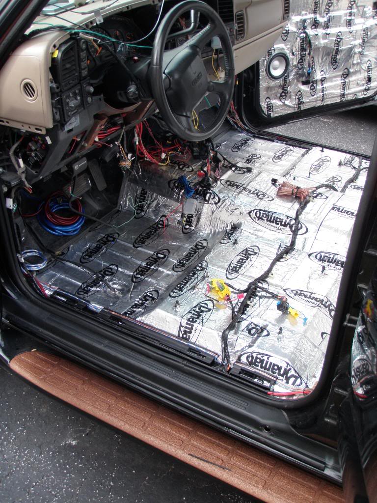

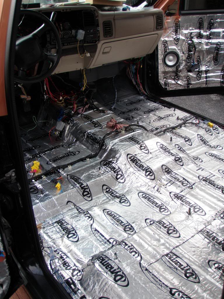

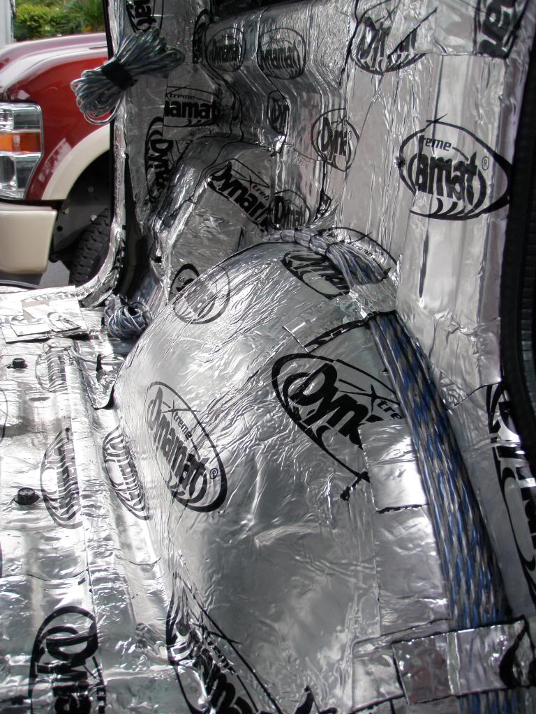

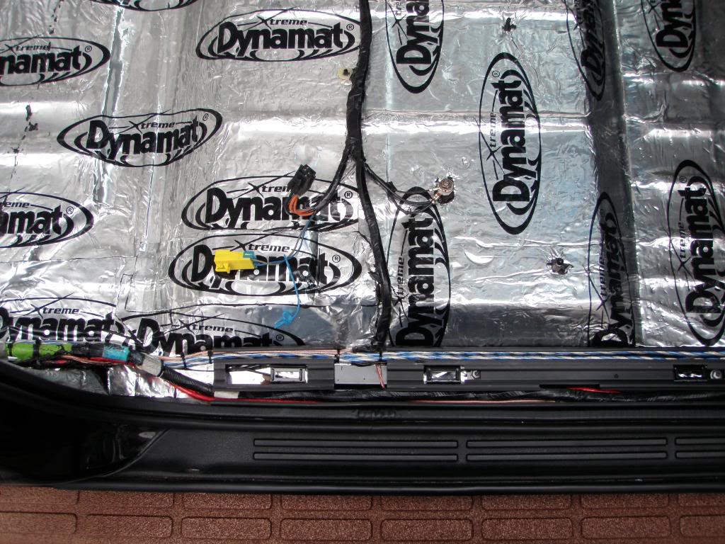

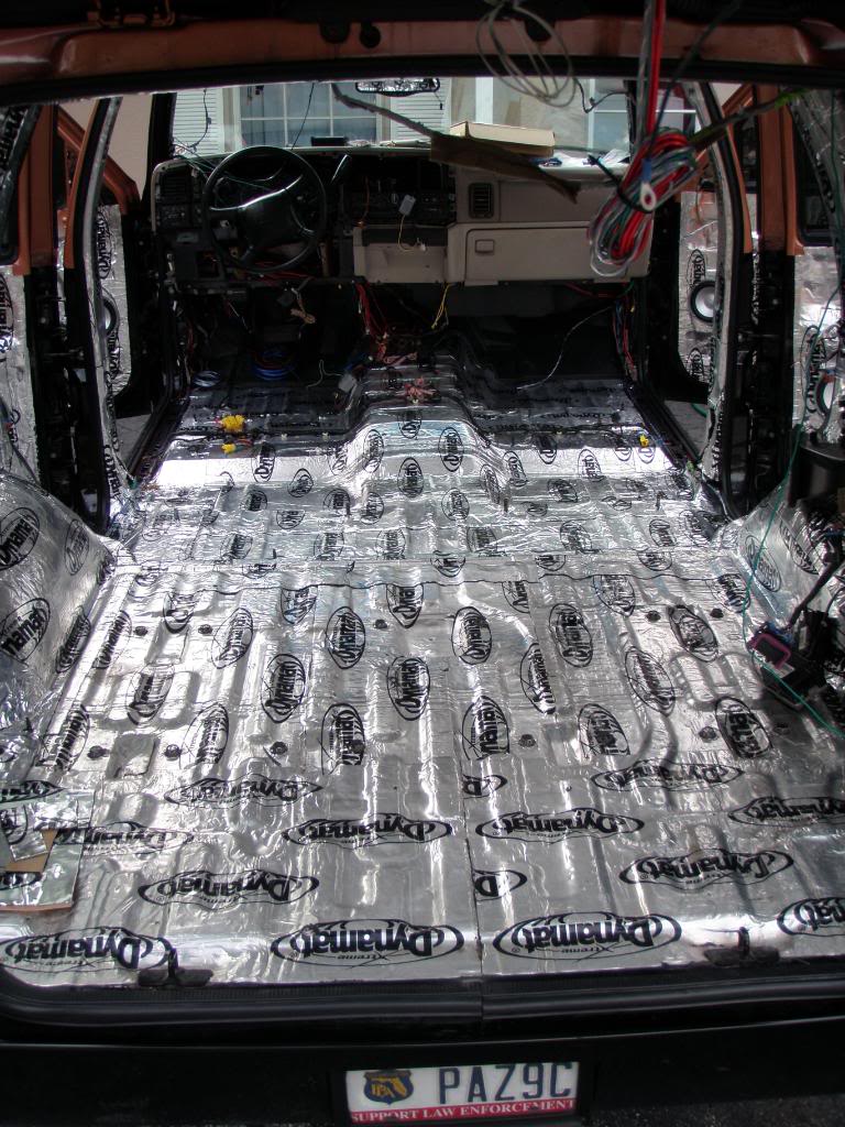

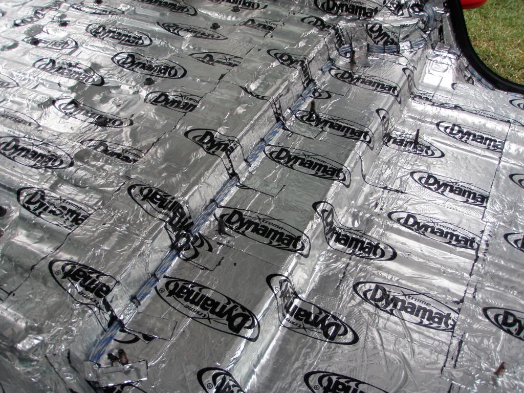

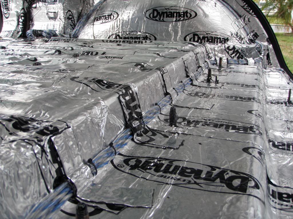

Well, Storm clouds are moving in but I was able to finish up the door wireing, and running the wires neatly accross the cabin. I was also able to run the two 8 gauge wires along with a video and power wire for the rear view camera through the rear hatch boot.
I used strips of dynamat to keep the multible speaker wires tucked together flat, So I don't run into any clearence issues when all the panels and carpet go back. I ran everything to the rear driver's side wheel well, that is where I will buld a custom sub box & amp racks using the stock plastic panel & a bunch of fiberglass...
