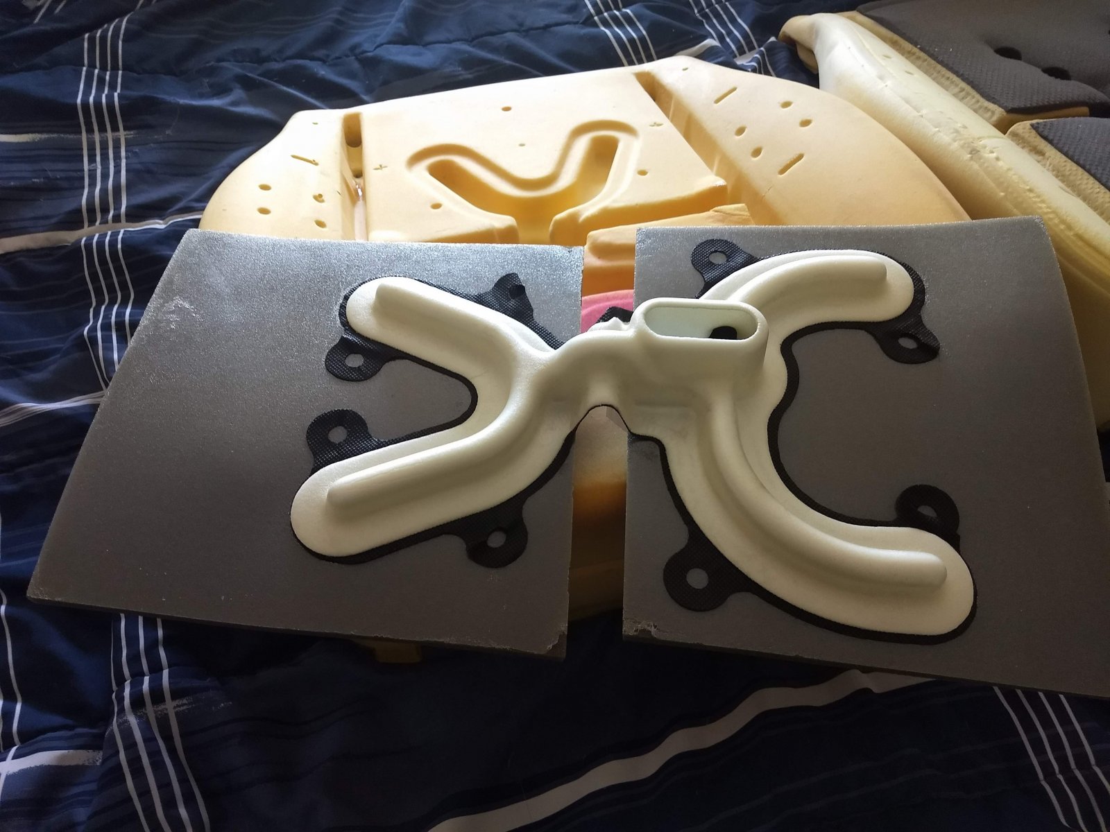

There are YouTube videos showing the internals of the early seats and where the ducts separate.
The ductwork is pretty flimsy and getting a bond between the tubing that separates is a challenge.

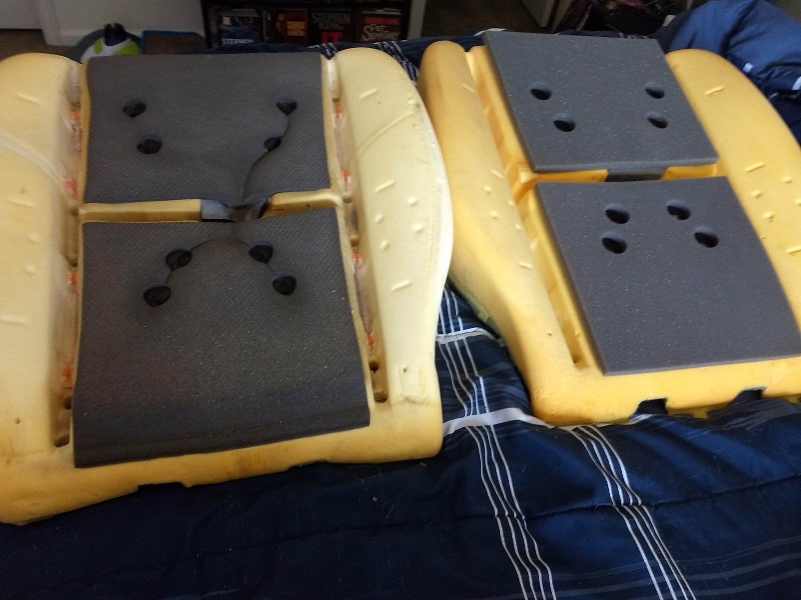

This is what my driver's side looked like, and I barely felt the cooled or heated feature on. Now that I replaced the cushion, it works great again.
