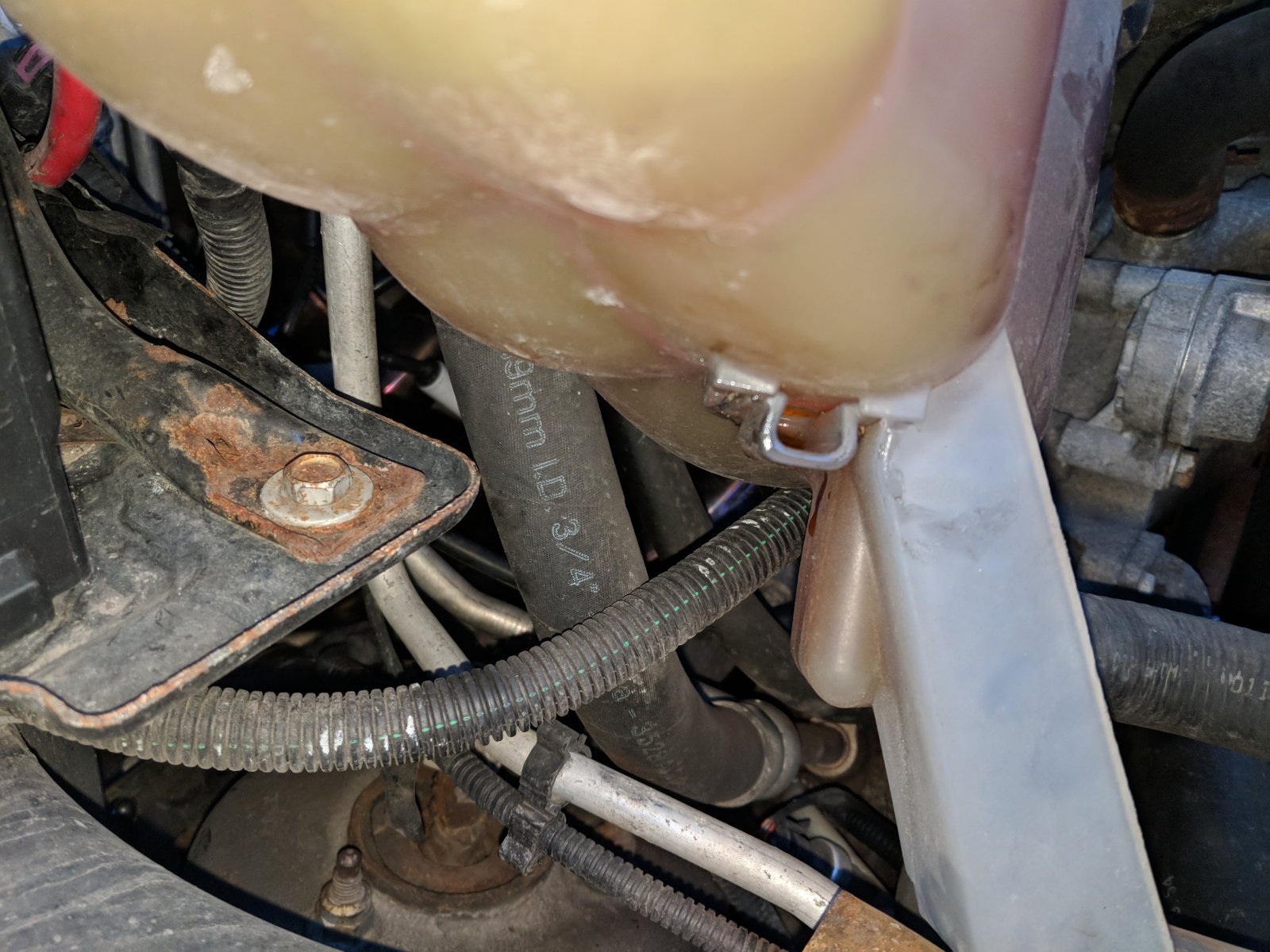

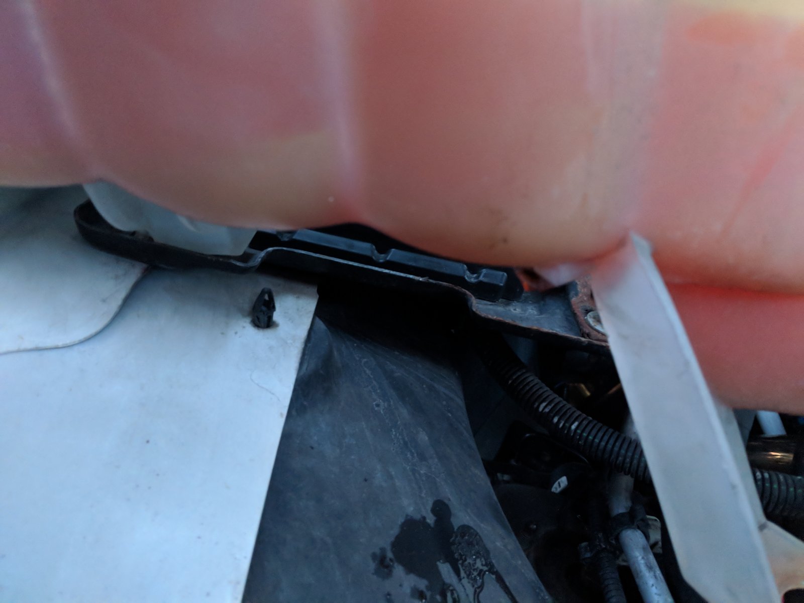

With my battery cable fiasco this morning, the drivers side headlight go burned out.
Picked up a new bulb at the dealer today and while installing it i moved the air box over and while getting my hands between air box and back of the head light bumped the coolant reservoir.
Thats when I notices a leak onto the fender well and down on the ground below.
Anyone ever seen this before? I called the local dealer and they have one in stock and I am going to pick one up at the end of day.

View attachment 219247 View attachment 219248
Its cracked? I cant see it?
97audia4
97audia4
Jun 19, 2018
208
190
There is that bottom piece almost looks like a clip has a week hole there and it's coming right out of that .
From what litmited information from a few dealer techs it's an internal pressure relief and they have seen the valve fail and start leaking
