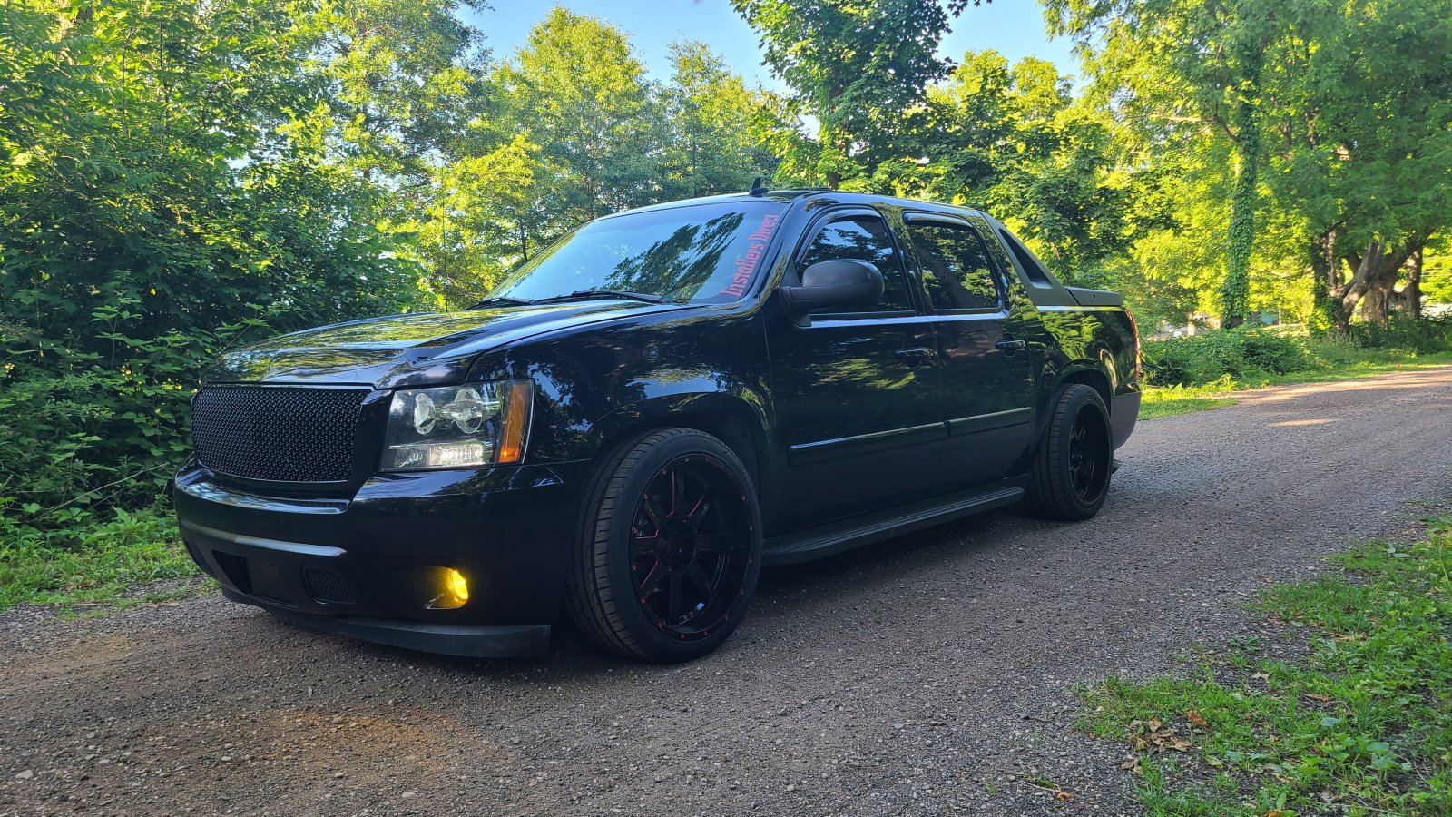

As the title suggests, are there aftermarket control arms for the lowered 4wd guys, like myself, to address ball joints angles on the upper and lower control arms? I haven't had any luck finding anything.
I'd like to go lower but not without correcting ball joint angles. Custom front axles might play a part as well but let's stick to the topic lol

Yes sir, it is a 1500. It is currently lowered with belltech adjustable struts in front set at max low. 4 inch springs in the rear with 1 coil cut out.
