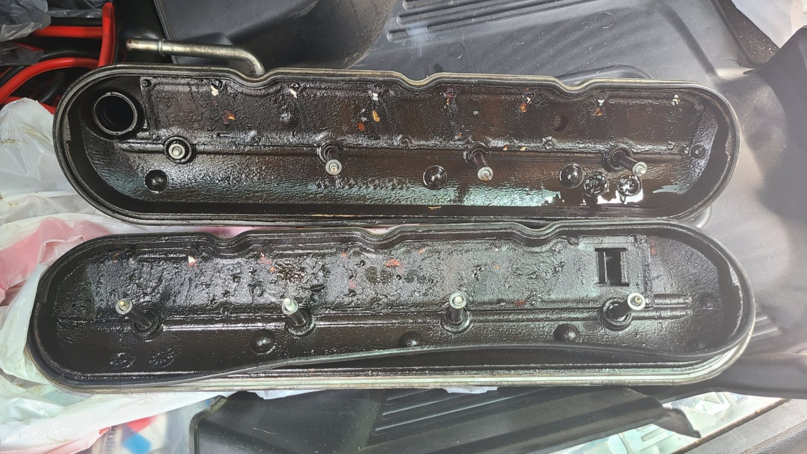

I'll check out the VLOM once I get in there regardless. I think I do have the updated one, after some more reading and comparing.
Valve cover pic, as requested, showing not-unexpected coating and varnishing. The passenger gasket looks halfway ok, but the driver-side one is cracked in a few places:

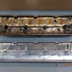

I would never but something in my engine to try and flush the gunk/crud out.
I would describe the gunk/crud in your valve cover, and thus everywhere in your engine, as bad or worse than average.
In Dec of 2018 I bought our Denali off a used car lot with 130k miles and no mx history. It was burning and leaking 1 qt of oil every 3000 miles. I have since figured out the why.
1) the design of the pvc system thats built into the original driver side valve cover was bad. GM came out with a new improved valve cover. GM # 12570427 for 2007-2008, and GM # 12642655 for 2009-2011. Read this GM technical service bulletin: https://f01.justanswer.com/ebrock63...il+Consumption,+MIL+ON,+Engine+Runs+Rough.pdf
The result of a not installing the new improved valve cover asap was that the engine began sucking oil from the valve cover and into the intake manifold and burning it, thus resulting in stuck rings. And a lack of crankcase vacuum caused the rear main seal to leak.
Engine has 175k miles today and doesn't consumer any oil.

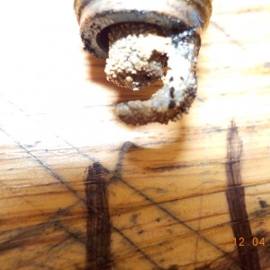

Here's what my neglected engine valve cover (top one) and all my spark plugs looked like. It had never ticked, missed or thrown a code.

Professor L Gee, based on the shape of the pvc inlet it appears you do have the updated driver side vc, lower of the two. But WOW they are a mess.
I cleaned those spark plugs in my media blast cabinet and ran them another 35k miles.
