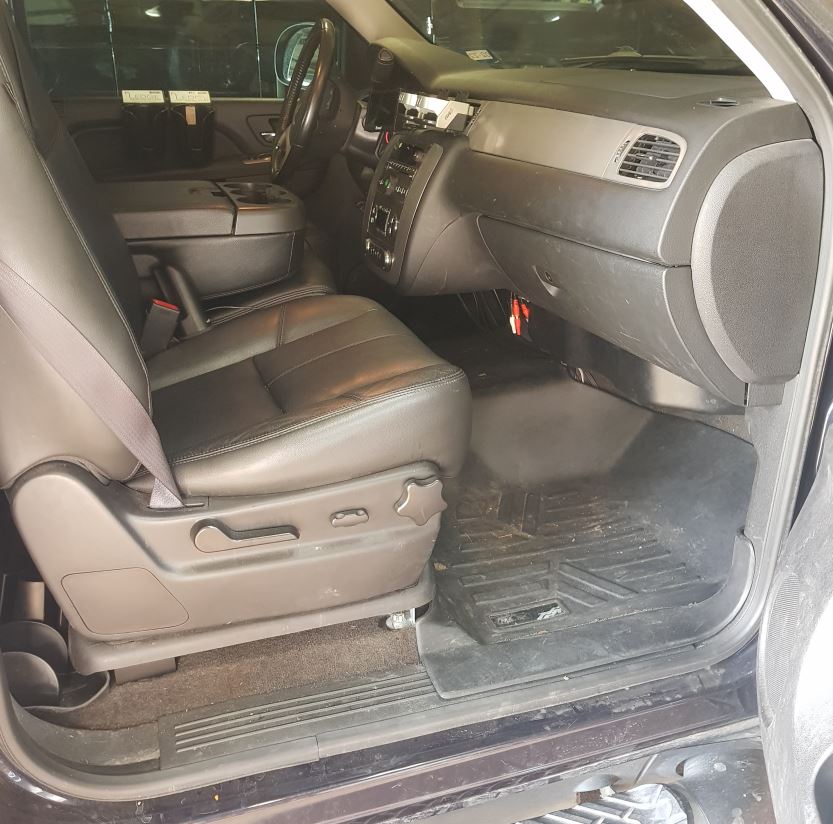

What's required to put a front split bench seat into a 2012 Tahoe?
I had a shop do it for me, but the middle jjmp seat has zero leg room.
Trucks don't seem to have the radio stick out so far it seems... anything else they might have messed up?

That’s how my 2010 is with the jump seat (though mine is a 15+), it has no leg room at all and would be completely useless for sitting in unless you straddled the hvac area.

I know this is an old thread, but I did this too (put a front bench jumpseat in my '13 LT). After a lot of research, I learned a '13 was the last year you could make this swap, because the in the next gen, the stock bucket driver's seat has an air bag in the right shoulder that would knock the middle passenger sideways or give him/her a head injury. Could not find someone to deactivate this airbag in the computer, and the computer barfs on swapping in an older driver seat without the airbag.

I've had a couple of years now with my 2013 LT Tahoe that I converted to front bench. It's been nice to have the kids be able to sit next to me.
The legroom is tiny, which appears to continue to be the case in the new generation, to the extent I'm considering buying a truck (which appear to have more legroom for the jumpseat).
Let me know if anyone has figured out how to increase the legroom (modify the HVAC area of the center lower dash), OR, if anyone has experience on the newer generation with front bench.

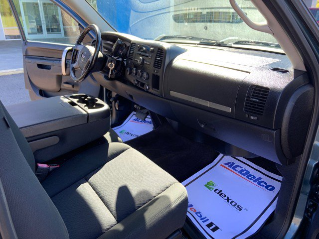

Trucks have more leg room because the hvac and radio are higher up and don’t hang down. My old nnbs truck had an extra pocket in the console up front under the dash vs my Tahoe.
