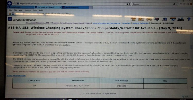

I think GM has a kit now that includes a new harness that makes it plug n play.
