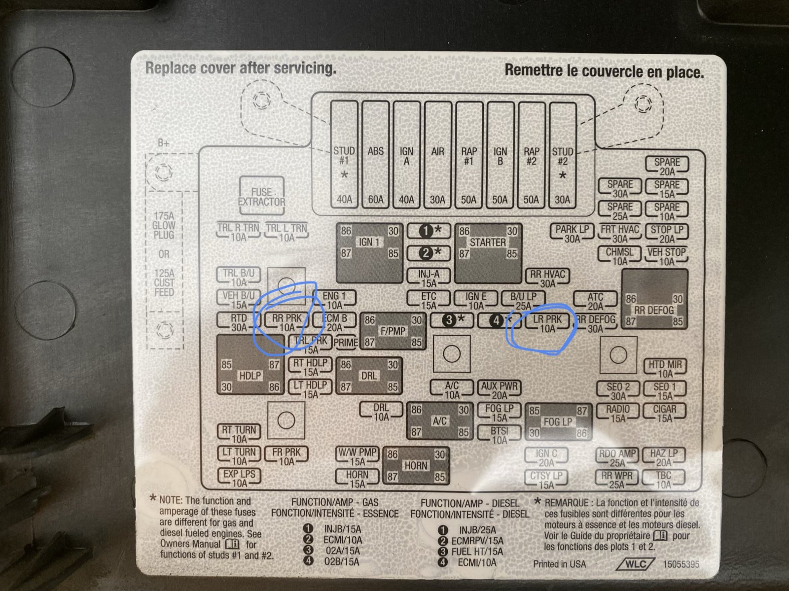

I would check the fuses and relays again there are several, underhood fuse box, drivers side dash fusebox, center fusebox

I got my (brake lights) to work
it was a 10A fuse under the hood labeled (vehicle stop)
Now i need to find the problem for my running lights in my taillights

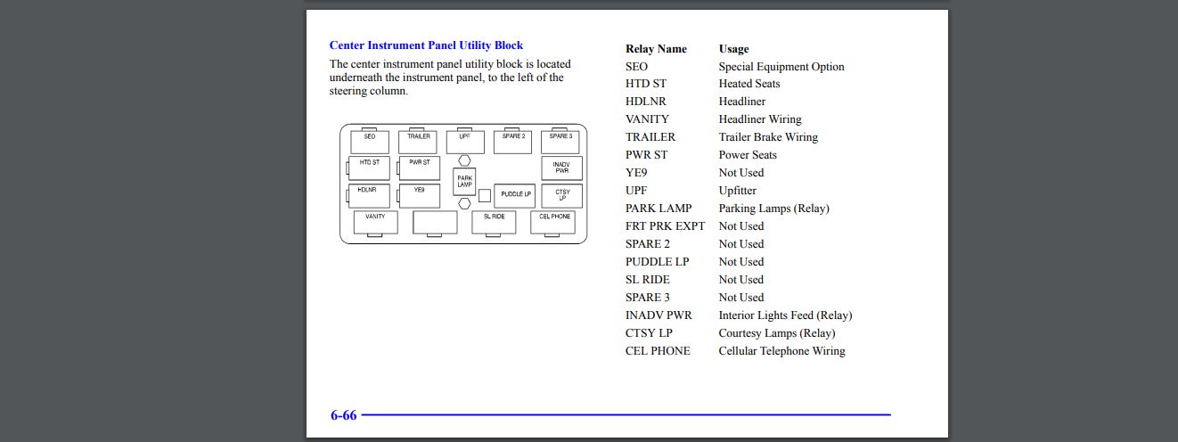

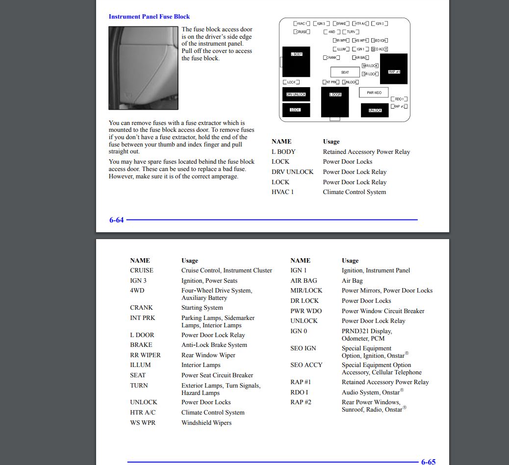

does anyone have a clue where the fuse would be for the license plate lights? since they’re out with the taillights too
30,698
48,335

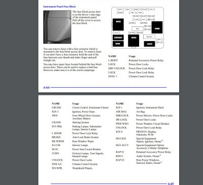

look in the owners manual, it shows all the fuses, if you do not have the owners manual you can view it online from the gm website for free, just like I posted the screenshots above, it will come up as the first google search
