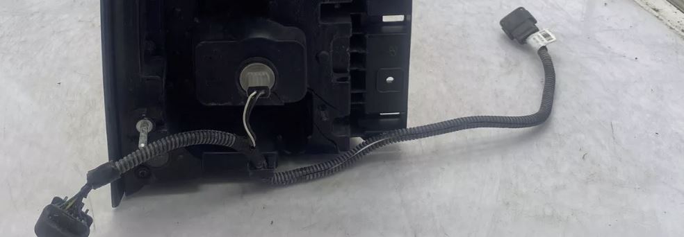

I have a 2020 Yukon SLT, and the rear passgenser tail light is not working. In the assembly there appears to be the brake light LED, the running light LED, the turn signal, and the backup light (with a regular bulb). So specifically, the running light LED is not working - everything else seems fine.

I have not had to mess with the k2 tail lights as of yet, but
are you able to take the left/right and switch them (without mounting them) just plug them in? and see if you get the same results?
from pictures it looks like there is the typical short harness from the main body harness up to the housing you may want to check the lower end where it is exposed to the elements.
and each wire you could check with a meter

Thanks, I will try to check each wire with a multi-meter. I didn't think of swapping the left and right light assemblies. I can try that too.
I checked each wire in the harness, and the green and yellow wires were showing zero voltage. I didn't have the backup light on, so it looks like the green wire is the culprit.
So, now I know the problem is happening somewhere before the wiring harness. Not sure there is much else I can do though?
just have to trace it back or patch in the running light from the other side
