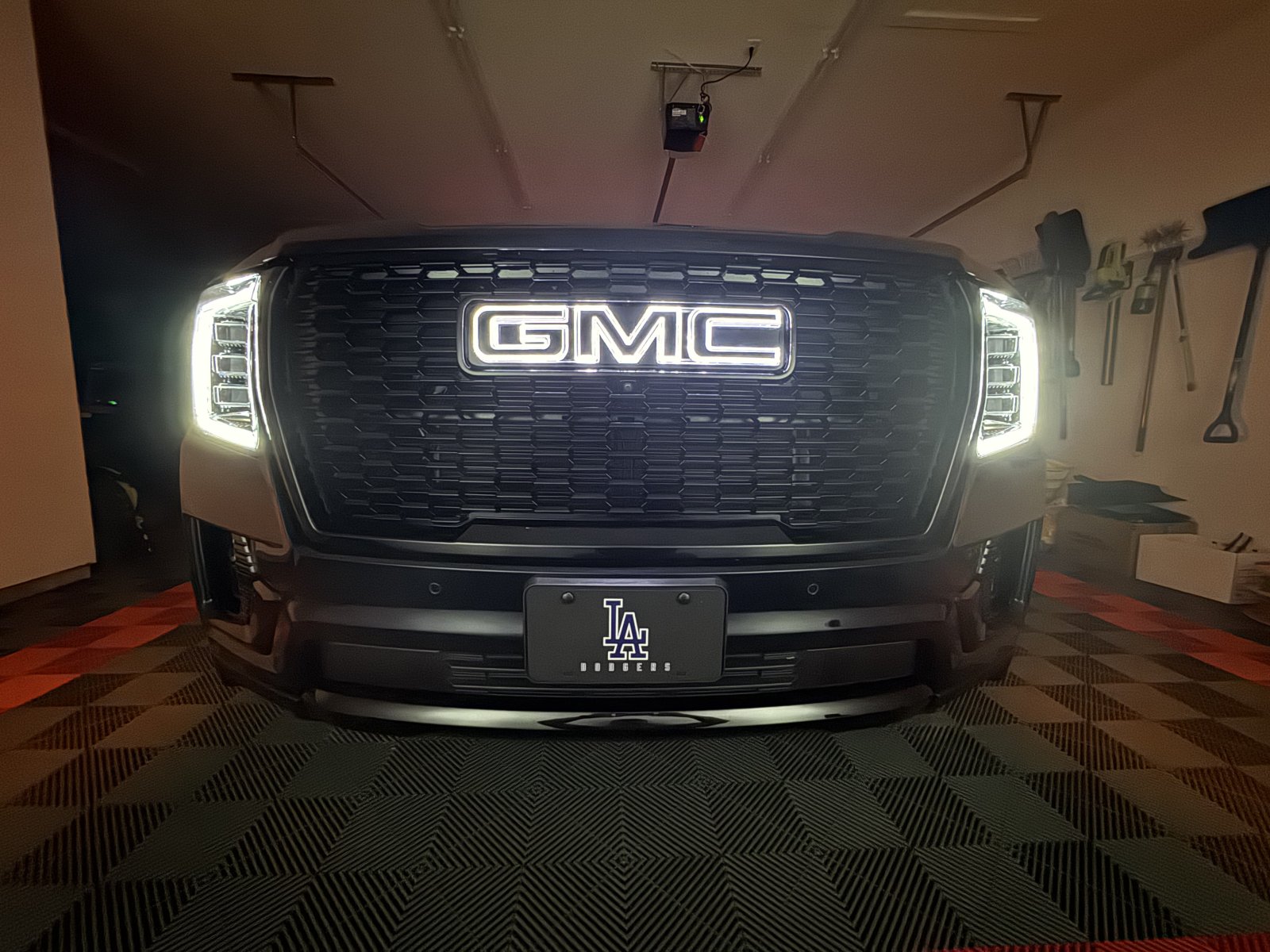

Got mine installed. My version connects in-line with the drivers side side maker.
