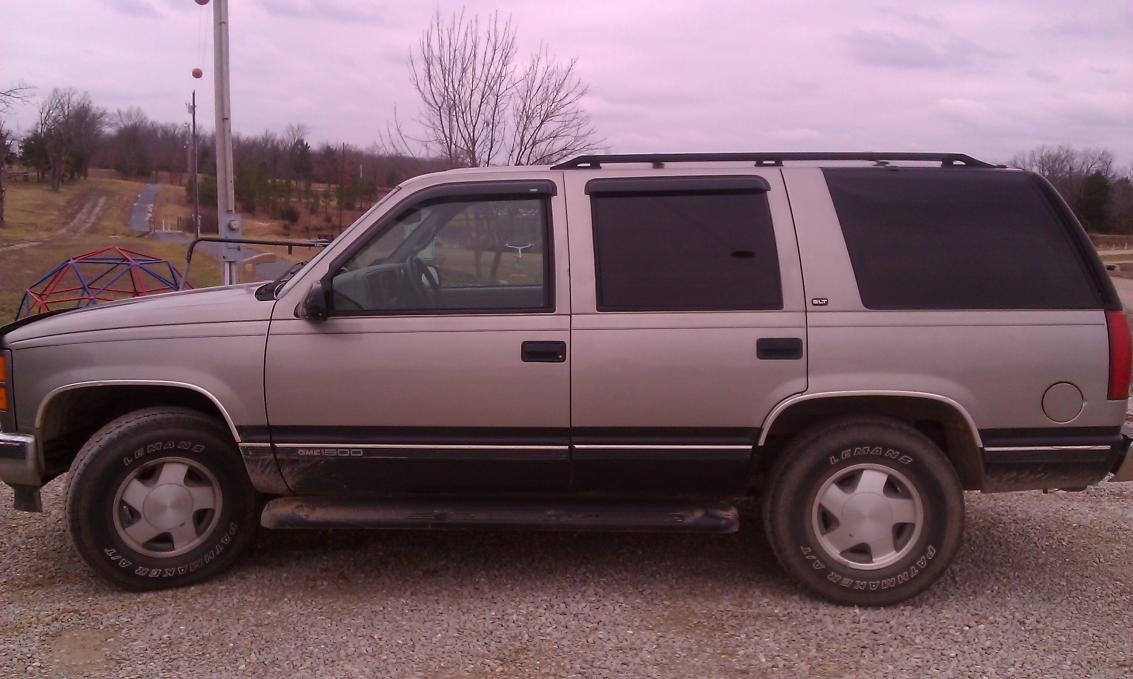

I'll have to wait for some brake pics until the ground is dry again, but here is a pic from the side

unknown at this time.
from first look that does not look like i police package.
---------- Post added at 07:52 PM ---------- Previous post was at 07:51 PM ----------
but more pics are needed. and if 4x4 you should have 6x5.5 hubs with 11" rear drums.

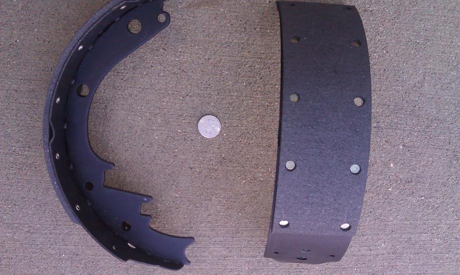

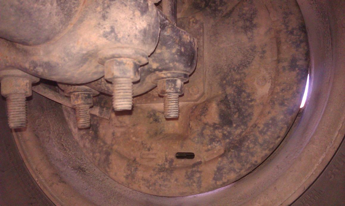

Here's a few pics of the rear brakes. They are eleven inch drums. I also just found out that I have an exhaust leak, courtesy of a dime-sized hole in the muffler. Are all of these things equipped with a 2to1 muffler the size of a duffle bag?
Also, is there a chance that AutoZone and O'Reilly's might just have the parts incorrectly categorized? How many other Yukons and Tahoes have 11 inch drums?

Because it is a 1999 yes it is likely mis categorized. And yes vortec engines are 2-1 duffel bags.
---------- Post added at 02:31 PM ---------- Previous post was at 02:28 PM ----------
All 4 Dr tahoes have 11". 2 dr bodies have 10" rear brakes.
