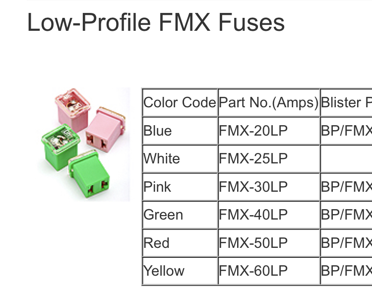

So having trouble with compressor not turning on. first thing I check is the fuse #58 J block. Went to pick up a spare and there is 2 types , FLS and FMX and are not interchangeable. Also, there is a low profile version. I'm sure this isn't the problem but I wanted to remove the fuse anyway just for the hell of it. Fuse is stuck bad and the plastic is breaking all over the place. I know I can get it out but want to have a new one on hand. Would anyone know which of the three types mentioned will fit this so I can have it on hand. Thanks in advance, Jim.

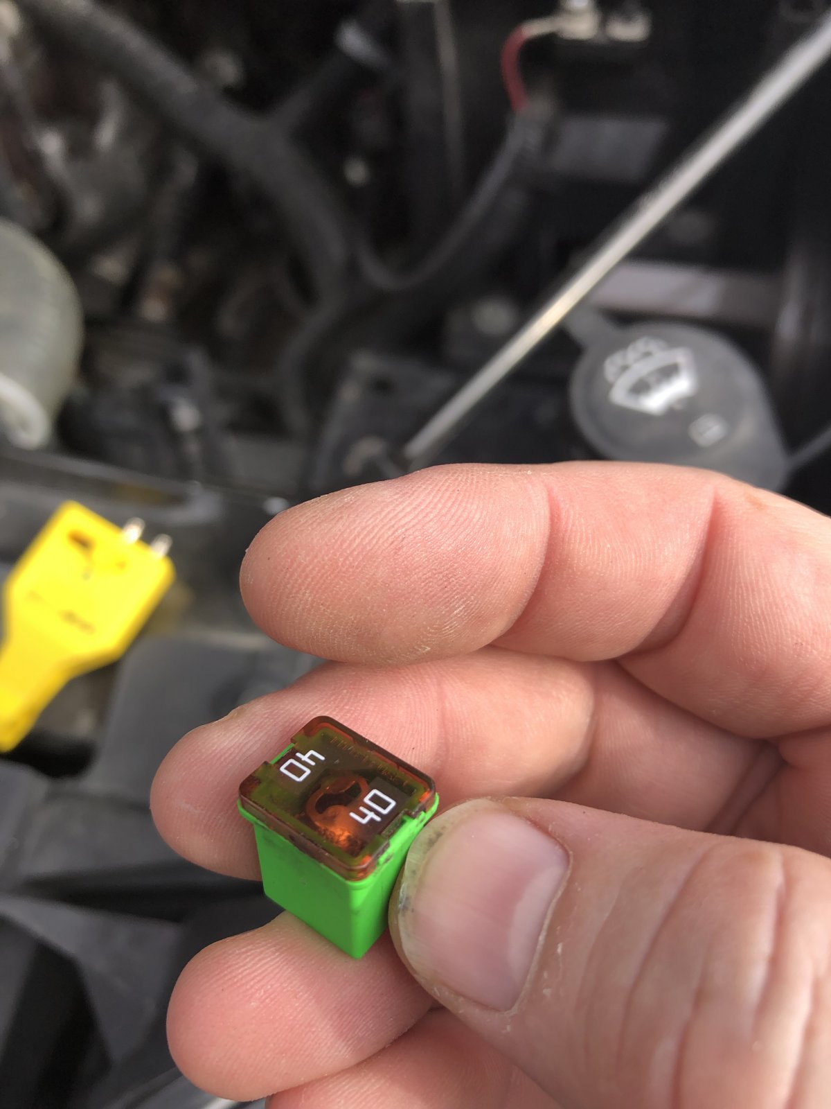

I believe you need a FMX (Female ****) low-profile.
Here is the 40A out of my 2013.

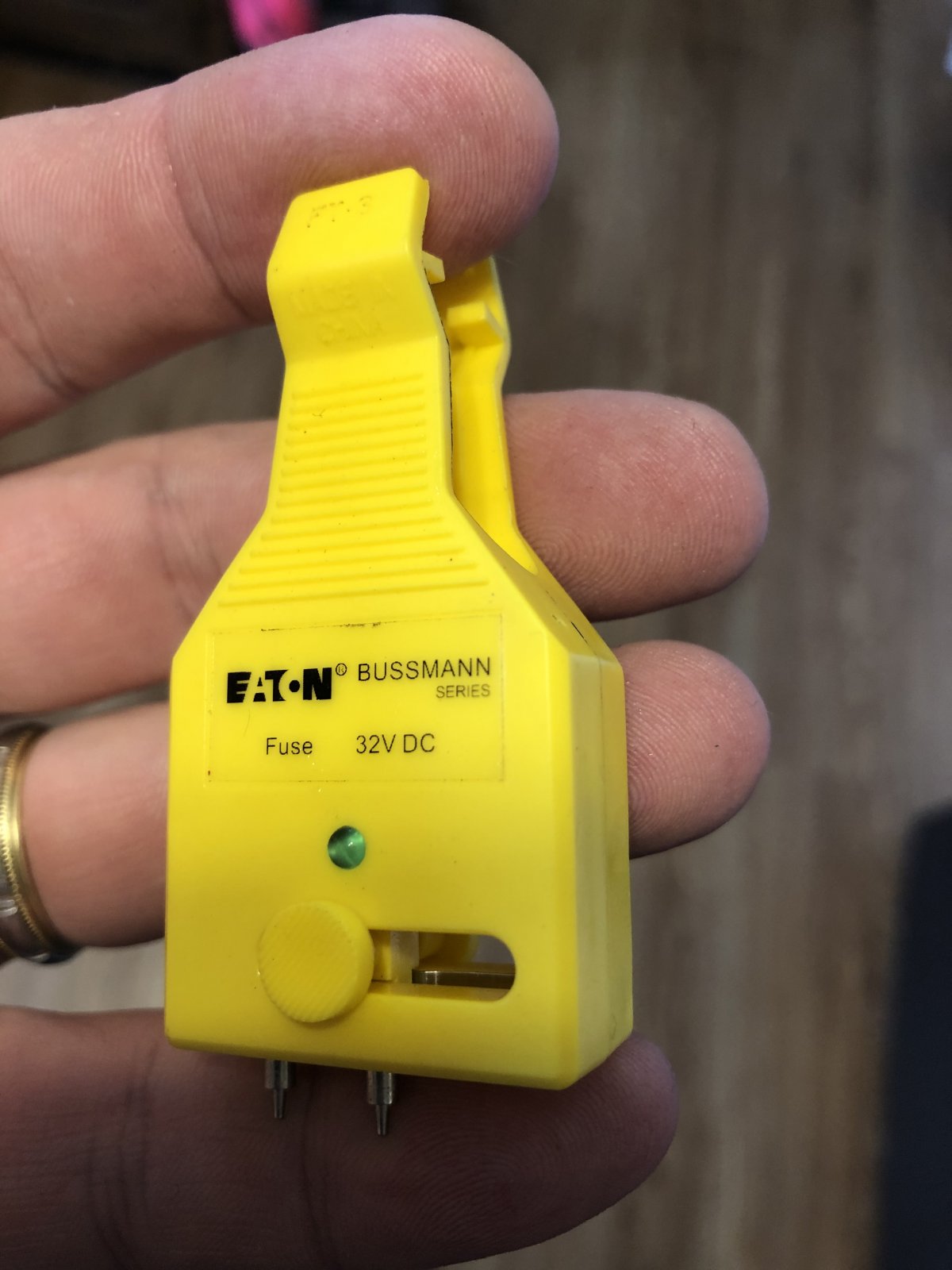

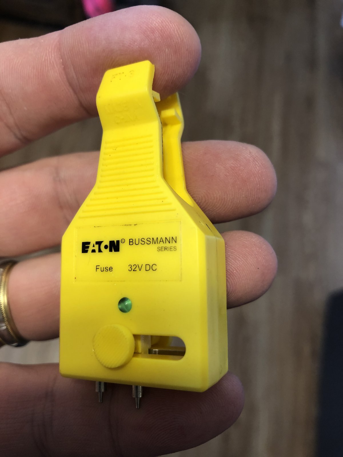

I have found this little tool to be very helpful for pulling fuses instead of using a needle nose pliers.

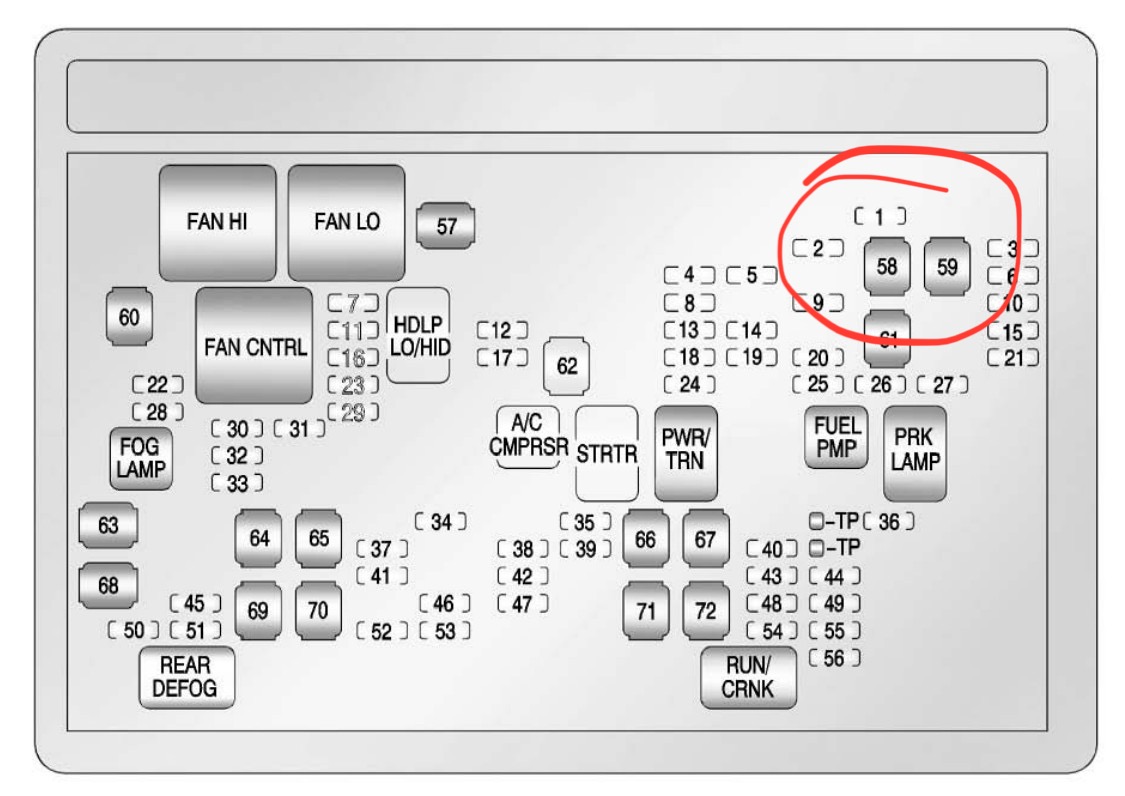

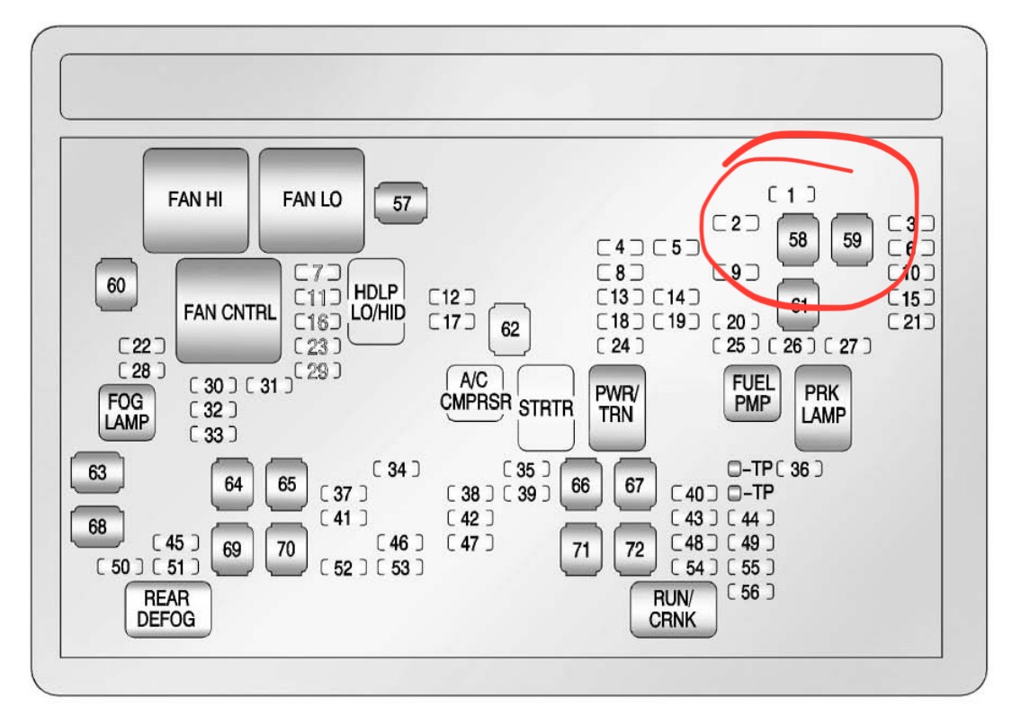

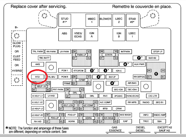

I found the #58...but exactly where is this one.
I’m not 100% sure i understand what you are asking.
You say you found #58 but are wondering where it is.
The fuse in my hand in the photo is fuse #58. It I located in the fuse block under the hood on the drivers side fender.

Aha...I see the confusion = mine is a 2005, that's why mine looks different. I think mine is called a RTD (Ride Control). It's a 30A and looks good...sooo...on to the compressor.
