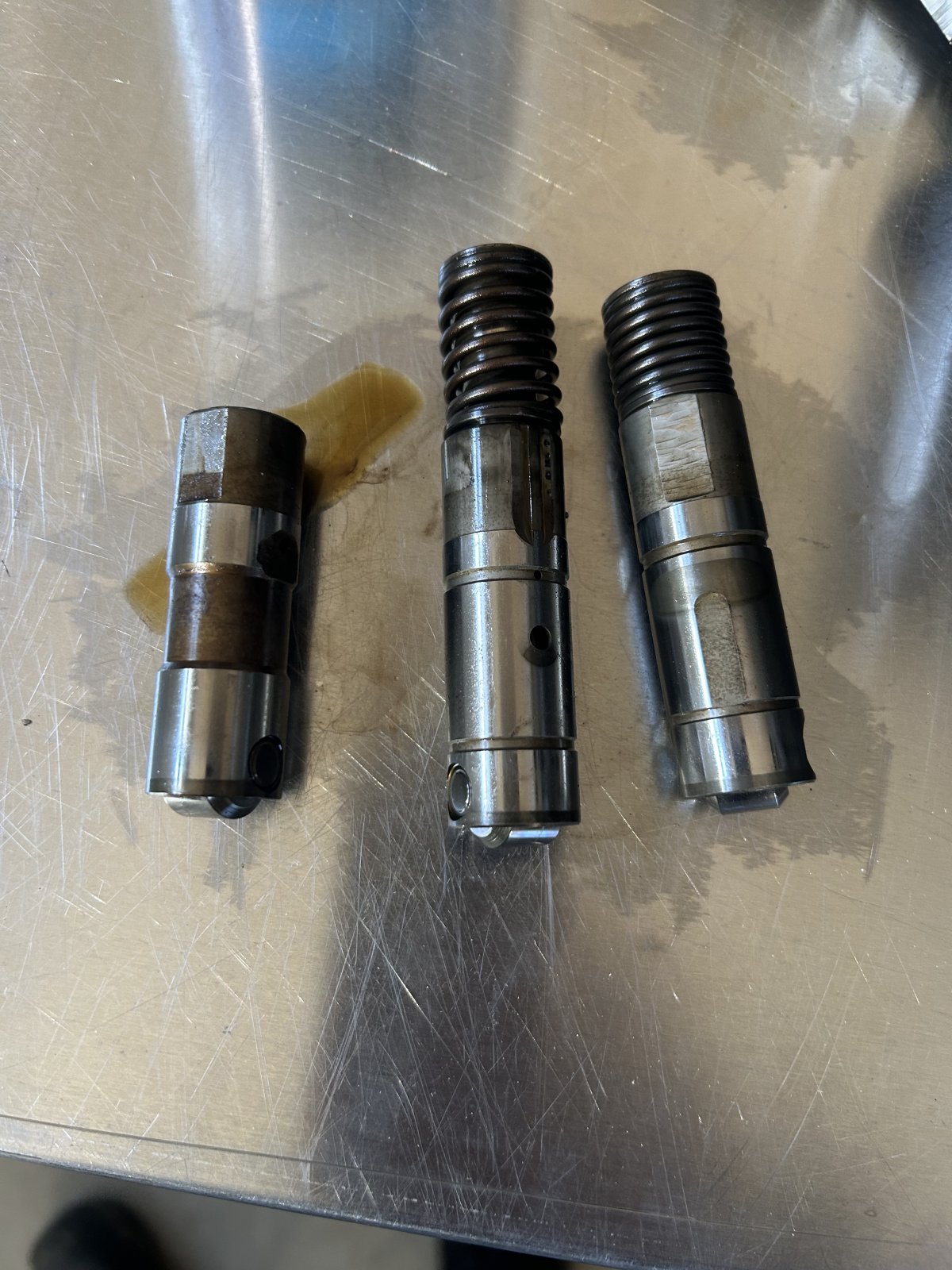

Collapsed lifter

I pray everyday mine does not go out especially when I am on a long trip like right now. I am at 186K miles and have no plans to buy another vehicle anytime soon.

I hope you are doing the DOD\AFM cam delete - new cam, lifters and pushrods without that crappy spring. Cause then you are good to 600k on that motor. If you are planning any power adders, I would get an upsized fuel lobe on the cam as well.
