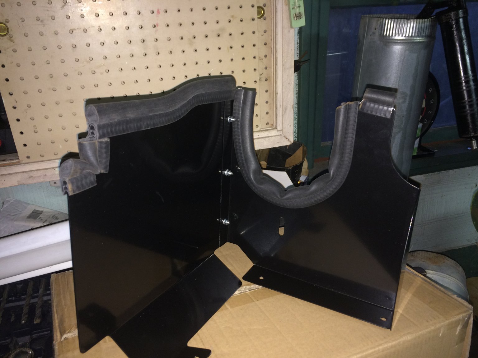

I bought this one just after you posted it. Will be in Tuesday. $120 cdn with shipping. Exchange still sucks ! And customs charges suck !
But I get a new toy :chewie:
I will let you guys know what I think about it when I get it on.

Nice & thick steel
Looks like it will seal up good
More pics of the kit. I would have it on tonight but the wife took the keys !!!!
For what it is. I am extremely happy with it. May have to paint the tube black tho. It's the only Chrome on the whole truck !
