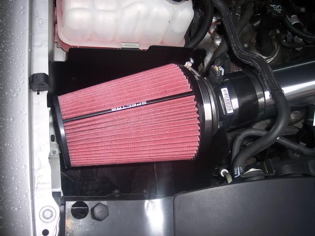

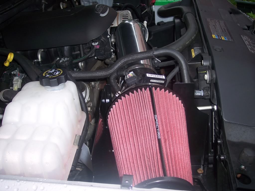

i just got it this morning and installed it before work. it took about 40 minutes, the instructions were not the best but adequate enough to get it done. everything bolted up with no problems. it looks great and also sounds great. it`s not too noisy until you mash the pedal, then it roars but i think it sounds really good and throttle response is much improved. and like i`ve read from other guys that have cai`s i think my exhaust sounds a little louder/throatier.
i searched around for what power gains the spectre cai were before i purchased it and they said on a 5.3 tahoe they gained 17hp at around 5400 rpm and 16 ft pounds of torque at around 4700 if i remember correctly.
i`ll post up some pictures tomorrow morning.
correction, the gains i said were wrong. they claim 13 horsepower and 12 ft lbs of torque.

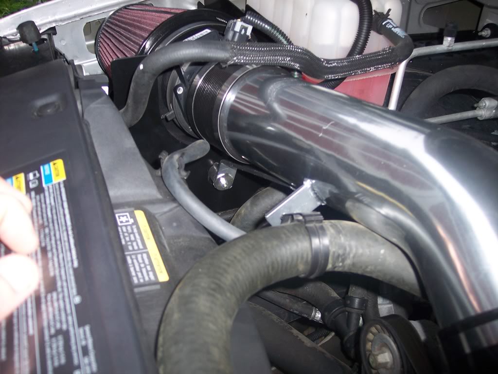

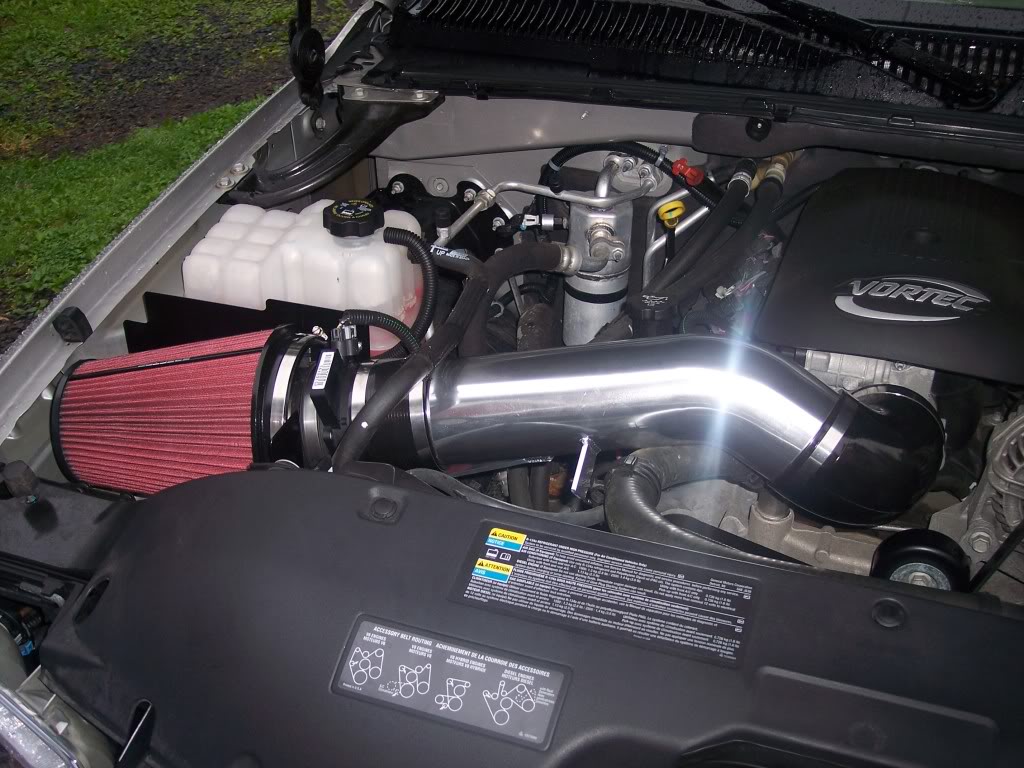

here`s the pics......
i forgot to add that this is kit #9900 it fits the older models with regualr fans too. i just installed one on my friends 04 silverado ss and it fit perfectly around the shroud.

I have the same intake (for about a year now). Did you have to bend down the piece from the intake that mounts on the isolator. Mine never did line up and so it just sits on top of the isolator (not bolted to it).
I plan on wrapping mine with some exhaust wrap. It holds a lot of heat and lays across or near too many radiator hoses for my liking.
