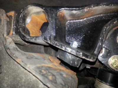

I know it seems like it wont do much, but giving a little cushion so it isnt metal on metal will definitely help, and keeping the shock from hitting rock bottom will avoid damage to the (expensive) hardware
Heres a pic of my setup, so others can see. If the stud top pans out, ill most likely trim the bumpstop a little more... as you can see, I already hacked it up pretty good and still have minimal room
