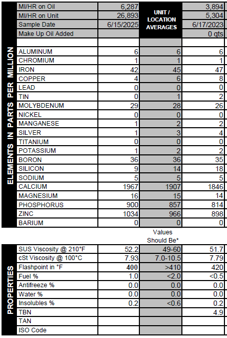

Here's the two UOA I've done - first sample is on the right, most recent sample on the left. I have a '22 LM2.
