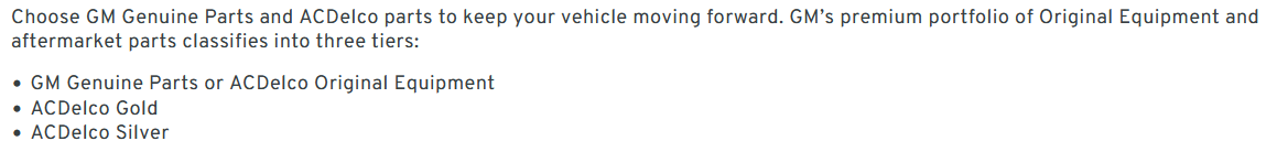

Your best bet is to first find the "GM Genuine part" or "ACDelco Original Equipment" wording. While that part could be made by Delphi, AC Delco, or another manufacturer, it's what came on your truck. Should be worded like this one from RockAuto:
From the GMParts.com website (ranked in order of quality):
ACDelco has one more line, "ACDelco Advantage" but that's like any other aftermarket parts line, a crap shoot at best. Avoid it if possible.
