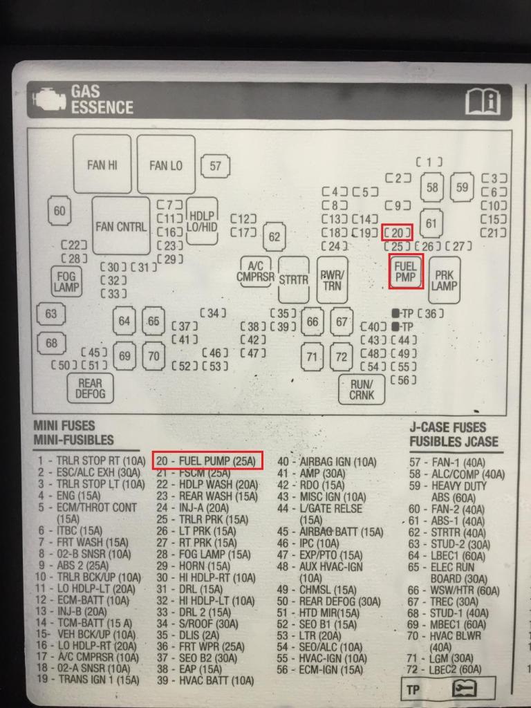

2. start the engine and pull the Fuel pump fuse and let the engine run out of gas. Guess what.. THERE ISN'T ONE! Below is the fuse block diagram

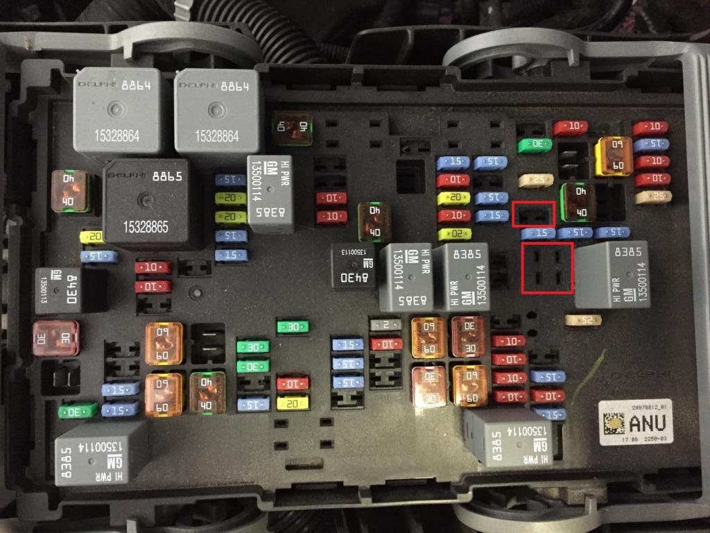

Here is the actual Fuse block
2014 GMC Yukon XL 4WD
Note: THERE ARE NO FUEL PUMP FUSES! I guess GM decided to create a fuel pump relay that is under the spare tire somewhere (TLDR) and thats where the magic happens.

"check the fuses labeled, FSCM and ECM-IGN in the under hood fuse block, those are the ones that run the fuel pump. "
So after that I decided to test out the theory, started the engine and pulled the FSCM Fuse and after about 3 seconds the engine slowed down and stopped running. (which I assumed it ran out of fuel)
