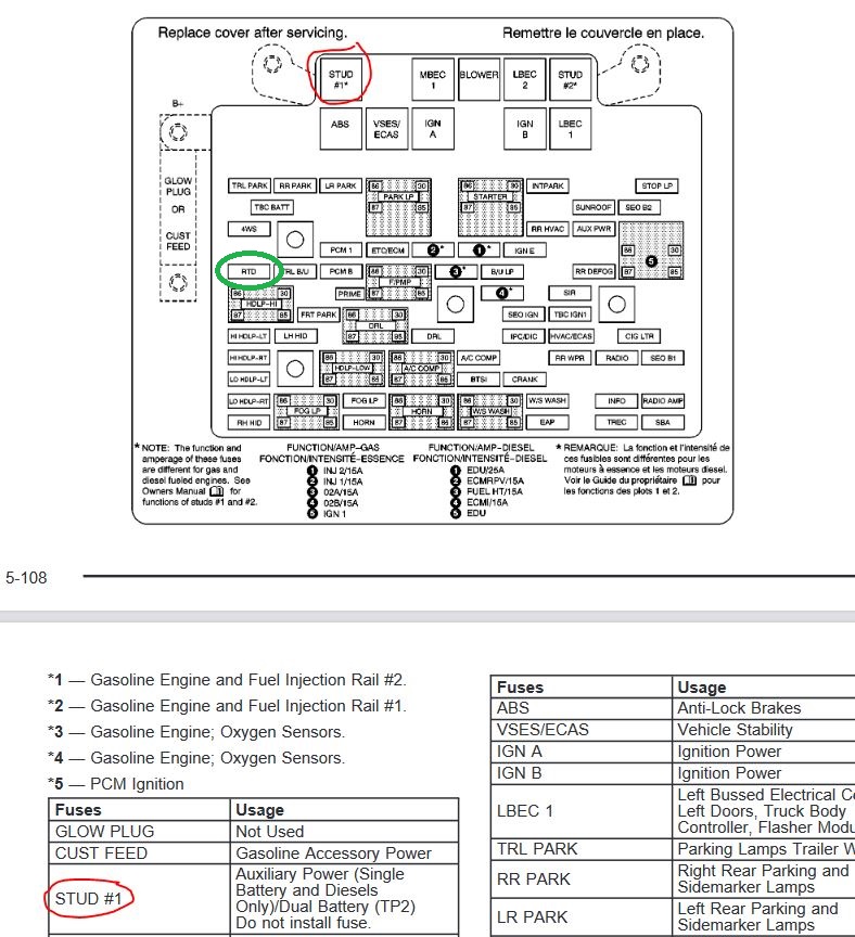

Stud #1 is for the trailer; not necessary unless you are towing and need to send auxiliary power to the trailer.
RTD is ride control (green oval in graphic).
As @OR VietVet indicated, a thorough check of all other fuses is in order.
