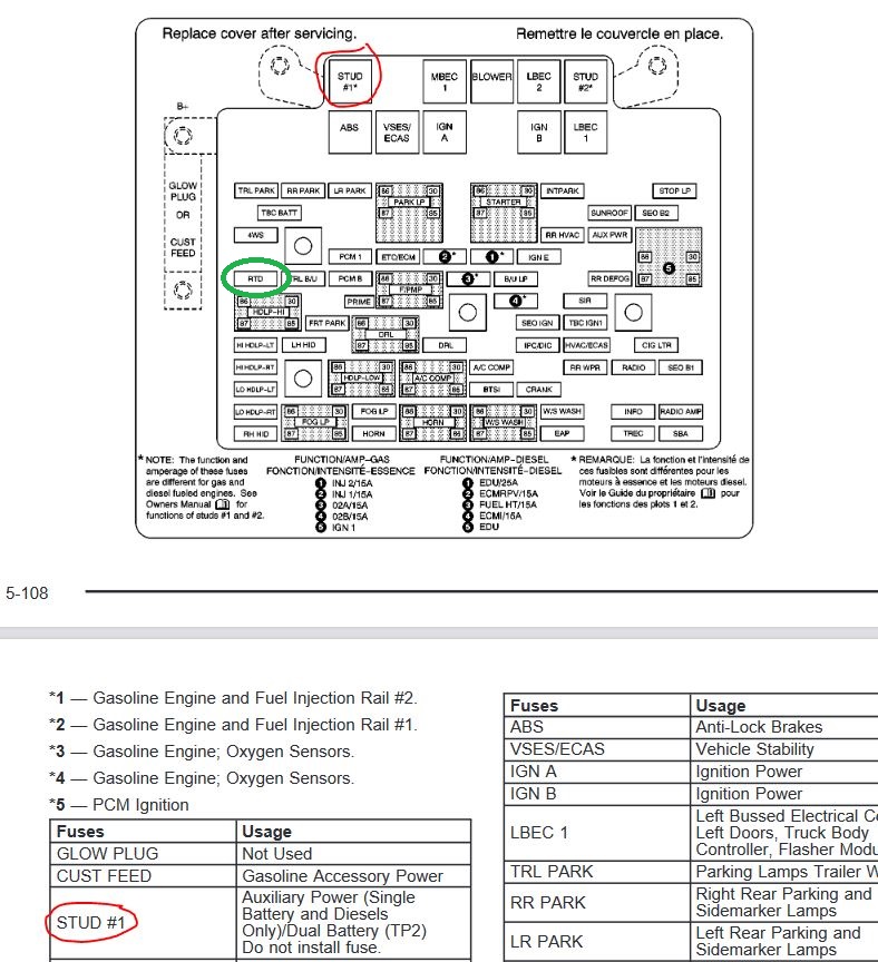

Stud #1 is for the trailer; not necessary unless you are towing and need to send auxiliary power to the trailer.
RTD is ride control (green oval in graphic).
As @OR VietVet indicated, a thorough check of all other fuses is in order.

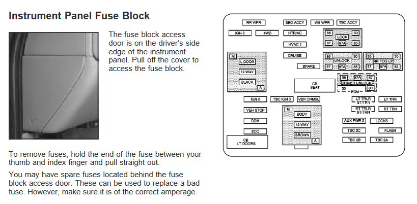

Here's a link to your owner's manual. It shows all the fuse locations.
There are several ignition-related fuses in the Instrument Panel Fuse Block:
Thanks I'll check them again in the morning before I tear everything back apart. What a nightmare. Was just trying to fix my daughters car for her and now I got a real mess going.
