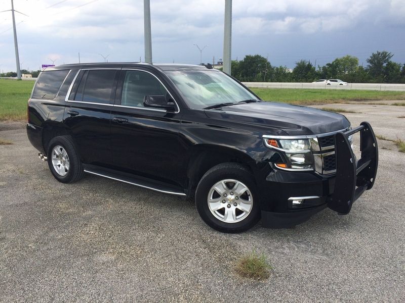

As delivered:

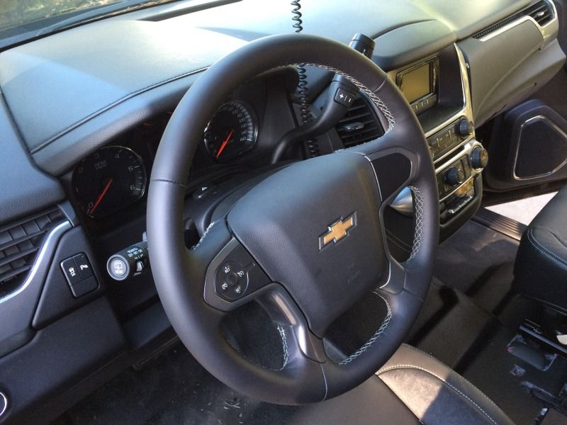

1st order of business was the simple stiff like 17" alloy wheels, tow hitch cover and LTZ leather steering wheel upgrade:
The phone/DIC control pad was removed for now. I may put it back in the future.

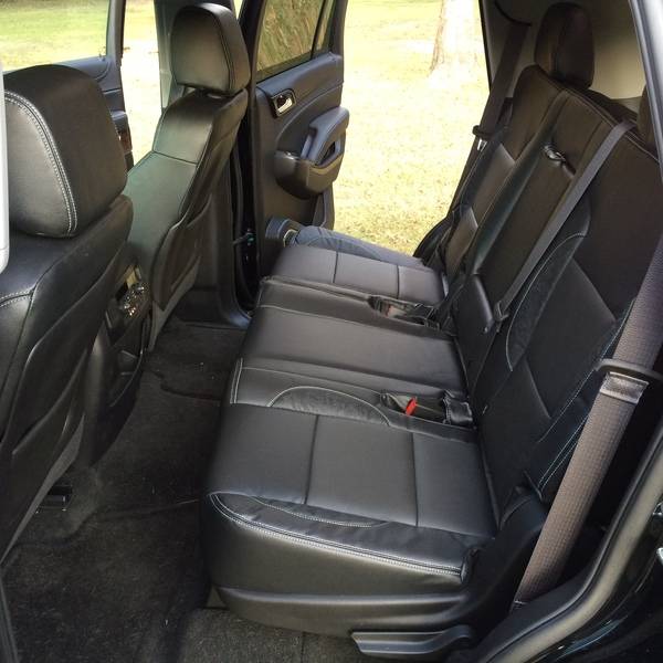

2nd was the Katskinz Leather seat upgrade:
The skins where labeled as "Bucket Seat", but they fit the Bench seats as they appear to be identical to the buckets except for the inboard airbag on the drivers seat back. The job was a simple Saturday morning DIY project. Not hard at all. Just be sure to disconnect the batteries to disable the seat airbags.

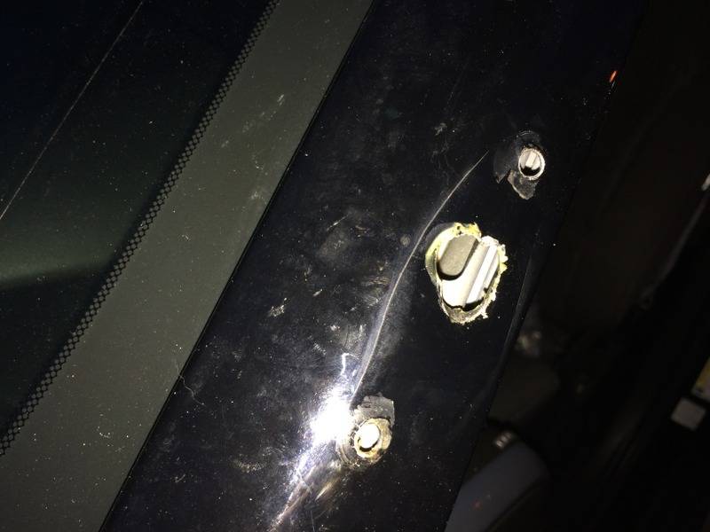

Then the spot light came off - I must say, for an OEM RPO option the installation is very poor - It is not up to OEM standards, it is more like shade tree hack job. Look how rough the holes look like.
My local bodywork guy will weld in a patch and paint the a-pillar to clean everything up.

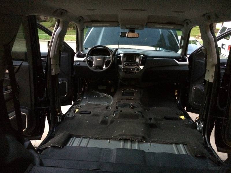

Next up, was the LTZ carpet install upgrade:
Removing the PPV rubber floor was a simple matter of gutting the interior, replacing with GM OEM carpets and reinstalling the seats and trim. It was a simple because using OEM carpets rather than "exact fit aftermarket" carpets means no cutting or trimming needed.
Rubber Floor
Naked Floor
Carpeted floor

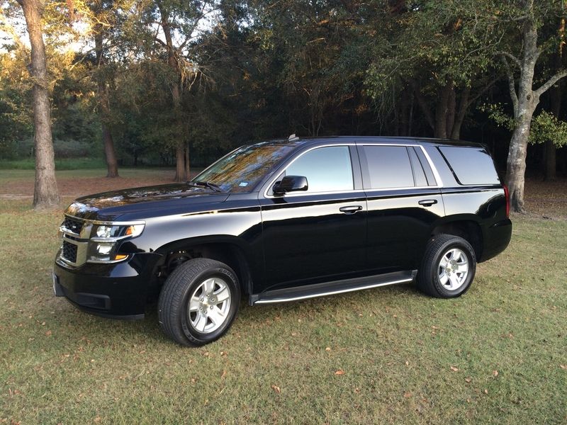

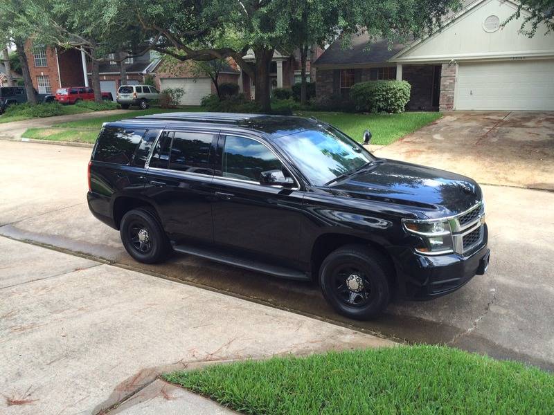

Well, we have made great progress with the truck.

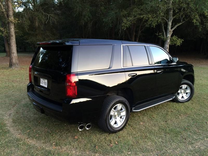

Almost all the exterior mods are done now, save for the LTZ chrome trimmed rear bumper cover (FedEx broke the last one delivered and I am waiting on a replacement), extended front lower valance trim and the front fog light chrome eyebrows.

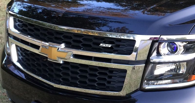

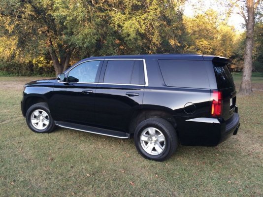

Exterior mods have been limited to chrome trim LTZ running boards, alloy 17" wheels and SS grill badge - a little hint at the coming power upgrade - either supercharger or 6.2 transplant. The rear total blacked out debadged look will stay.

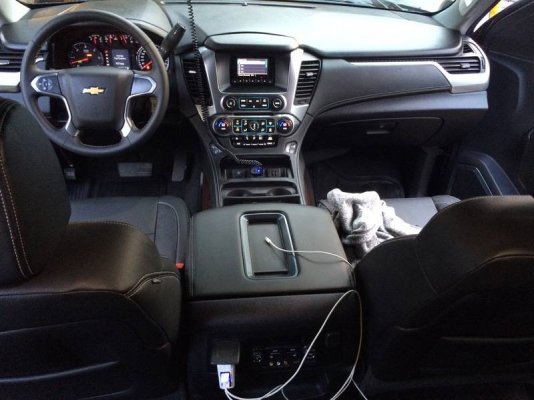

Interior mods are also well on their way - the remaining major hurdles are the correct component choices for managing the upgrade to IO6 popup nav & integrating the center consol controls and accessories that as yet are not wire up.
Leather wheel upgrade with radio/phone controls removed.
Katskins front and rear seat leather treatment, retail LTZ center console with transplanted matching wood trim.

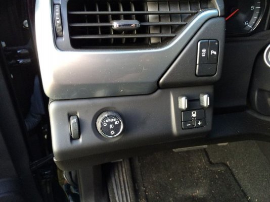

Max towing package trailer brake controls with appropriate trim panel - just need to get the option activated now. The plug is present and appears to be fully wired up.

As for the SS badge, the PPV already provides SS badge worthy handling, the idea is to back the handling up with either a supercharger on the 5.3 or a 6.2 transplant taken care of by Englandgreen here in Houston. GM really needs to sell the handling and HD upgrades of the PPV to the civilian market - there was no way I was going to buy a regular wallowy roll-over inclined SUV, but something that has the ability to safely stop and turn (and haul ass like a big super sedan biggrin.png FIREdevil.gif ) is a different story. GM really needs to sell a proper SS handling package enhanced Tahoe - so until they do, I am happy to build my own.
The badge itself is the 2010 through 2014 Camaro front SS badge and mount bracket. With a little cutting of the mount and a dab of epoxy it fits like an RPO option badge.

I. LOVE. THIS . TRUCK.
I like how stable and sure footed it is. No wallowing, it stops hard and it is a hoot on the freeway. The ride is harsher than an LS, LT or LTZ but I enjoy my Corvette as well so a stiffer ride does not bother me. The Katzkinz seats are comfortable and have been easy to keep clean. The fitted GM carpet has not moved or shifted or had any issues.

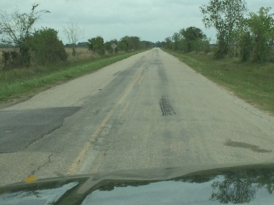

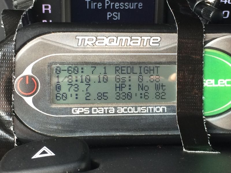

We finally went and did some performance testing out in the boonies - sadly we did not do the same thing before the mods, so no comparison numbers, but in its current form, for a 5300# 4 door 6 passenger SUV I think this truck hauls ass smile.png
I am glad I was able to buy this PPV, and would recommend anyone else who has the chance to buy a low mileage supervisor lease return or demo unit to jump at the chance Chevy_anim.gif cheers.gif
Mods are Volant cold air, Corsa touring cat back and a tank full of e85 and stock 3.08 rear gear. The runs where made in Competitive Mode i.e. Active Handling On, Traction Control Off.
Conditions: Overcast 98% humidity & 78*F
Best Result
6.8s 0-60
15s 1/4 mile @ 94mph - on a farm road smile.png
The Numbers
The Track
The worst result
7.1s 0-60
10.10s 1/8 mile @ 73.8mph
But you can see it is pretty consistent - these 2 1/8 mile runs are 2 of 6 that where 7.1s dead even.

Made the last few cosmetic changes.
LTZ rear bumper step cover.
Chrome LTZ fog light eye brows and fog lights.
Black anti-deer-at-night bars.
LTZ front bumper valance.
I think the truck now looks the part. Semi-blacked out with a touch of dazzle smile.png
