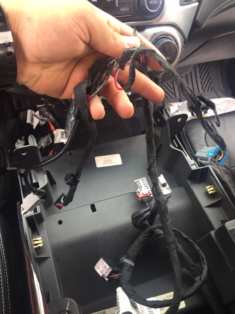

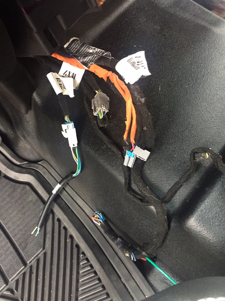

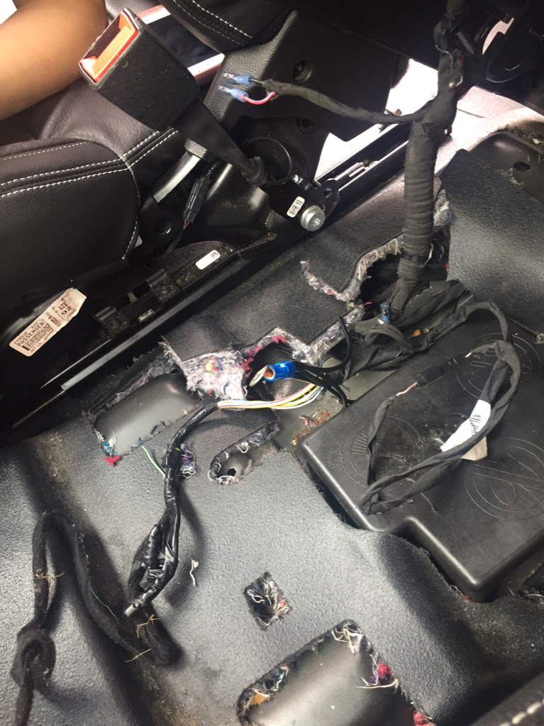

Do you by any chance remember how the wiring was for your center console? Here's my situation. Seems like wires were cut while changing this over to a squad car and I can't seem to figure it out. Any help would be appreciated.

I ended up using the lighter and USB already supplied in ppv trucks. Ppv trucks have a different wiring harnesss (gmupfitter harness). So the outlet, climate control etc don't work in the rear. Sucks but I'm no electrical guru to figure this all out.
What I did was extend the PPV USB to the USB in the center console and the 110V power outlet to the 110V power outlet on the rear of the center console.
My 110v had no power for some reason, I was fed up with the whole thing to figure out why
Taking the 110V outlet from the front to the rear??? I know it's those two orange cables. Is there an extension cable or did you or an electrician make it happen??
