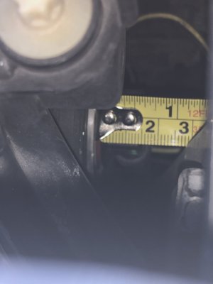

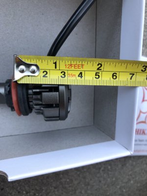

Ok update time. Ordered Hikari’s Eye of Voltron led bulb after some research. Had really good reviews and side-side comparisons. Unfortunately they don’t fit. There is a little less than 3cm of space from lip of bulb socket to the frame. These bulbs were a little OVER 3cm, so the headlight assembly wouldn’t slide back in far enough for the mounting screw holes to line up. Now I’m wondering if this is the case with most H11 led bulbs with the cooling fan. They all look about the same dimensions in the pictures.
8C8C328A-6765-408F-B44C-8AEF02670124.jpeg 75B93B8A-A8AB-424C-9E42-B4458C1AD733.jpeg

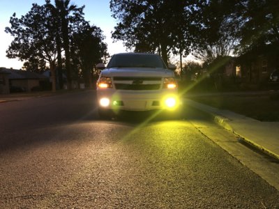

On a positive note I’m real happy with my new fog lights
Oem on the left, led on the right
