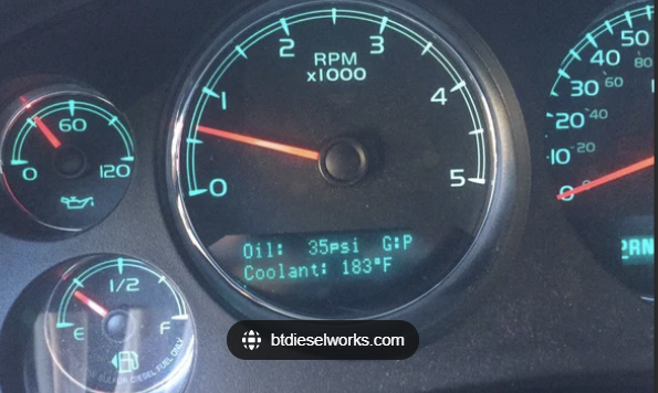

Can you expand on 'dash pixels'? I've never heard that phrase before.
I appreciate your mentioning the torque app, but someone else will have to lift that load. I was only asking you about what you were explaining.
If you have, or know of, a picture of the display, I'd like to see it. The seller didn't show one.

Here's a picture of 1 menu (Right press mirror d-pad)
It shows the gear (park), accurate engine coolant temp, and oil pressure.
Other useful features are express windows, remote windows, fob learn, TPMS programming, high idle, strobe lights, rear camera view, DTC reader!
